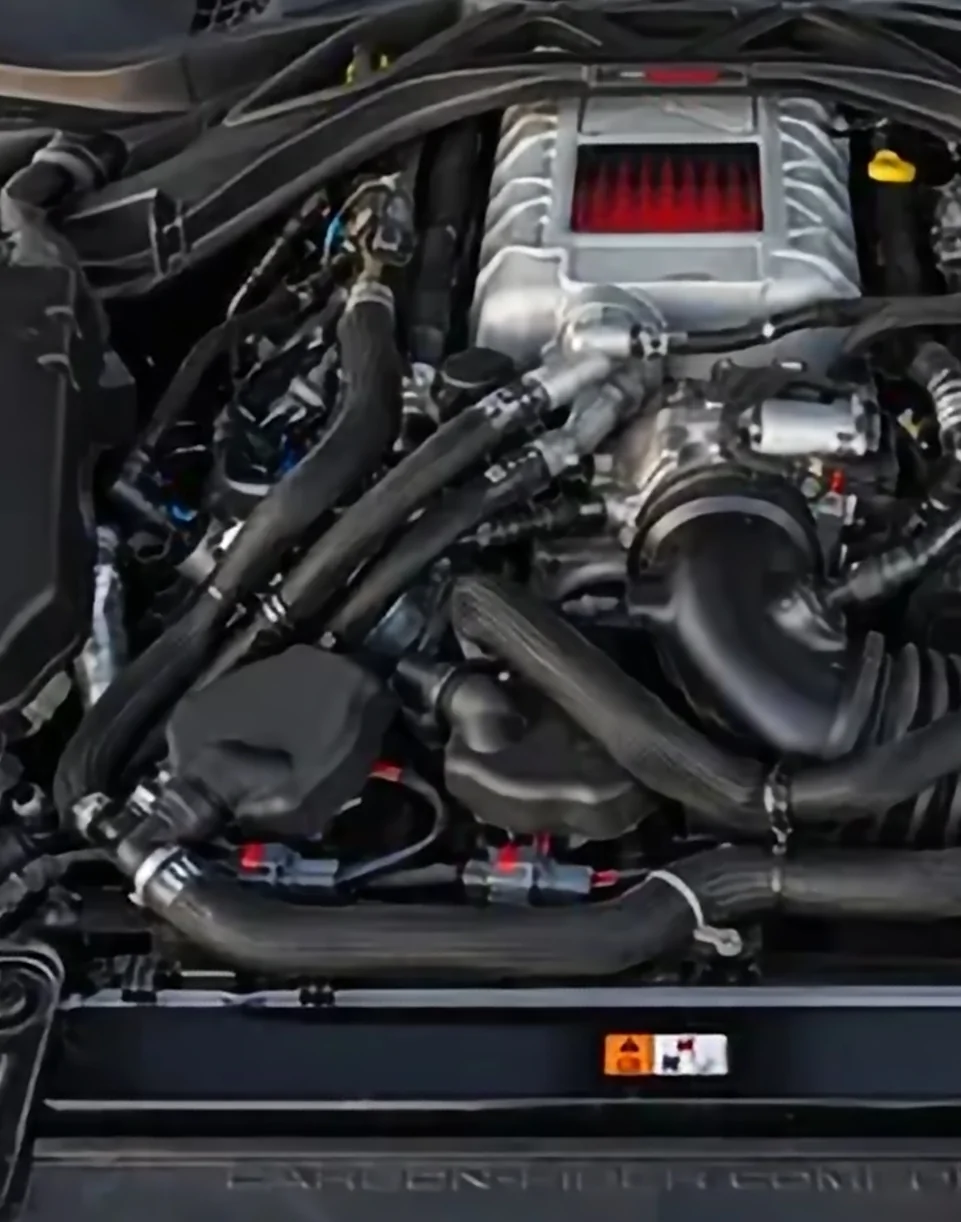

What are the two things in the front with hoses leading to them? Intercooler pumps?
Probably, the pre production car is not really refined, which is why there are very few pictures of the car with the hood open.
Zip ties and duct tape don't inspire confidence in their engineering dept
They are electric air pumps.
The '20-'22 GT500 didn't need them but more stringent emissions requirements led to their use on the GTD engine first. Lower left corner in the following photo of a GTD, they at least got plastic covers over them.
S650 Mustang 2026 Mustang Dark Horse SC - Official Specs, Photos, Videos 1000040422
They are used at start up to help the cats light off quickly. The exhaust manifolds, stainless "shorty" tubular headers to many of us, had to be revised as did the cylinder heads. Air is pumped to the manifolds, distributed to each port where it then enters the cylinder head. In essence, the cylinder heads for the GTD and the SC are "emissions heads" whereas the GT500 heads were not. There are other small engine changes, hopefully Ford engineers will get the opportunity to talk about them, such that the GTD/SC 5.2 engine deviates from that of the GT500.

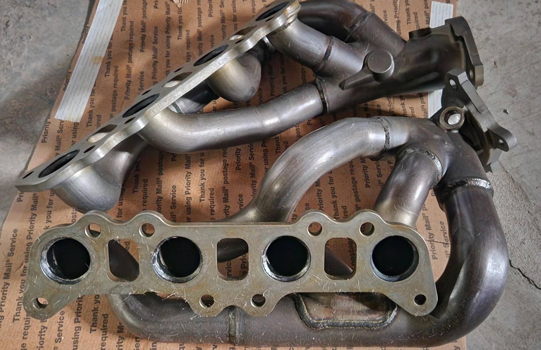

I wanted to add a little more context to the changes we see (or will see) on this engine versus the engine when it was in the GT500. Here's an extra set of GT500 exhaust manifolds I have. Very similar to what came on the GT350 as well. Note the flange, you see the exhaust ports along with the holes for the fasteners to pass through them.

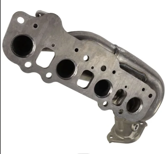

Now look at the manifold for the GTD which will mirror that of the Dark Horse SC. A much bigger flange with additional holes which allow for the air injection system to pump air into the cylinder head. Those new holes are directly above each exhaust port.

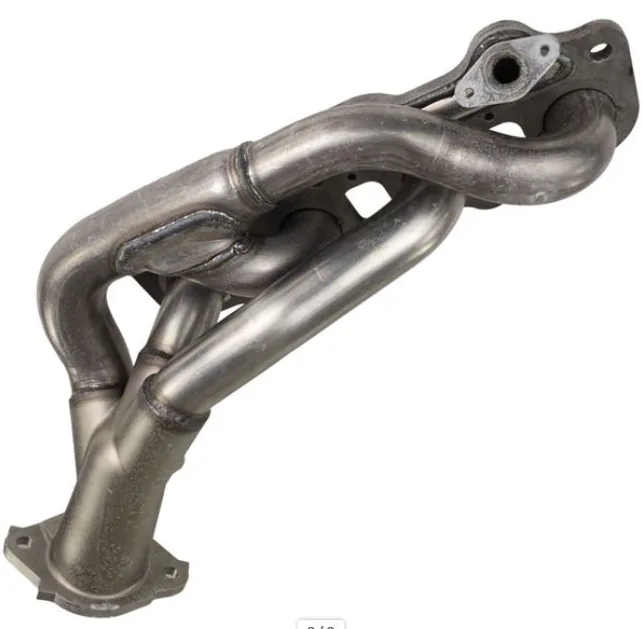

The connection to the manifold begins at a small flange at the leading end of the manifold which then further distributes the air as seen below in the upper right hand corner.

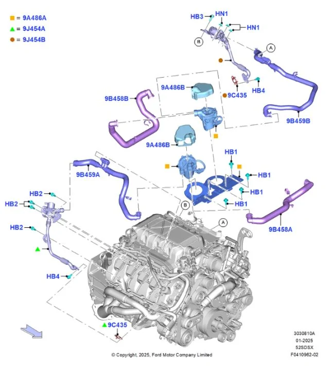

That is just at the manifold. The entire support system of hardware becomes a bit more complex and convoluted. And expensive.
S650 Mustang 2026 Mustang Dark Horse SC - Official Specs, Photos, Videos GTD Air Pump hardwar
The above hardware takes up space and adds cost for very little "green" benefit. I was hoping that with numerous changes at the EPA that this system would no longer be necessary but so far that isn't the case. Note that the SC engine has yet to receive an EPA Certificate of Conformity either.
