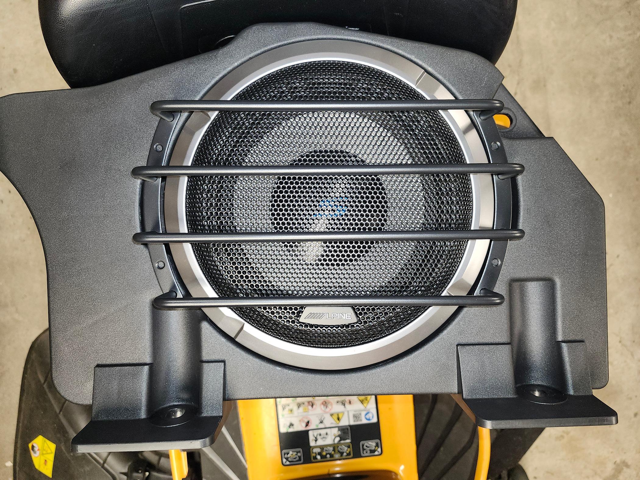

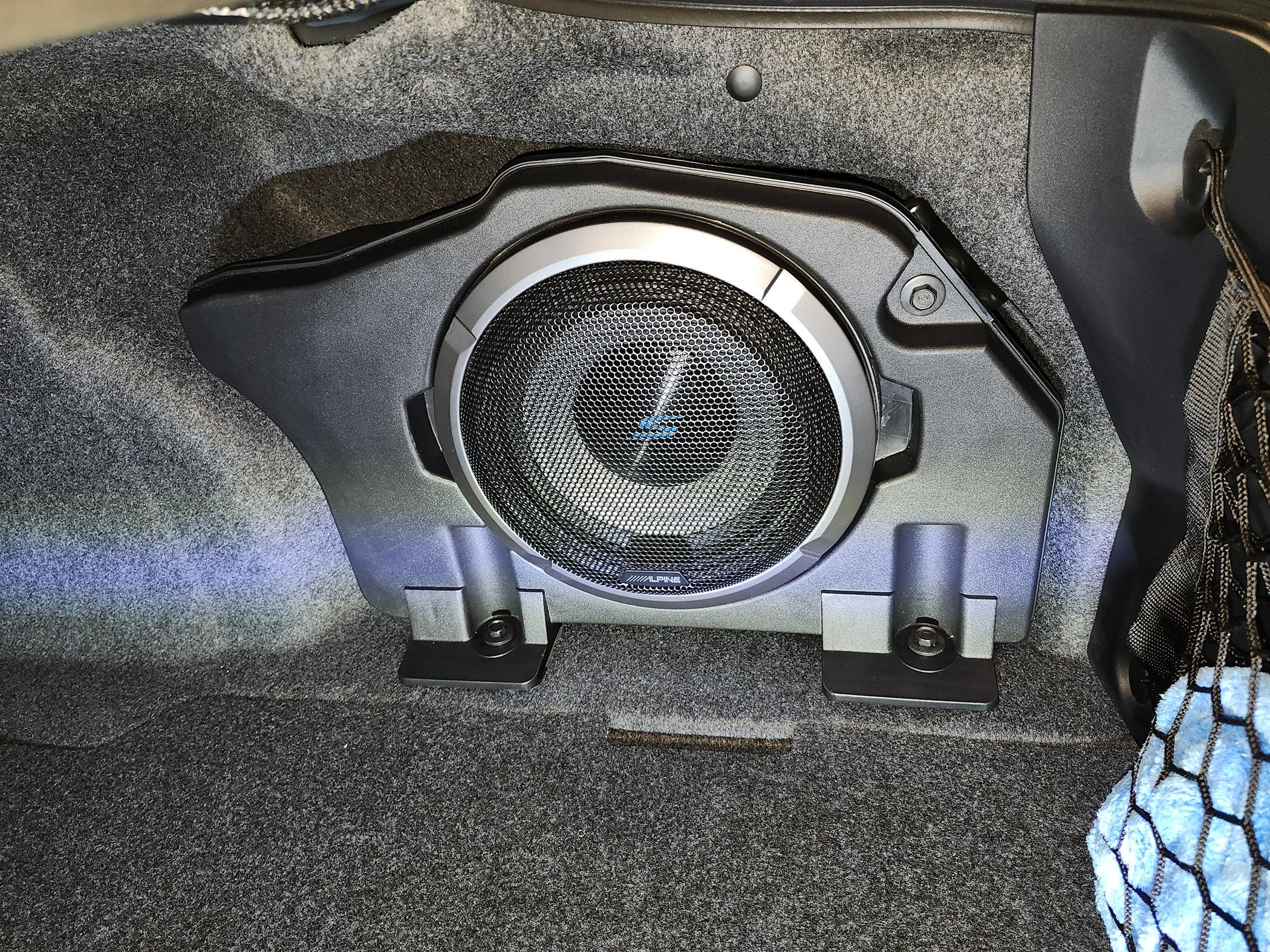

Some people who want body shaking base may want to go with the Harmonix sub since it has a higher sensitivity 86, but you'll have to use speaker bars/won't look OEM.
I don't know about "body shaking" (that would require an additional amplifier) ... though 86db sensitivity will give a bit more.
The bar style grill isn't necessarily the only option; you could use a grill made to fit whatever speaker you choose.
This one (Alpine, 85db) required a spacer ring glued in behind to bring the speaker out enough to get the grill on easily. The spacer ring also gives extra thickness for new (8) holes to mount the speaker. This does require more work as the spacer needs some "machine work" to fit over the bumps on the enclosure. Though it also opens up the use of virtually any 10" sub... giving a bit more depth.
S650 Mustang Low cost Center Dash and Sub Woofer speaker upgrades = best $110 you'll spend on your Stang 557615-16669de1d0e954e01cb0a9fb56270e75
and the bars still work if you feel the added protection is needed (I didn't).
