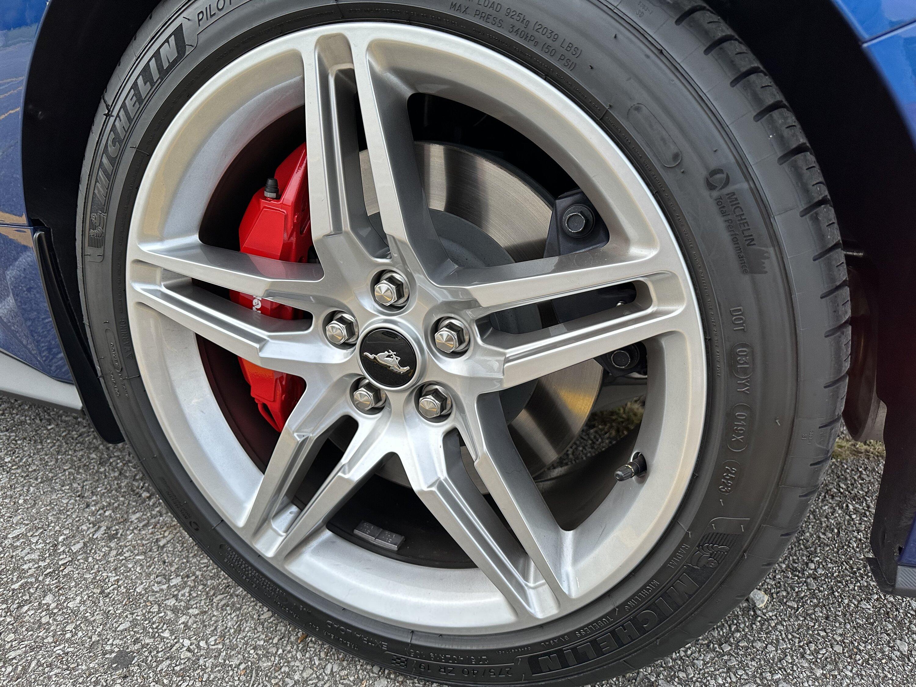

Looking for some tips on winter wheel setups that will clear the brembos!
I found a used set of s550 performance pack wheels and mounted Michelin Pilot All Season 4 tires. I don’t really get much snow accumulation where I live.
