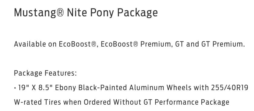

Can anyone give me some good examples of winter tires for a base GT with nite pony?
Im not real familiar with the sizes/what will fit etc so please provide ones you know would fit on the 19 nite pony wheels

Thank you! And those can just fit straight on the stock 19 wheels with no issues?
Yes if you do not have the Performance Package. If you do then you need to go with 275’s in the back. Use the tire rack search function to show you models and pricing.

There is only one choice for the PP staggered setup but you can still put the 255’s on the rear if you want.
