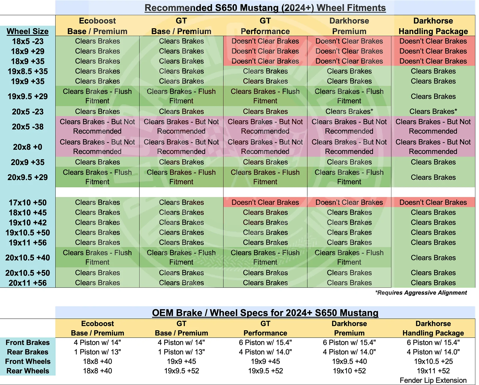

The attached might be of help.
S650 Mustang Will Dark Horse 19X9.5 wheels fit s650 base GT in square setup? 7G wheel offset
