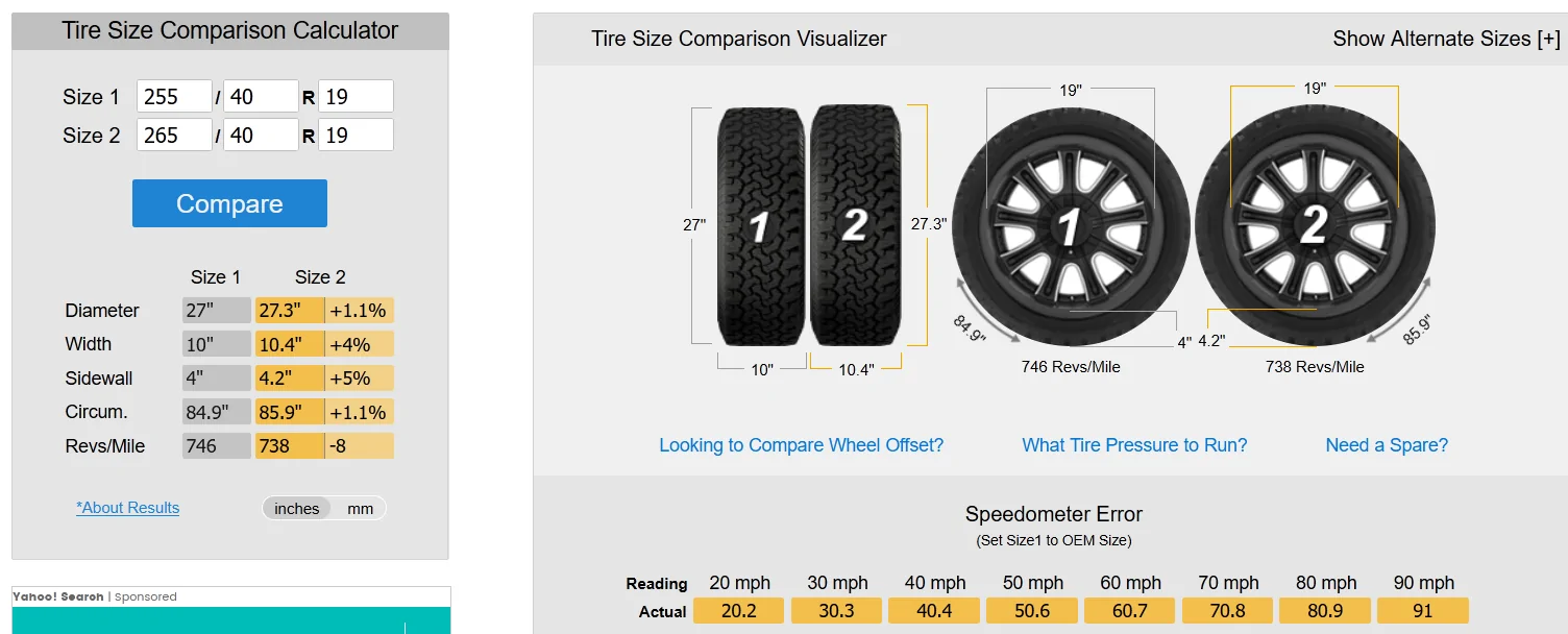

I do appreciate your offer but was looking at the battleship grey color wheels, still haven't pulled the trigger just waiting on a sale to happen. And the most important part what size tires to fit on these wheels, when I have the performance package. 255/275 is standard and was thinking of 265/285 since the wheels are wider and not sure of how much space I got in the wheel well to play with.

Not sure if you know this website, but this one is great: https://tiresize.com/comparison/
For example, going from 255/40 to 265/40 increases the diameter by 0.3". More than fine. The rule of thumb is to keep the diameter increase below 3% (1.1% in this example):
S650 Mustang 2024 Mustang Gt with PP will it fit Dark Horse non PP wheels? 1773861912732-9u
275 to 285 is the same 1.1% number. Fine.
