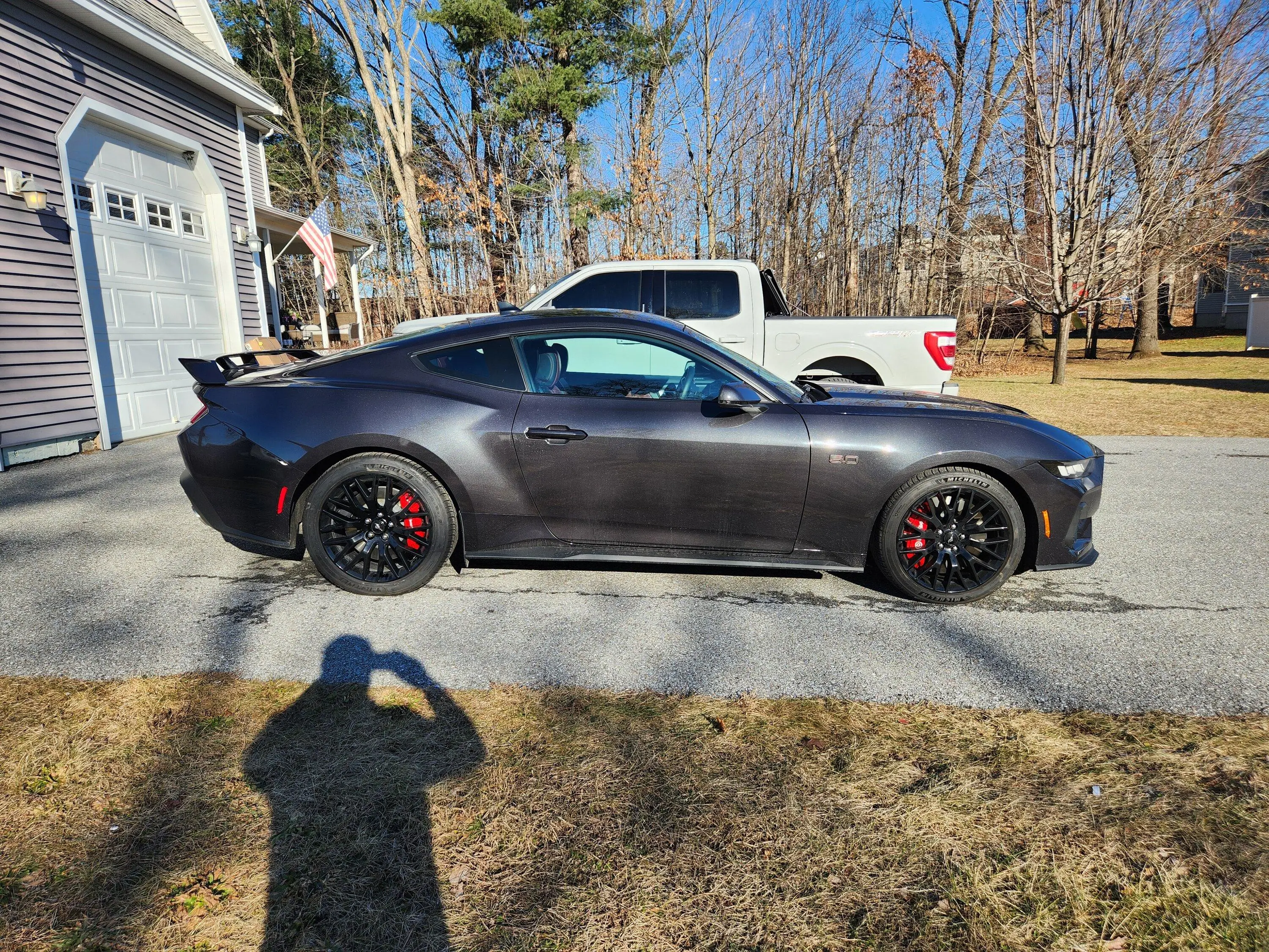

I currently have AS on my S550 PP1 mustang, I don't want to drive my S650 with the Pirreli summer tires on, the tire sizes are the same 19" 255/275 40's I would like to swap them today to go for a ride. It look like the only conflict would be the rear Brembo caliper.

they should fit, 19s are the minimum wheel size for the Brembo's

I put my 2019 winter wheels and tires on my 2024 with no problem (other than the slightly smaller 255-40x19 instead of 274-40x19 on the rear). Wheels fit no problem, but the TPMS sensors are different for the 2024 so either you have to replace them with new or just ignore the light for the next several months.

They fit, now yo go for a drive while the mount my PS4 ASs. :thumbsup::sunglasses:
