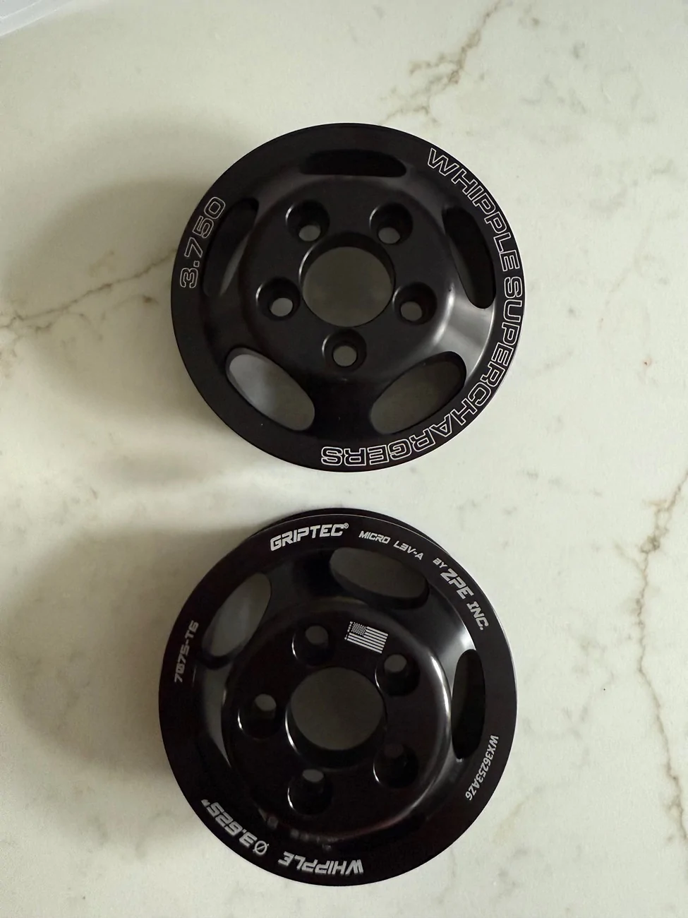

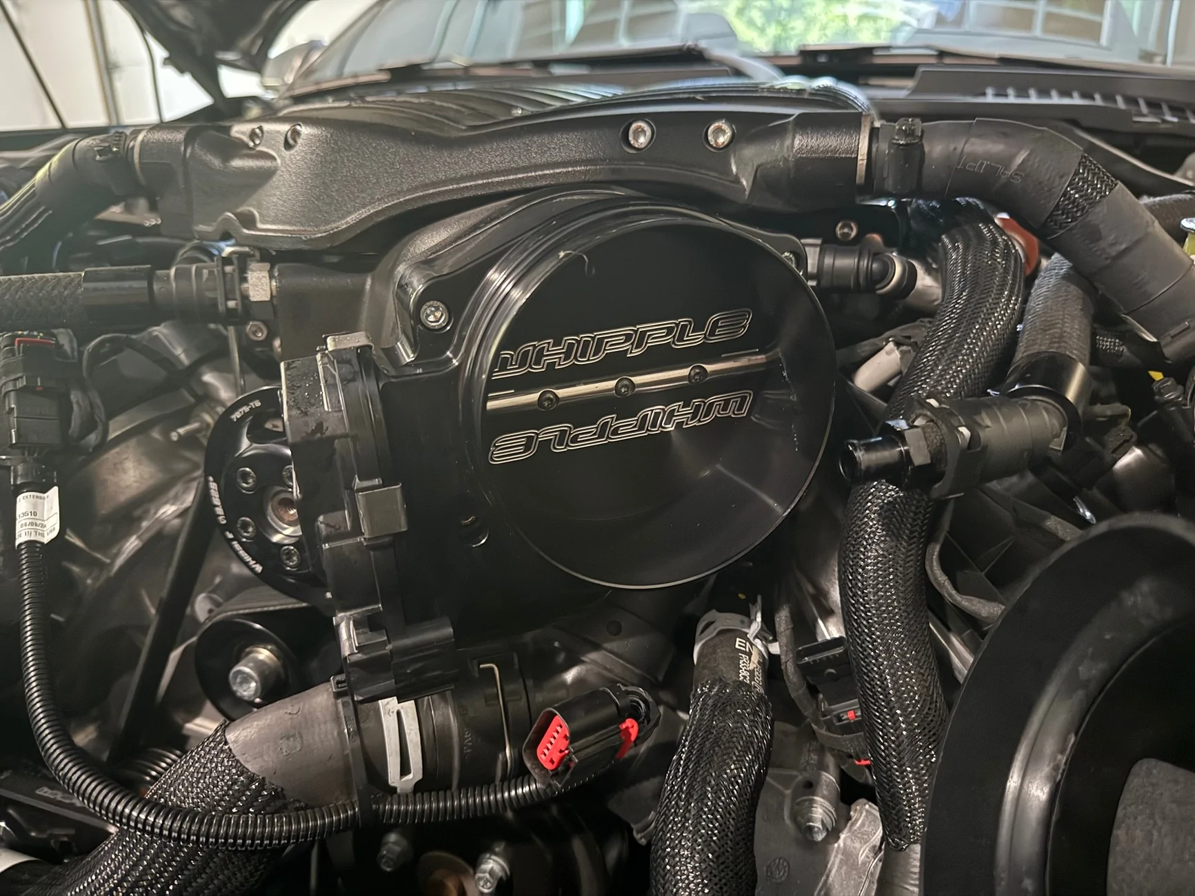

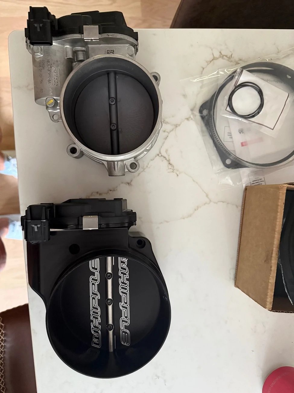

I am super curious what you get out of that. I assume on 93?
Installed the 112mm TB w/intake boot, 3.625” pulley, and the canned Whipple Stage 2 tune last weekend. Sticking with 93 octane only. Need to find some time to get on a dyno. First impression; rowdier and boost comes on sooner in RPM range.
In your opinion is the 3.625" pulley safe for 93 octane?

No, go BAP/E30 or something to get more octane.
120 may need a tune update… call VMP, Justin should have the answer

I don’t pretend to be an expert with any of this, was told as long as I had a fuel pump voltage booster I’d be on inside edge of safe with 3.625”. I’ll ultimately swap in the 3.750” that came with Stage 2 stuff. Just wanted to try it out for fun. Where I live ethanol fuel isn’t that common around my parts.

Of the throttle body or something else (like the engine)?
The 112mm is more reliable?
the throttle body there are some bad ones where it catches on it self with differential heat expansion causes a code and limp mode
last gen alot of issues with aftermarket throttle bodys not just the one
they may have fixed it in the new generation but i got the gt500 throttle body to avoid it
