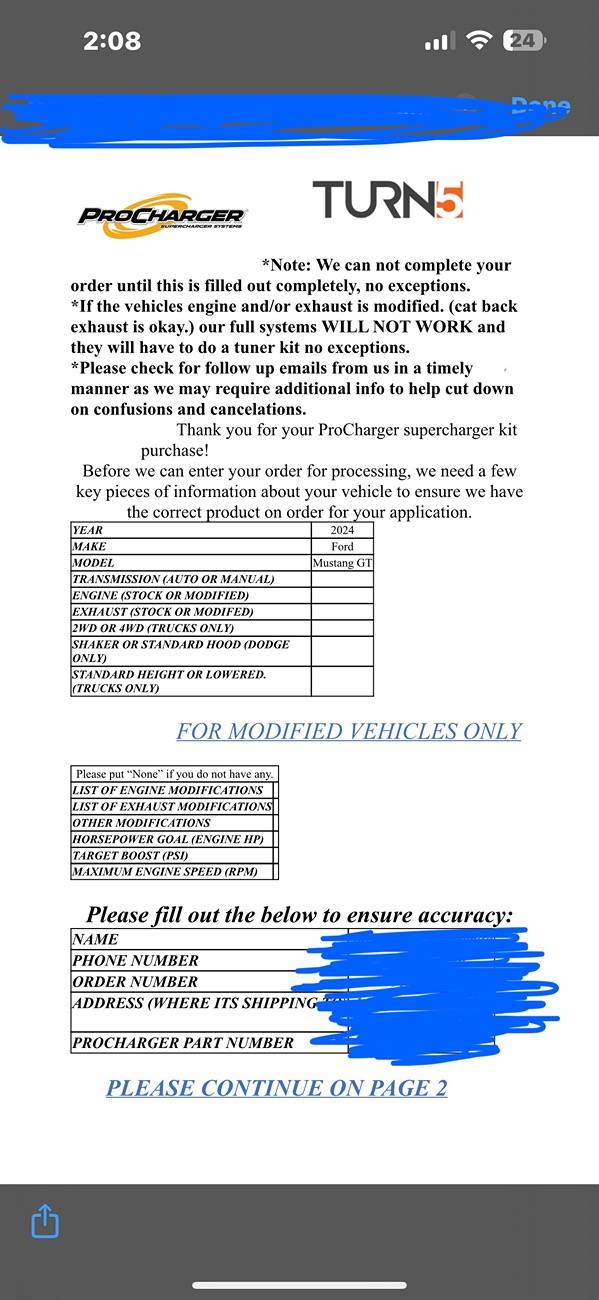

So after going ahead and buy the pro charger…. I get a form from American muscle to send to procharger and the top of the form says exhaust modifications will not work and will need a tune no exception so not I’m confused….. should I return? Or keep it and hope for a tune?

We asked for a procharger tech to look at this form to see but we haven’t got anything in a few days, lots of people and a few mechanics down here said it should be fine but it’s the should be fine that scares me a lil haha. Imma fill the form out and out I have long tubes and there catless and the double h pipe and that’s it lol and see what they say

all manufacturers pretty much say that the "complete" kits are designed for "stock cars", that implies headers.
a coyote has built in widebands, and does not required tuning for headers.
we have probalby hundreds of customers on "complete" kits from whipple, procharger, vortech, paxton, roush, vmp, etc.. with headers on them, ranging from high flow catted, to gesi / eco / green catted to compeition only.
you may get a "check engine light" from the headers in any form, but that is not something that has to do with the tune, most people just add a set of defoulers for the check engine light.
most of the tuning can compensate up to 30% of fueling. our 2022 f150 for example we originally had lth gesi catted then went to competition only, between the tune, the new headers ,then the comp headers, not one thing was changed.
our 2024 mustang, same thing, it even crosses platforms, our 2023 challenger, same thing, added headers, 0 adjustment for tune.
so, if your doing a supercharger on the "oe tune" from the mfg, simply list exhaust as stock. No matter if whipple , procharger, or anyone else that comes out with a kit before custom tuning is available
