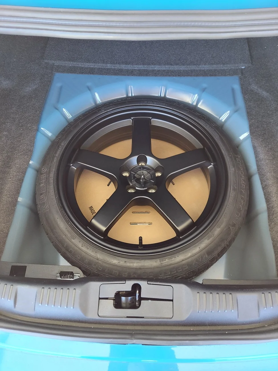

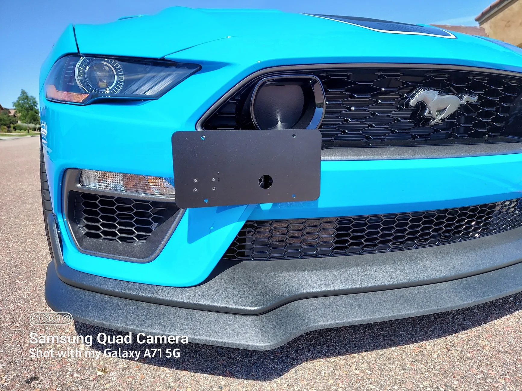

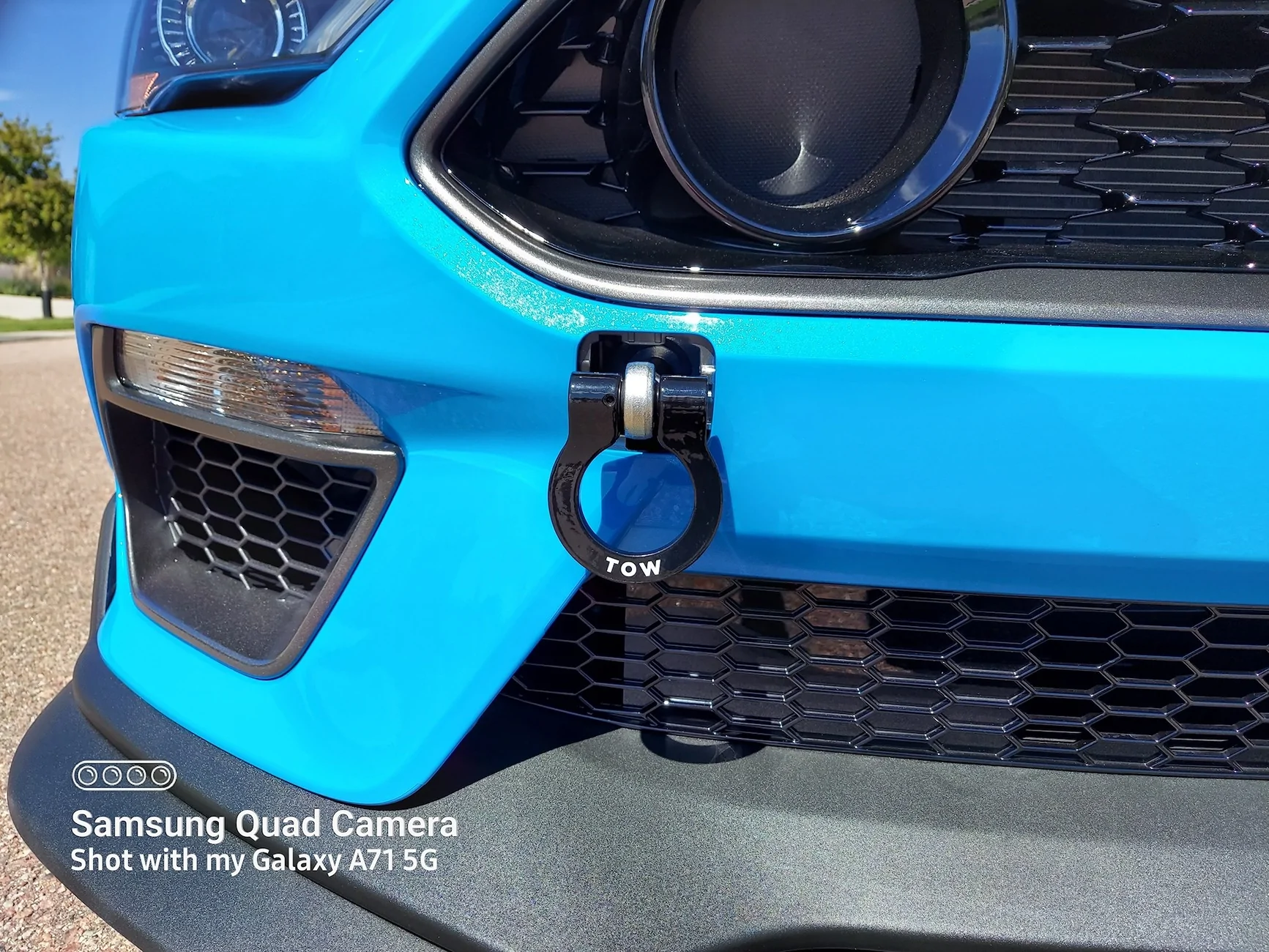

For a front tow hook, I installed one from ZL1 Add Ons. In the receiver, I used a rod they sell that screws right in. With that, I can place either a 1) front tow hook or 2) license plate bracket.
https://zl1addons.com
For a spare, I'm using one from Automotive Authority. It's a space saver which tucks under the existing facade. Those taking long-distance trips might want to stow a full-size spare.
https://www.automotiveauthorityllc.com
Edit,
Some tracks require front or both front and rear hooks or straps. It depends. Check with the track or the organization while shopping as to what their requirements are.

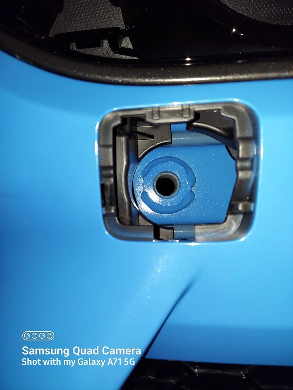

Would you please do a simple, step by step,"For Dummies"© explanation of installing that tow hook?

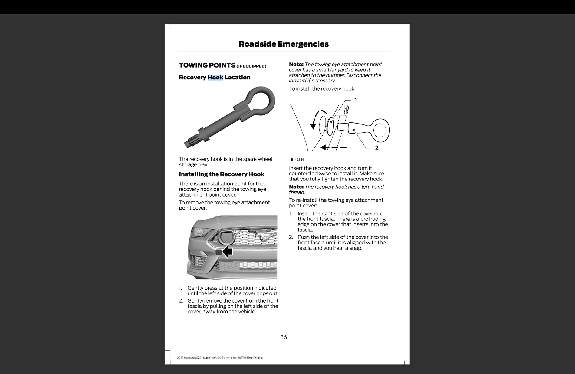

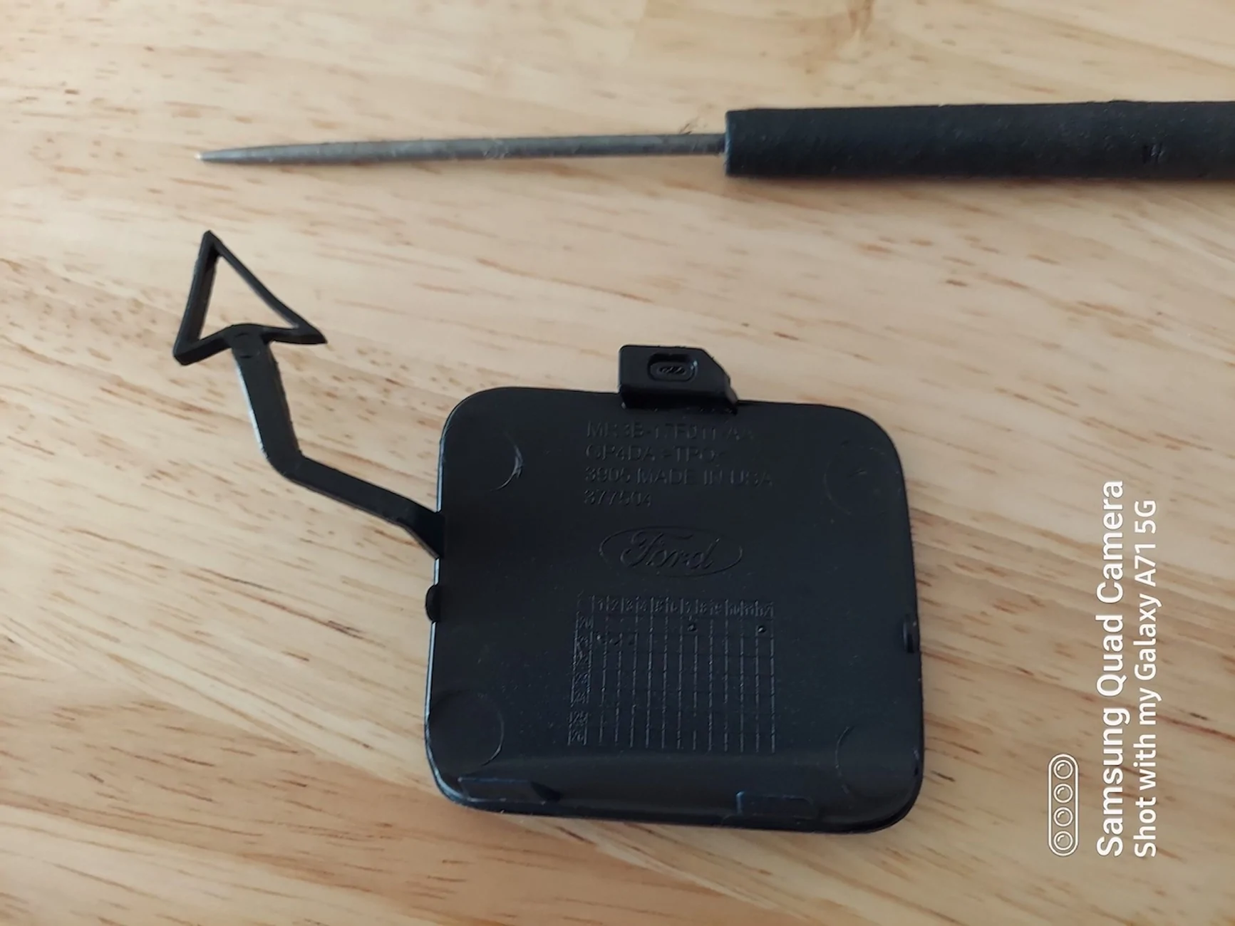

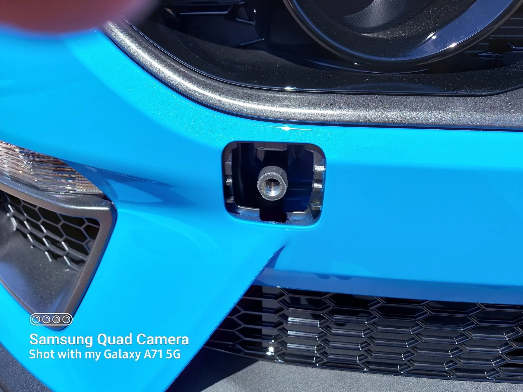

Attached are some additional photos. It's real simple.
1. Pop the cover on the front bumper. Press on one side, lift on the other. With a small pick, you can then apply pressure to the cover lanyard and remove that.
2. ZL1 sells a reverse-threaded rod that screws into the receiver. Screw in. Tighten.
3. With the rod in-place, now you can either screw on hook end or license plate bracket they sell.
I haven't studied other companies, but I'm sure they offer similar setups. Hooks can be had in several colors, or primed, so the owner can powder-coat in a color of their choosing.
Edit,
At that time, the rod, hook end and license bracket were listed as GT350 pieces. Same underlying car, so they went in without changing anything. Looks like they have some listed for the 7G now.
https://zl1addons.com/collections/ford-mustang-tow-hooks?page=2
Doing some quick checks on that page, they have GT and DH-specific hooks, as mentioned in their descriptions.
