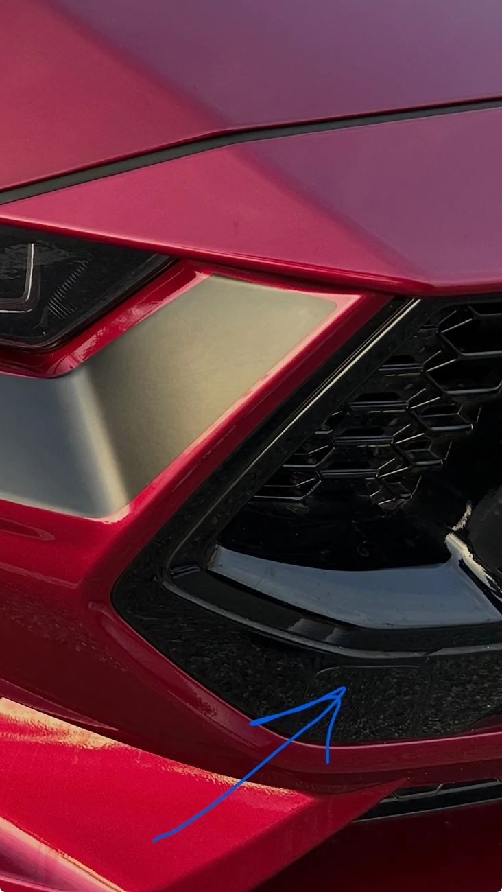

I have a 2025 Mustang GT base model, I’m trying to install a tow hook, but the location I’m pointing at in the photo (the plastic cover piece) is not coming off, i tried pressing it but nothing. Anyone knows if I can install it on the base model or not? If yes, how to remove this plastic piece?

You have to wedge it out with a plastic pry tool. Planning on going to the track?

@Jirees98 ..... that piece should come out but there may not be a receptacle for a tow hook on the inside bumper. It may require the installation of a receptacle. I was told by my Ford dealer that the metal plate and receptacle was only installed on Mustangs that had the PP (performance package) installed on them at order time. I know my 2024 Mustang GT Premium Convertible had the access "door" in the bumper but there was nothing on the inside frame to screw a tow hook into. Maybe yours does?

@Jirees98,
To remove the cover, put your pry tool in the 3:00 position. Push gently and pop the cover out of place. I used a tiny screwdriver with some blue tape on it to protect the paint. It requires very little force and will come right out. There's a small retention clip located at approximately the 10:00 position. I used the same little screwdriver to release the retention clip to take it off. I have a front plate relocator installed in mine since California requires a front plate. Many people who show their cars actually drill the cover so that they can have it installed with the tow hook or plate relocator installed.
