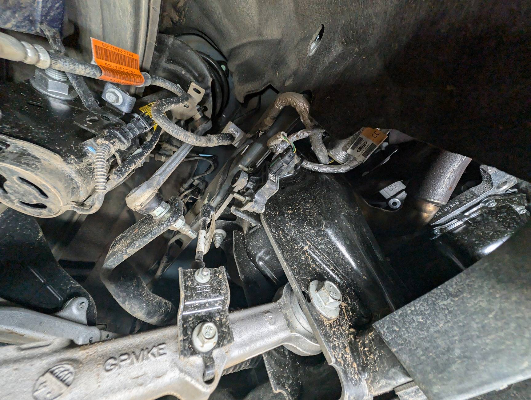

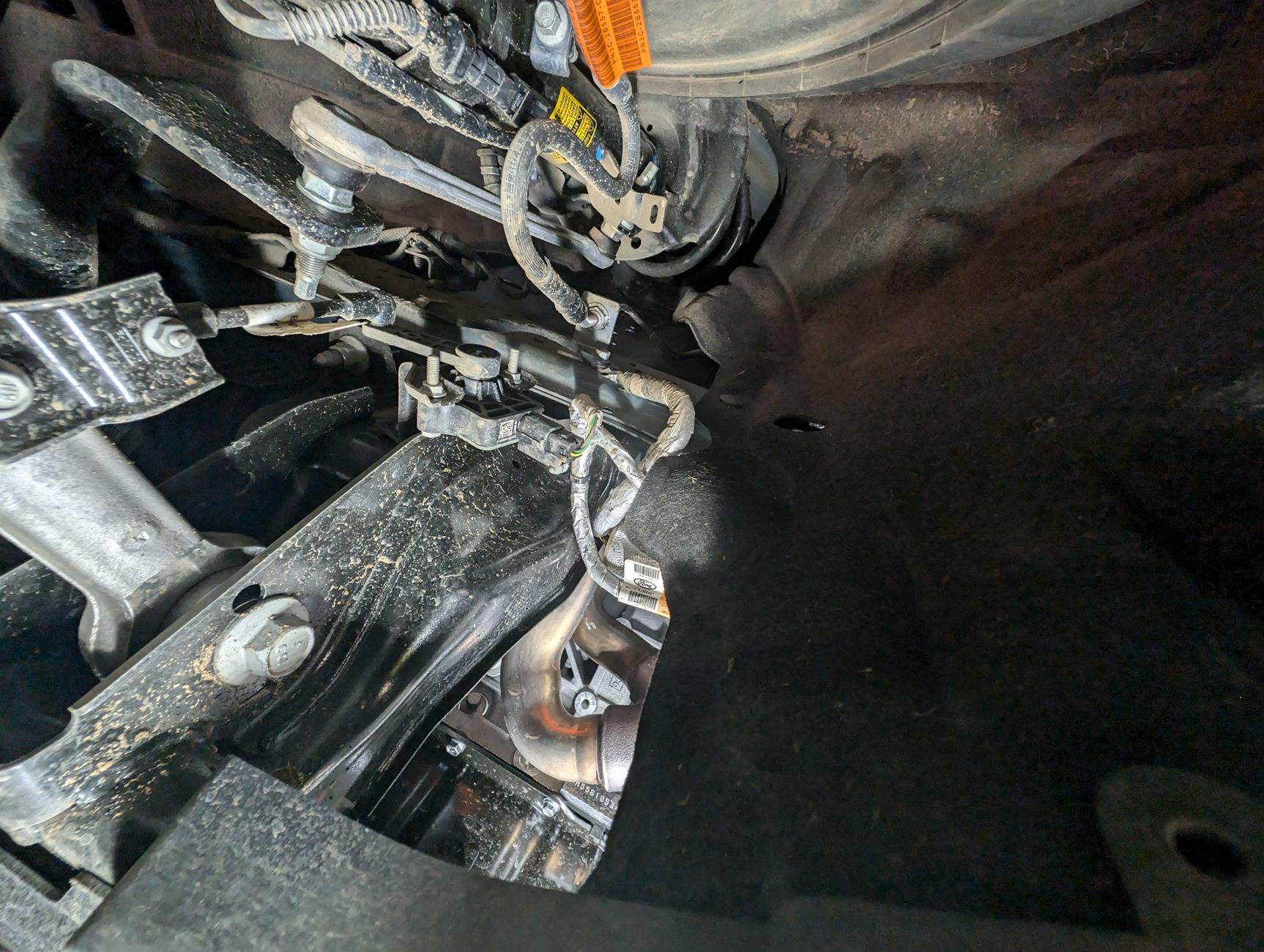

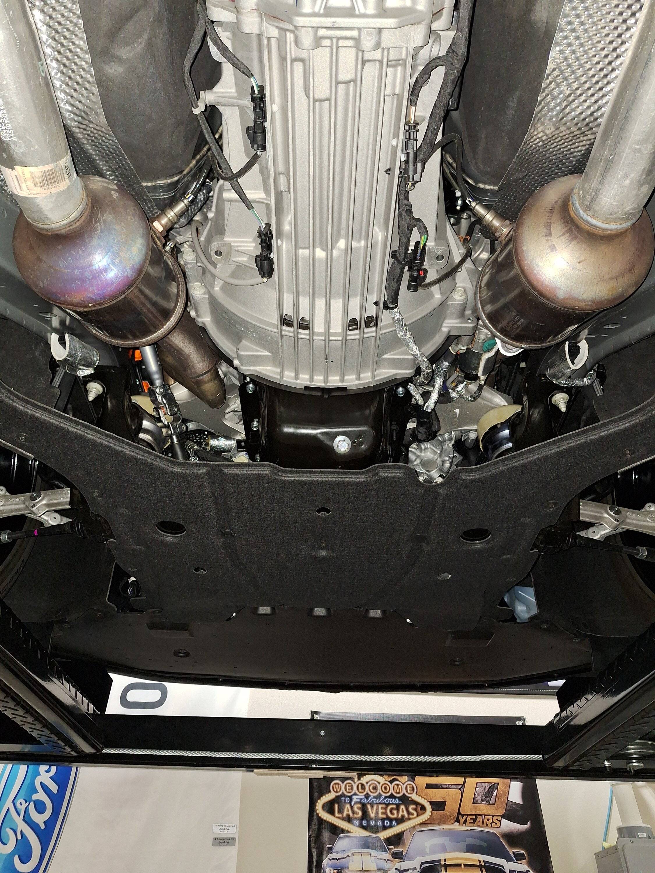

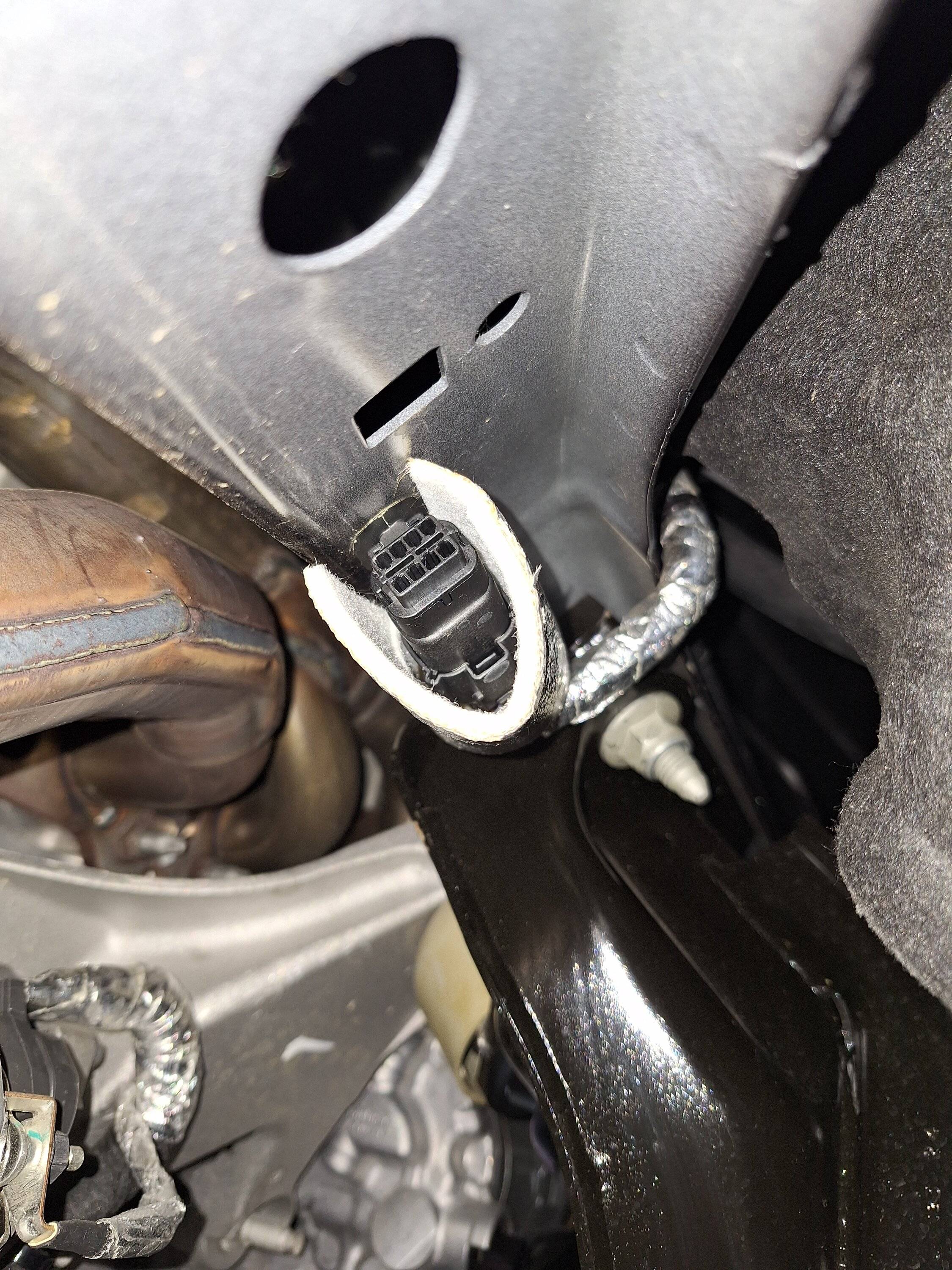

It is connected on my euro car, to a ride height sensor and the magneride damper loom. It's probably related to the pothole mitigation feature, as a sudden increase in ride height on one corner will trigger the mitigation.
I have attached pics of the connector, with the wires going forward into the wheel well and the sensor in the well.

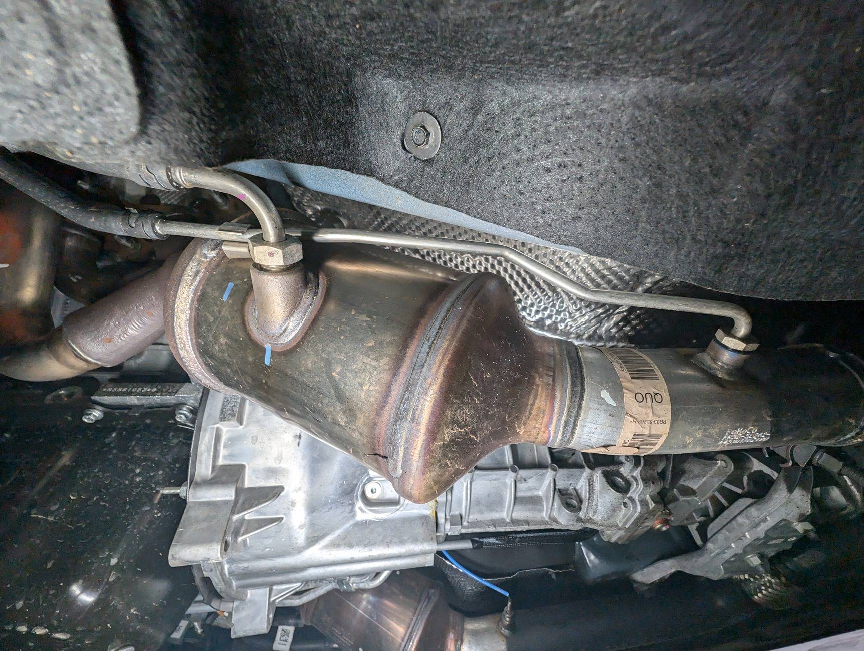

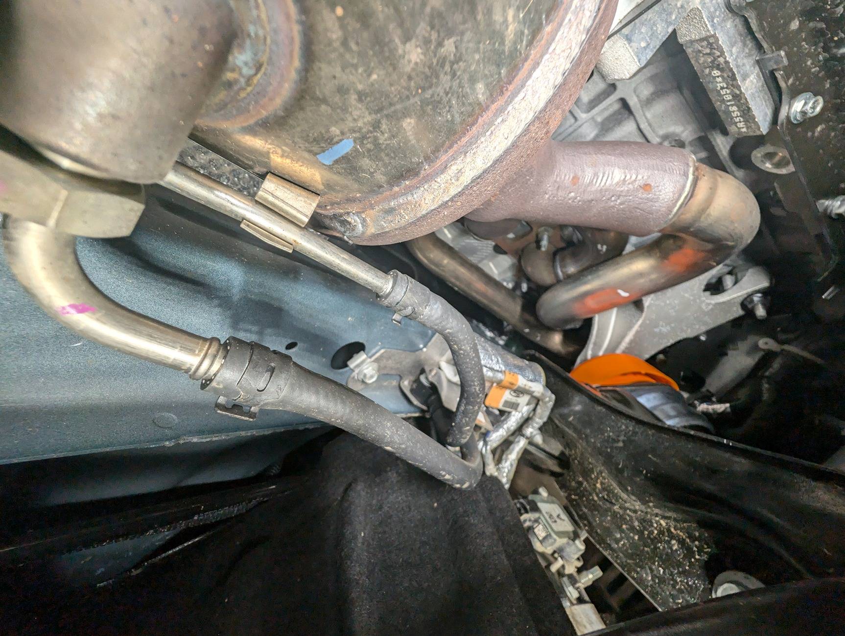

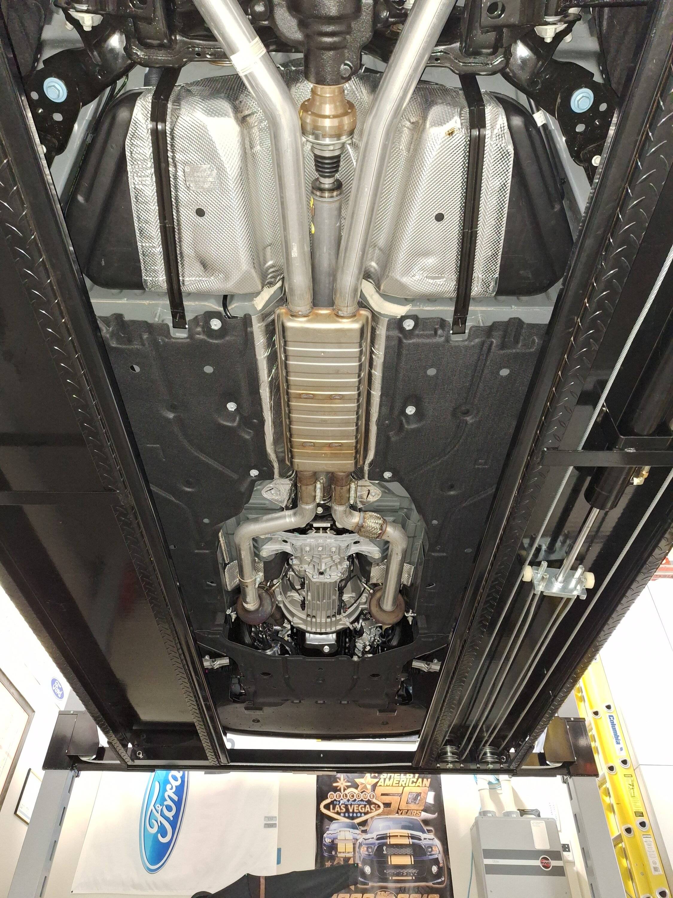

I have also attached a pic of the combined particulate filter and cat (which is tiny ...) they have pipes attached to them which route to that same connector location.
I was lifting the car via the spare scissor jack so wasn't going to ferret around under there too much.

So the 2 connectors are for the Magna Ride option from what you have discovered. Thanks for the research you have done. Appreciated.
