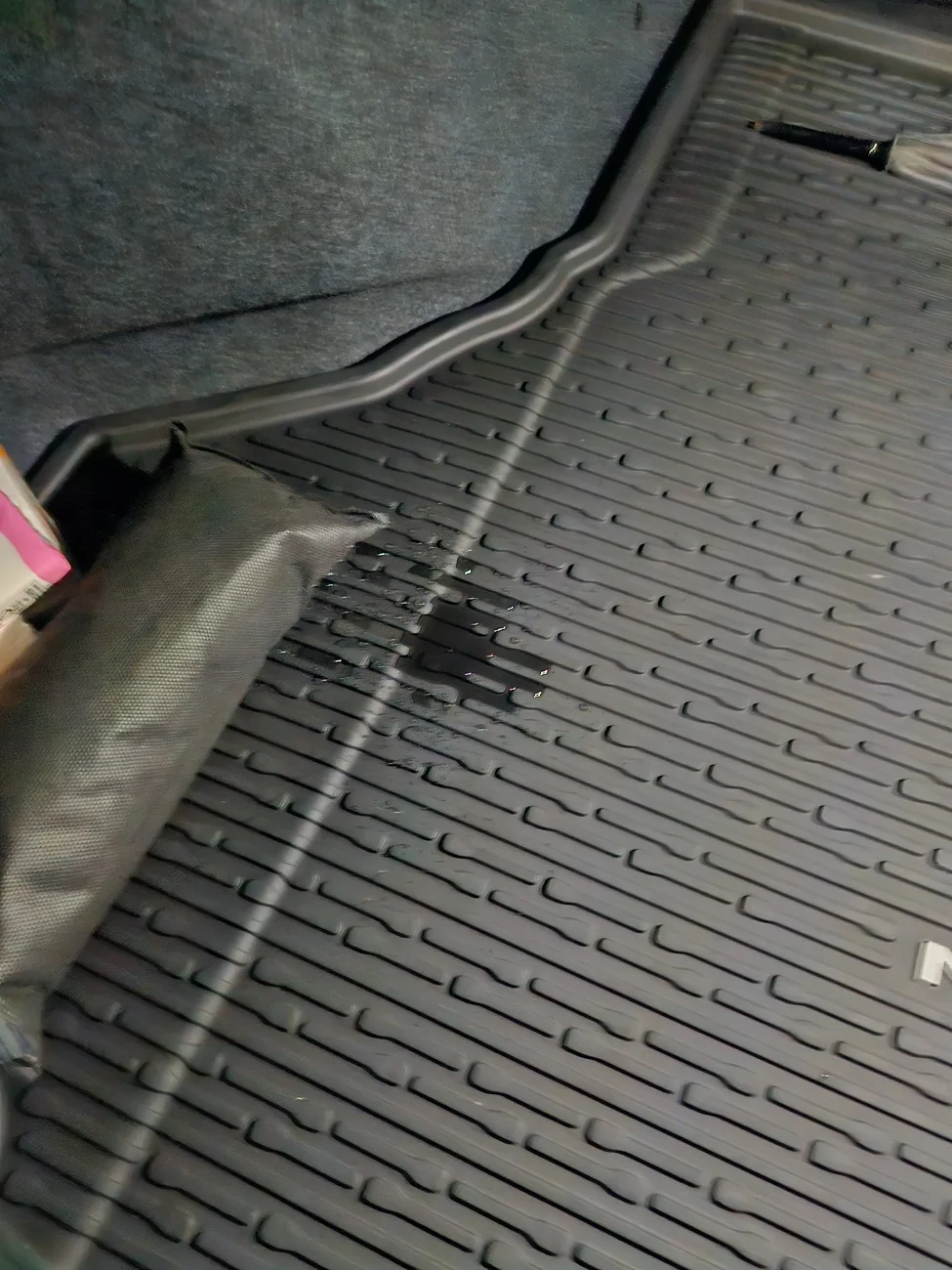

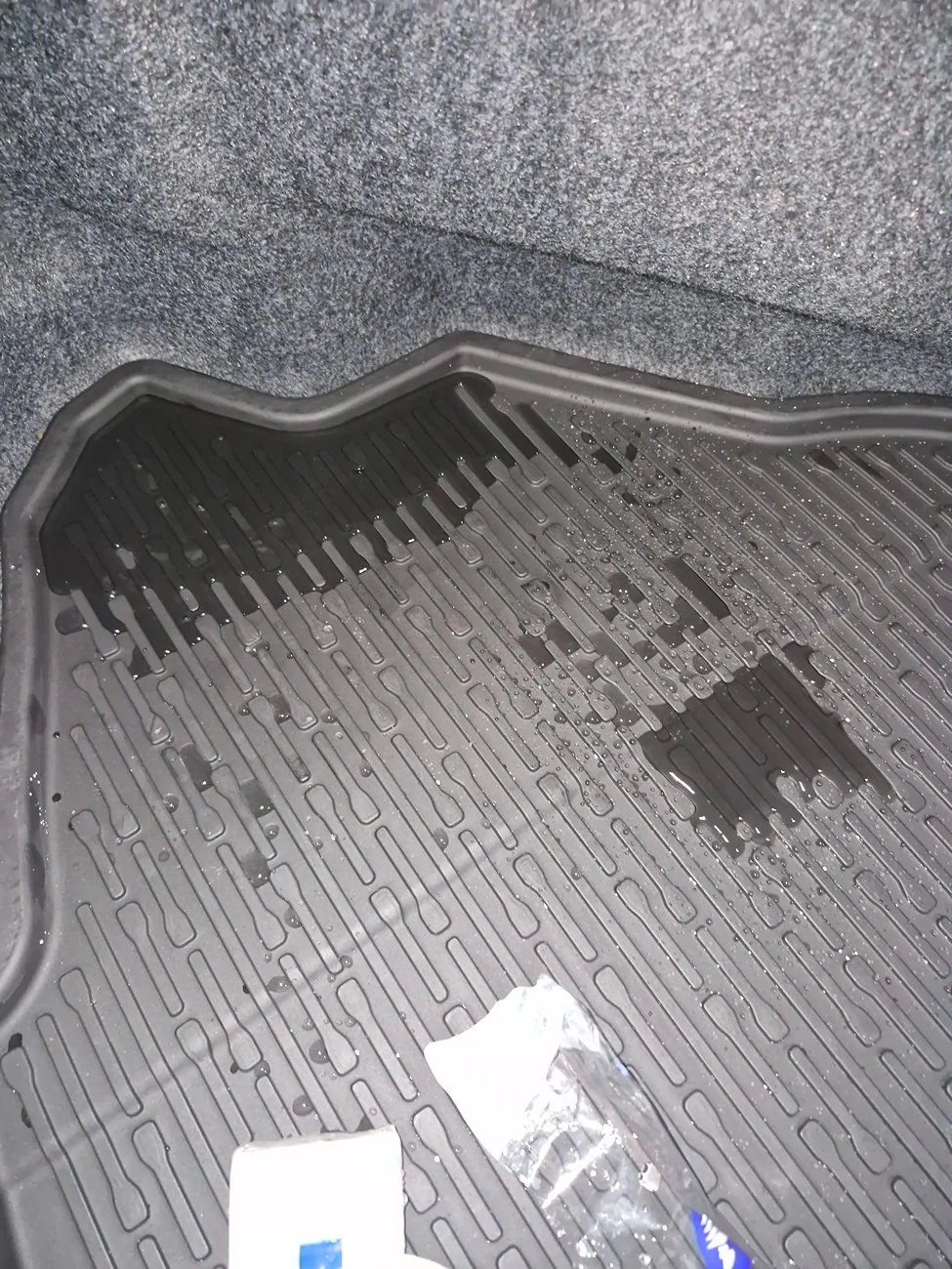

I own a 2024 Mustang with the Performance Package, and I’m experiencing water leaking into the trunk through the bodywork. Whenever it rains, water comes in at exactly the same spot.
My Mustang has already been at Ford twice, five days each time, to fix the problem. Unfortunately, it still leaks whenever it rains. They have already removed the entire rear end to find the issue and replaced all the seals, but without success.
The only things that have not yet been tried are removing and inspecting the rear window, as well as the third brake light.
Has anyone experienced similar issues with their vehicle and/or had the problem successfully fixed by Ford? Both times, Ford was absolutely certain the issue had been resolved — unfortunately, without success.
Thank you in advance for your help.

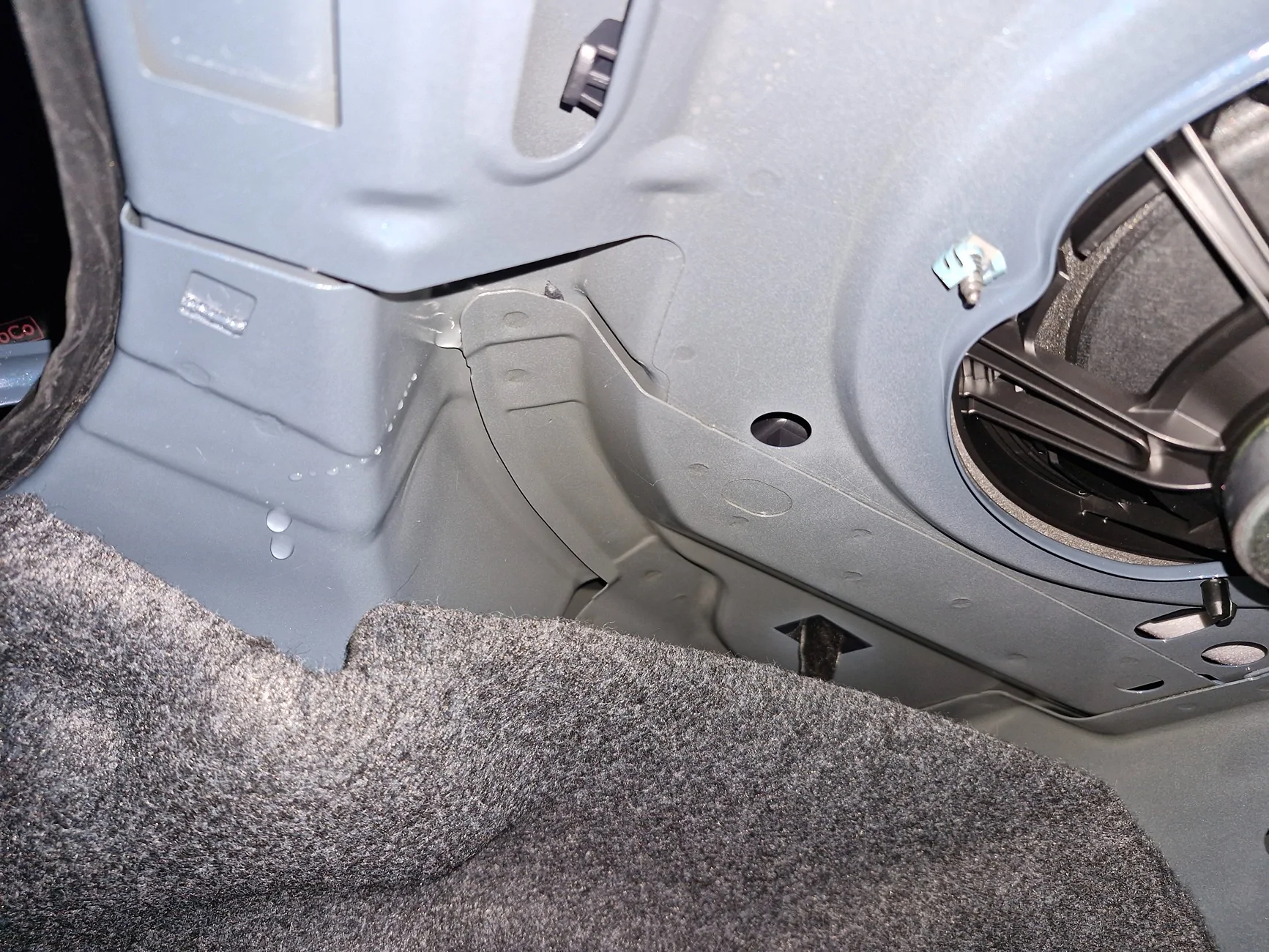

It all started in autumn going into winter 2025, when I noticed while loading and unloading that the carpet in the trunk felt slightly damp. At first I dismissed it as possible condensation and didn’t think much more about it. I also put a temporary rubber mat in the trunk.
Then in January, after a winter night with snow and rain, came the surprise: a small puddle in the trunk, with water droplets forming on the upper side of the body.

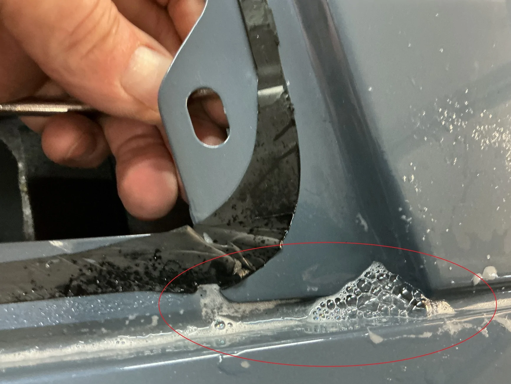

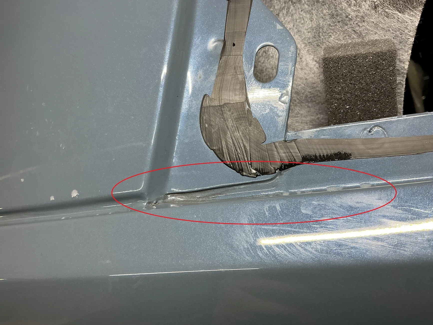

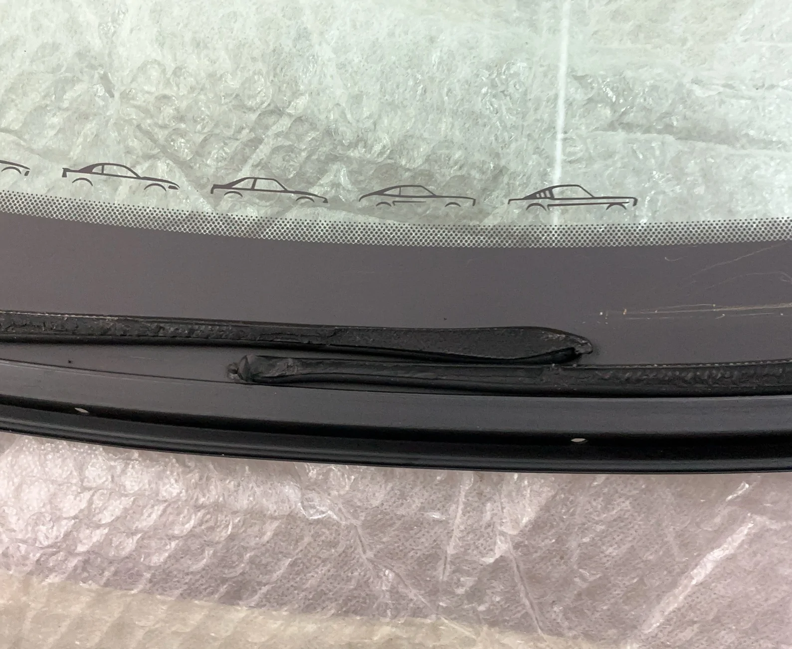

The rear window was removed. The bonding flange of the window at the lower center was not properly aligned, which was the first possible point of water entry. The second—and confirmed—source of water ingress were the transitions of the roof channel on the left and right, both at the top and bottom. Extremely fine hairline cracks were found there. Only after very long exposure to water could a kind of capillary effect occur, allowing a small amount of water to seep in and run downward.
From the inside, they sprayed a foam-like water mixture until foam appeared at the leaking points.
All affected areas were reworked, then sent to the paint shop, and the rear window was properly reinstalled and sealed.
