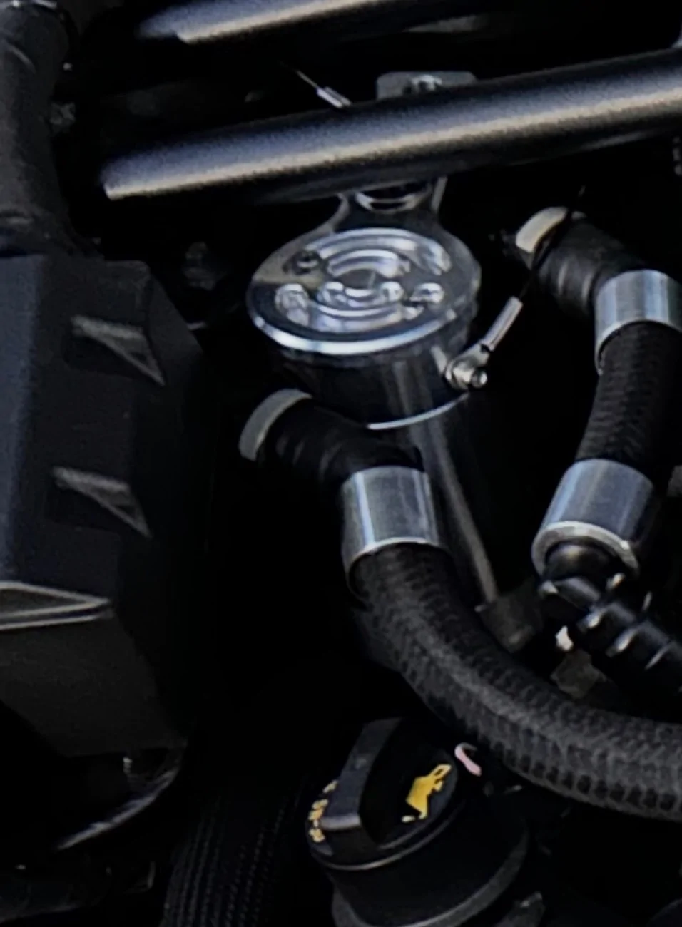

I had a question in regards to if the elbow on the catch can will damage this connector? I tried adjusting the catch can but it’s the best spot I can get it in. Should I put more heat tape on there? Thanks in advance!

That is a trip. I had the same concern when I installed mine. Don't worry you should be able to move it around a bit and get it where you want. I had to bend my AC line just a bit to get mine in the best position possible. Loosen things up a bit then move around till you get it where you want then tighten.

Mine is just like a millimeter away but its fine and doesn't rub. I had same concerns about it rubbing and messing up the connector.

Thanks for verifying, I’m going to put more heat tape there to be safe.

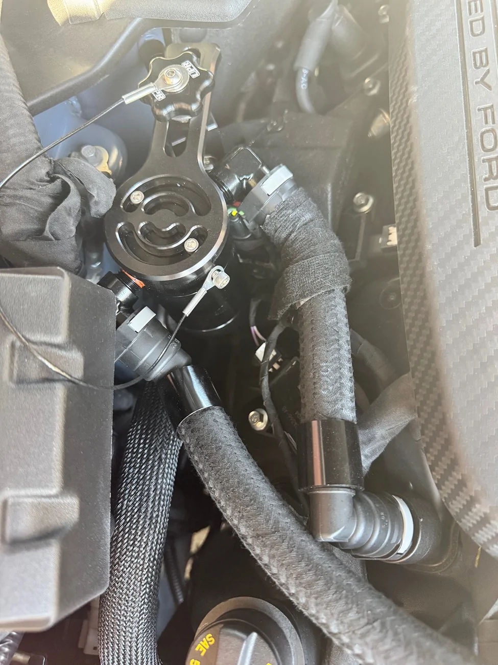

I had the same issue, but I also don’t think that’s a big deal.
What did bother me is the short hose from the can to pcv had to be very aggressively bent at the connnector to make it fit. Engines shakes as part of their normal operation, and I didn’t see enough slack to accommodate that since the catchcan is fixed in place. If the pcv connector gets damaged, replacing that requires valve cover removal (unlike gen3 coyotes which was much easier to replace). In the end, I took the UPR can off. I’m gonna put it on Facebook marketplace for like $100 to recoup my losses.

Mine has about .5 to 1 cm clearance from touching anything. Took me a little bit after first installing it and adjusting it to get it that way. Now when dumping the oil, takes a couple of minutes and it’s back in place.
I’ve had it on the car for about 15k miles with no issue.

Keep in mind that they could have shipped hoses of incorrect length. The can for my ecoboost came with a hose that seemed too short... pulled tight, no slack, had to clock the can way more than their photos showed. I contacted them, the hose was indeed too short, they sent a longer one right away. Moral of the story, if the fit doesn't look right, contact the mfg.

I did, sent them a picture with the hose kinked more than what I consider to be reasonable. They said that’s pretty much what it is given the tight space.
Some may accept it, some may never have an issue, but I just didn’t feel comfortable with it myself.

Why do you think if the pcv needs to be replaced you need to take off the valve cover? How did you come by this? Just curious?

I just asked ChatGPT what the procedure is for Gen4 coyote pcv valve replacement. Said gen3 it was just a turnknob-like installation, gen4 has a platic piece that prevents that turn. Says some just break that black piece off and live with it, others who don’t wanna break it take the valve cover off.
