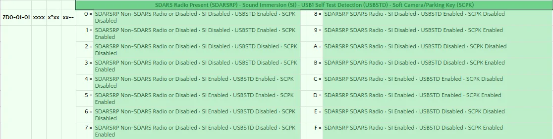

With FORScan, you can disable SDARS in this location in the APIM:
S650 Mustang Uninstall Sirius XM From My Mustang GT 1769618679043-zj

I suspect it's possible through Forscan, as I was able to edit (remove) data / display info from my center screen. Beyond my pay grade, but if one of the Forscan "brainiacs" would happen to stumble upon this thread, they might be able to waltz you through the program changes, and it would be reverseable.
Edit: see above LOL
