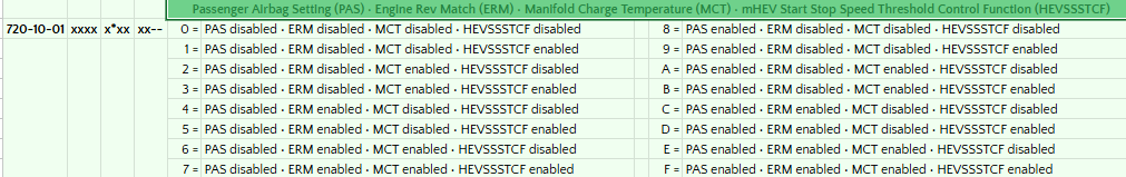

I would try disabling PAS in this location of the IPC with FORScan:
S650 Mustang Turning off airbag light when installing Bucket seats. 1765567208196-we
@John S Your vehicle being a 2022 is different and there is no FORScan sheet for previous gen. However, looking at the 2023 Explorer sheet, PAS is located in the same location on the IPC of those vehicle, so worth a shot to try it, imo.

None is needed. It is very easy. Assuming you already have a windows laptop, all you need is a $30 cable. FORScan itself is free for a 2 month license or $20 for a year.
