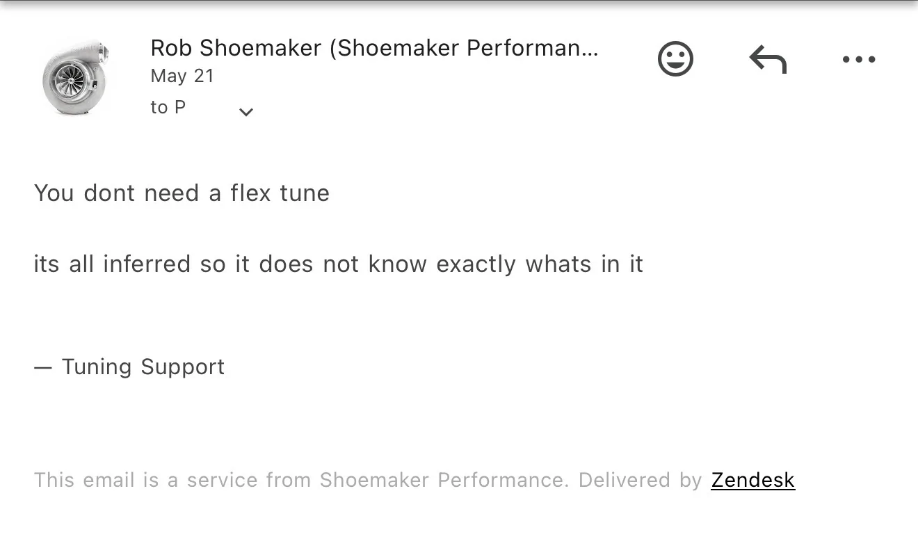

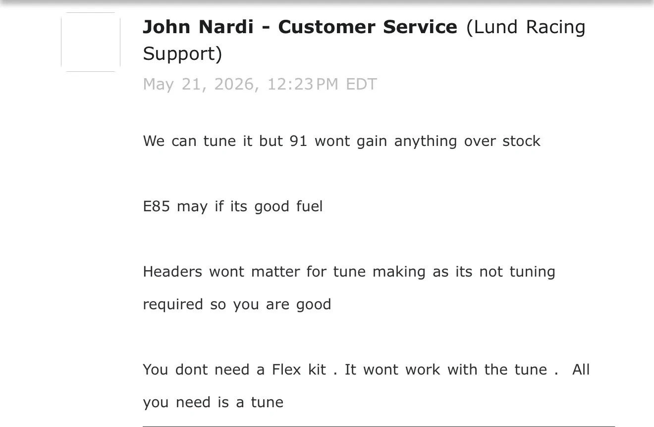

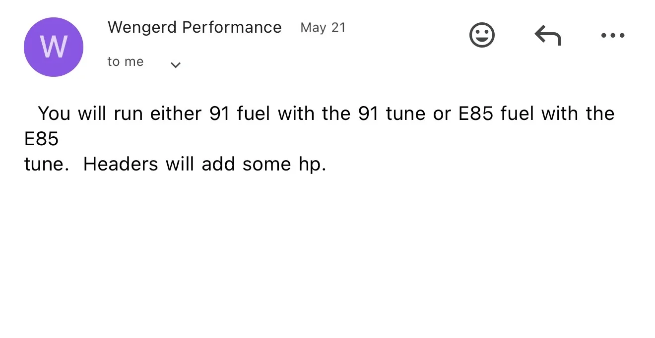

All - just quick update. I reached out to Lund racing and few others. Below was the response I received from Lund customer support.
I really don’t understand necessity if we don’t gain anything on 91 tune and e85 we may? What’s use of tuning?
Shoemaker, wengerd support and DRP responded saying below.
Out of 3 only DRP was able to give apporx hp gain with tunes. Think I’m gonna go with DRP for now.

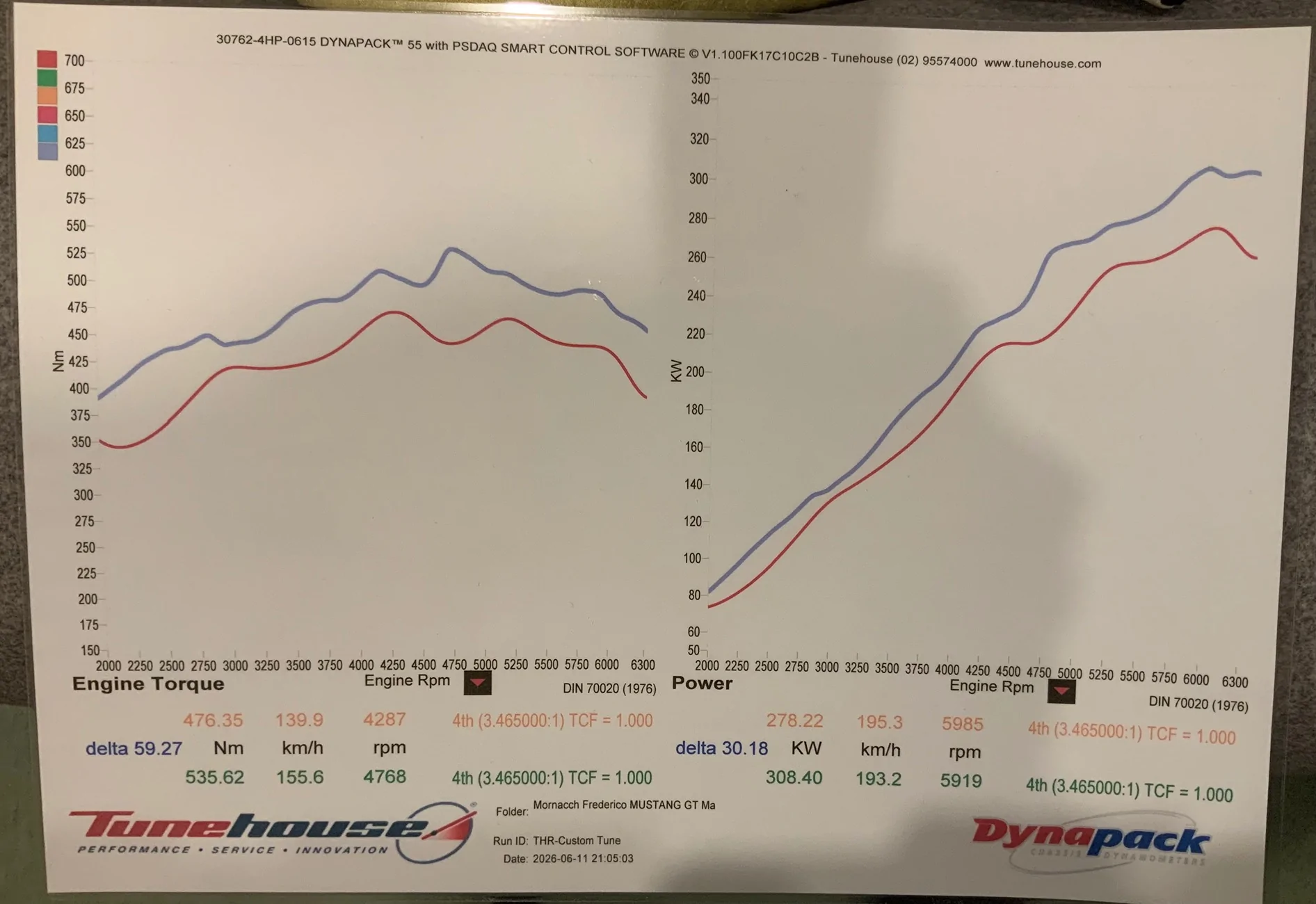

Yesterday I had my GT tuned (stage 1). In the picture you can see figures before and after the tune; values are at the wheel, not crankshaft.
Who did you get tune from? Is it stock car?
3,012
2,995
Can anyone translate that dyno graph to bald eagles per cheeseburger for those of us in the back? This a joke do not take seriously.
open the google and type in "278.22 kw to hp"
373.09 mechanical hp
308 kw = 413 hp
535Nm = 394.59 lb-ft torque
