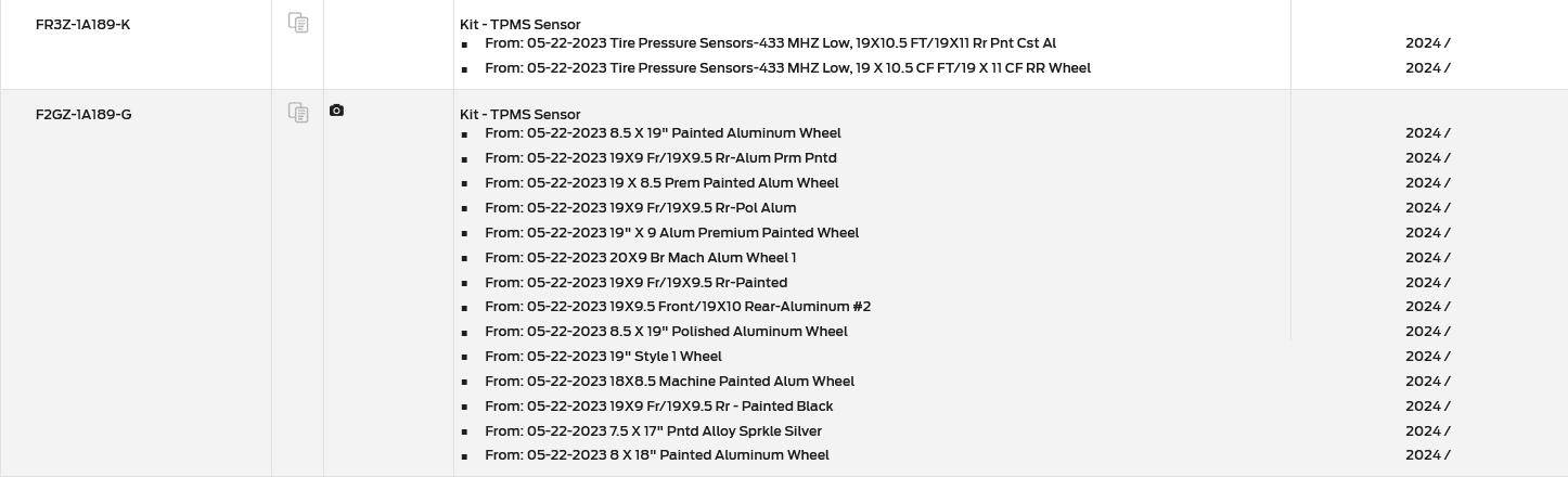

I'm dealing with the same issues as I am working on a second set of tires/wheels/TPMS for winter.
I contacted parts at my dealer and they weren't really sure what was needed. There are two parts listed for our car and the only difference they noted was rubber vs metal stems. They believed the F2GZ-1A189-G to be correct for my VIN since the stems found on my car are rubber. They quoted me $89.00 each.
What to the TPMS do with regards to magnaride anyway? Please let me know if the TPMS74s work for you.
