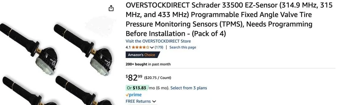

If you've been struggling to find clear information on syncing your TPMS with your Mustang, here's what worked for me:
I used Schrader 33500 EZ-Sensors (314.9 MHz, 315 MHz, and 433 MHz), which I purchased on Amazon. I programmed the sensors to the 433 MHz channel and successfully synchronized them using a QWIK Sensor during the Mustang’s re-learn ceremony.
Hope this helps! Let me know if you have any questions. I read that it may require dual band 433 and 8**. I will check back in a few weeks to see if it requires to be re-programmed.

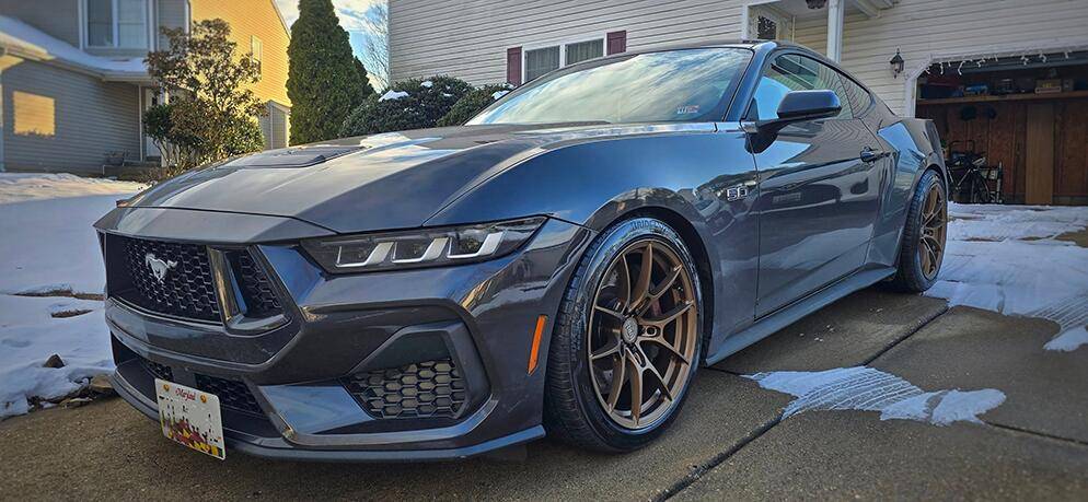

For context, here's my setup using the Schrader 33500 EZ-Sensors:
Wheels: 19x10 ET40
Tires: 265/40 square setup
