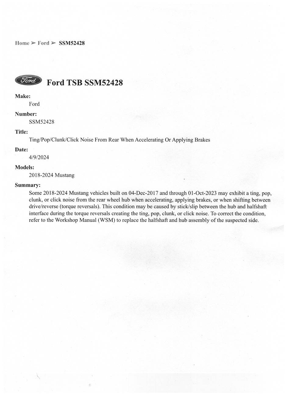

Been there done this with the roll forward on start up and clang/bang/boom... And by the way, IT WILL Not Move at all with the E-Brake on, but you will still hear the noise. See Ford TSB # SSM52428 Attachment bring it to the dealership get it fixed. From what I have seen it seems to be the pass. side axle that needs to be replaced.
Nice. The OP mentioned his dealer didn't know the cause. After reading this, I have to wonder if their is some dealer ineptitude making repairs worse than they should be.

LouG ... Nothing to do with the tires or wheels, its about the backlash of the axle and hub sticking together and when the engine starts the shock load coming from the drive shaft releases the free play that causes the Bang...
