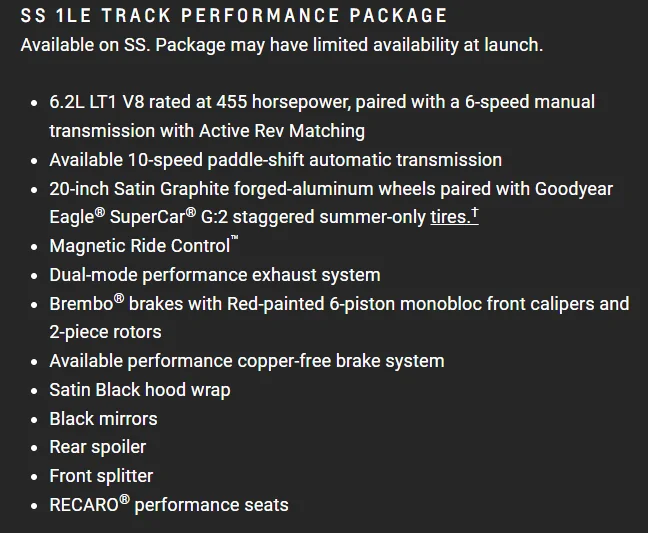

Just another way the PP is a complete letdown from ford... the 1LE package on the SS Camaro gives you all that plus a tremec.
