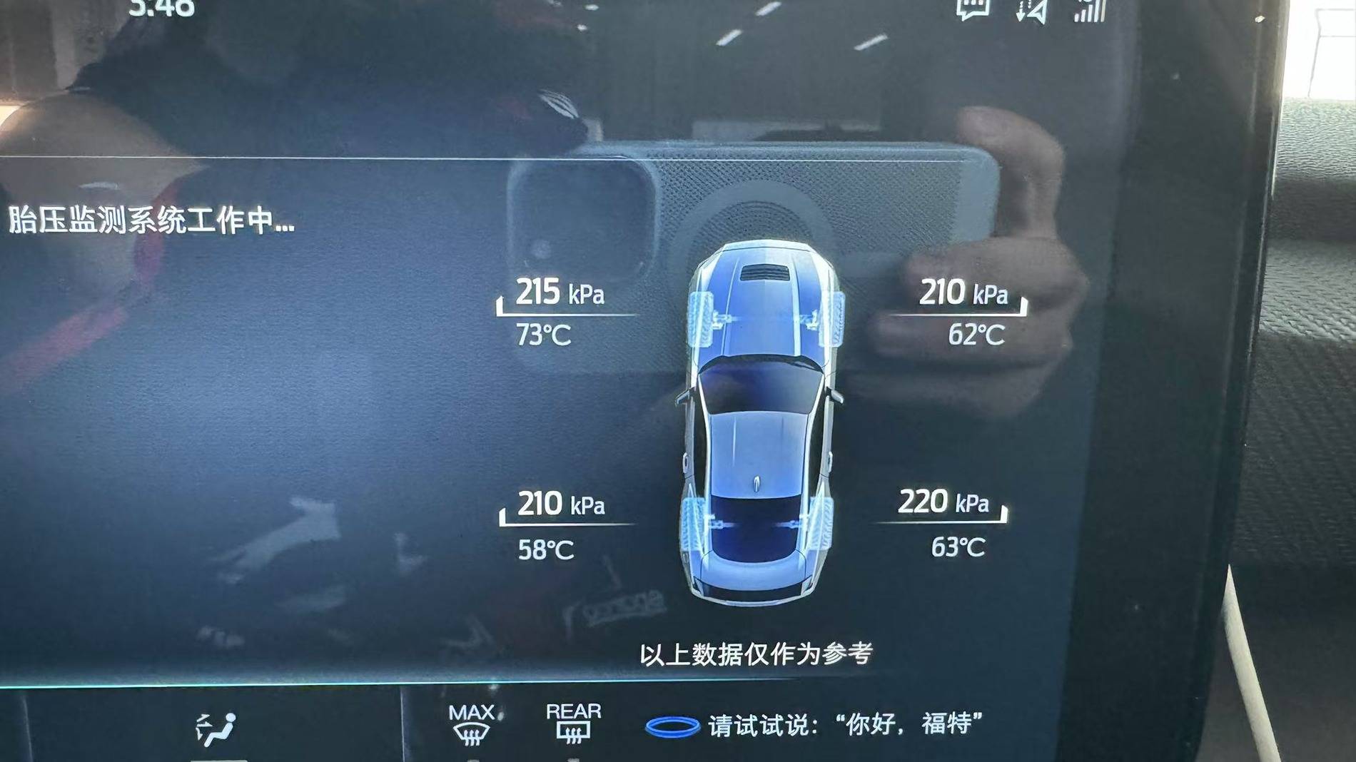

This image is apparently from a Dark horse in China. It was posted by the owner claiming that it is "hidden" function and can be accessed and activated through software such as Forscan.
I would give my left testical to be able to see this data on the track! Are there any Forscan geniuses out there that have a hook on something like his?

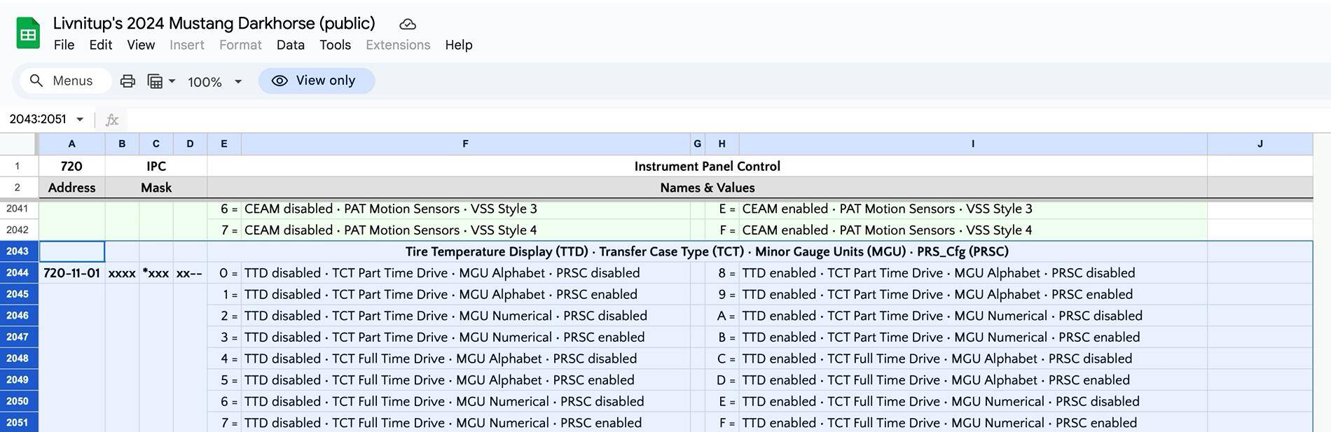

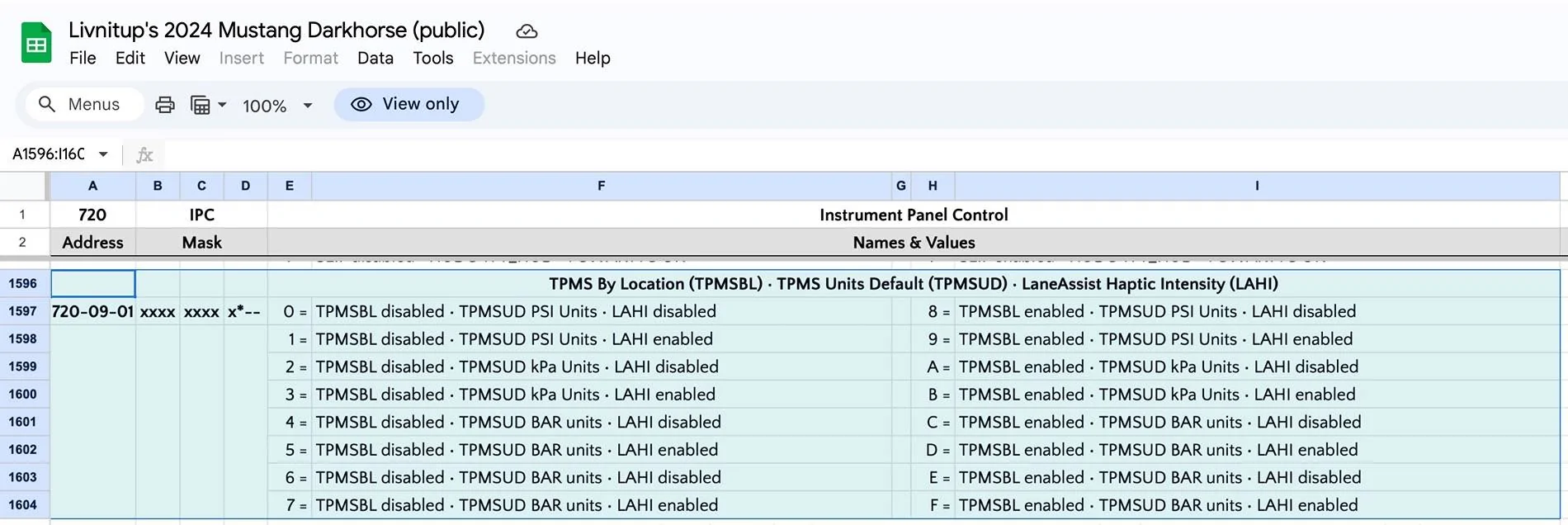

I think it would be IPC, but, I wouldn’t be surprised if the TPMS part is different.
There’s a Chines Menu, which I didn’t think you’d be interested in and
there’s this:
this looks a bit more promising:
These are just WAGs.
2,714
4,121
i've tried enabling this. there's one in the IPC and one in the BCM. it does not seem to work. if someone does get it to work, please let me know
You’re a killjoy. Ants at a picnic.
We know it works on the Chinese language screens, and I have a hard time believing Ford would supply different hard parts for them. I thing the Raptor guy said enabling it initially cost him the gear display. I think he said he went from 9 to A and fixed it.
Did you try all the drive modes? I wonder if it’s not compatible with some of the Mustang screens.

I just tried changing the setting in the IPC
720-11-01
Didnt work for me either :(
@roket which line did you change in the BCM? Cannot find anything related to tire temp in the sheet.
So how does it take the temperature? Can the Factory TPM measure heat of each wheel. Looks like A.I. fuckerey.

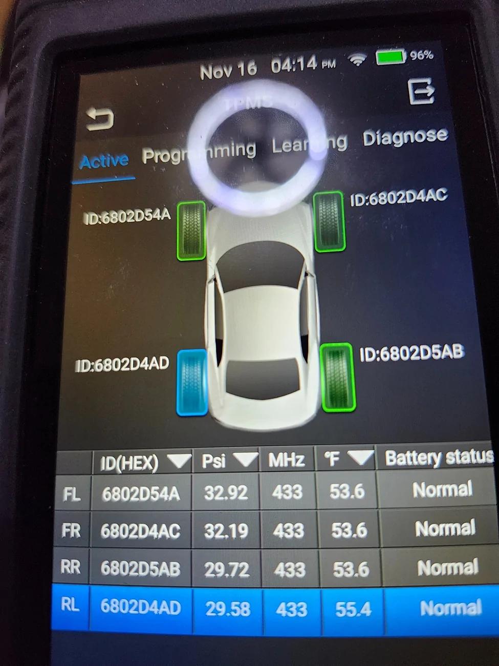

Tpms sensors often read temps as well...
A shot from my tpms tool showing the readings on my S650 sensors
Just realising that this image is of the centre screen, not the IPC. Which menu shows the tire pressures in the centre screen? I could not find that.
Well, that screen shot was from China and you appear to be in Europe, so the options may be different. For me in the states, you go to the Mustang menu (via the pony button) and then pick auxillary guages.
