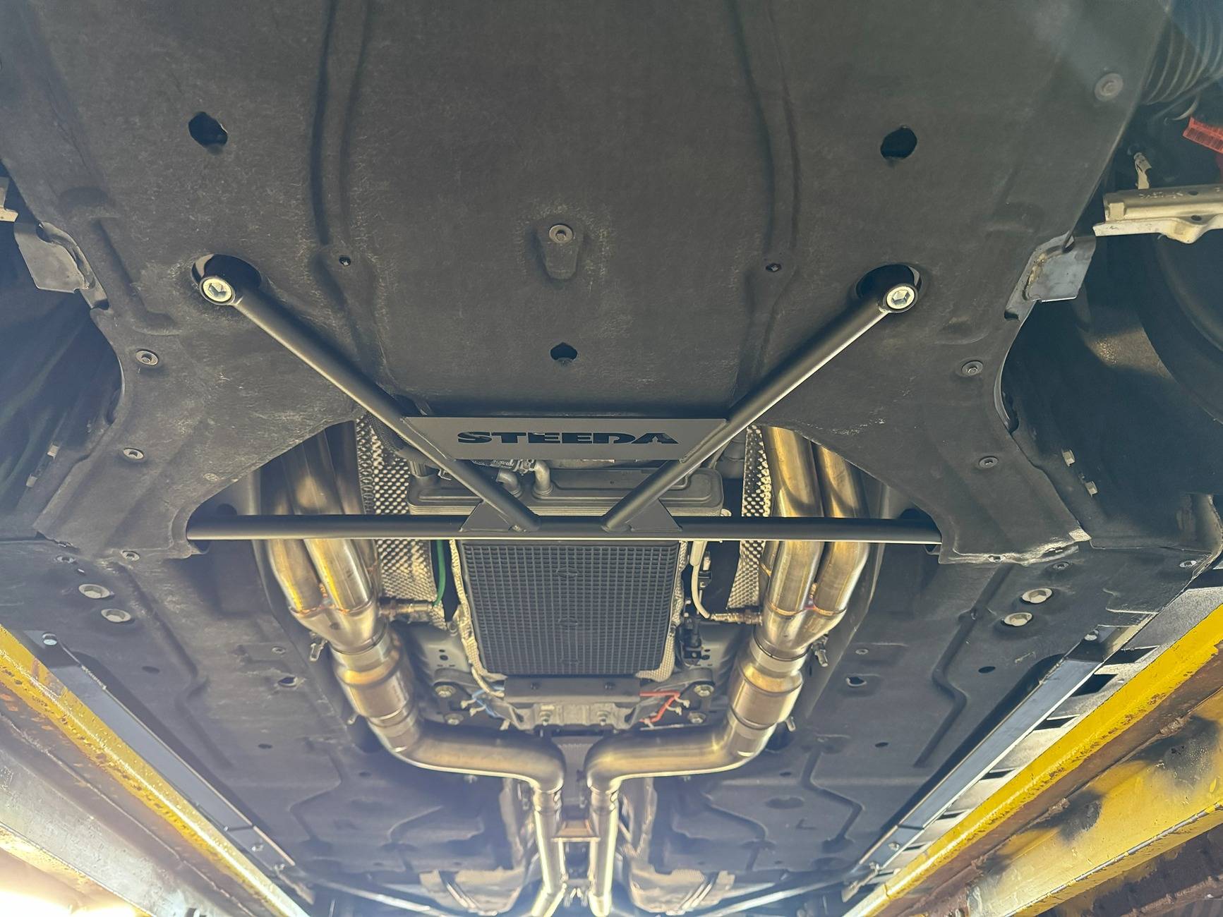

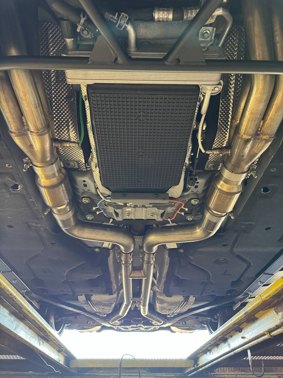

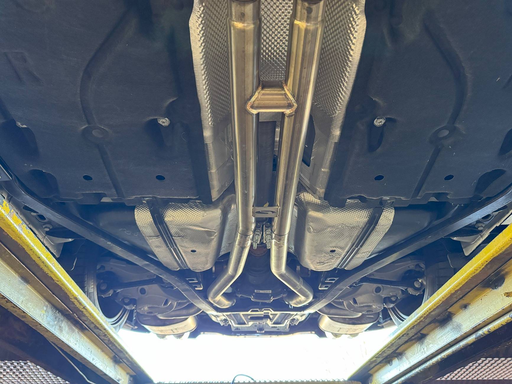

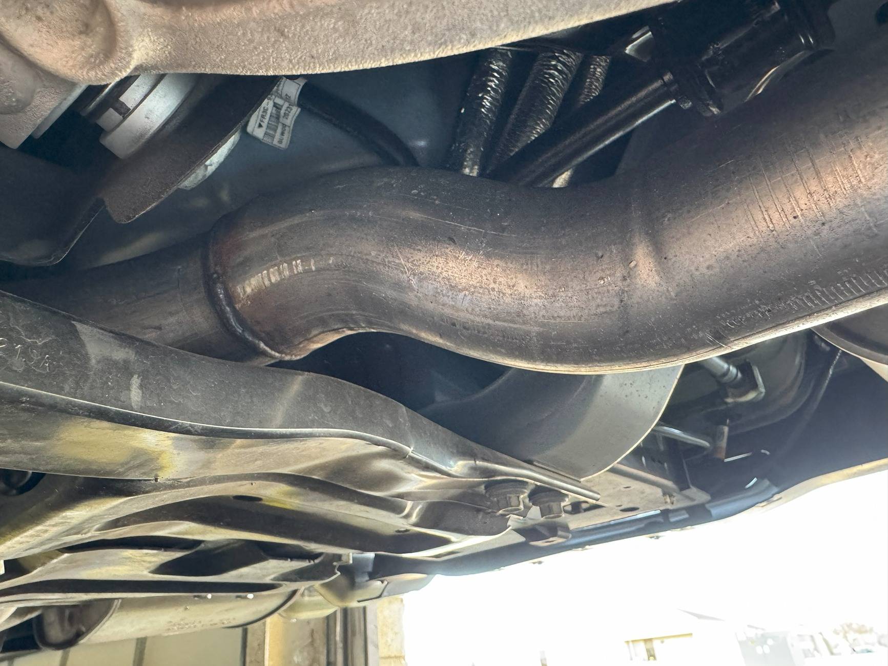

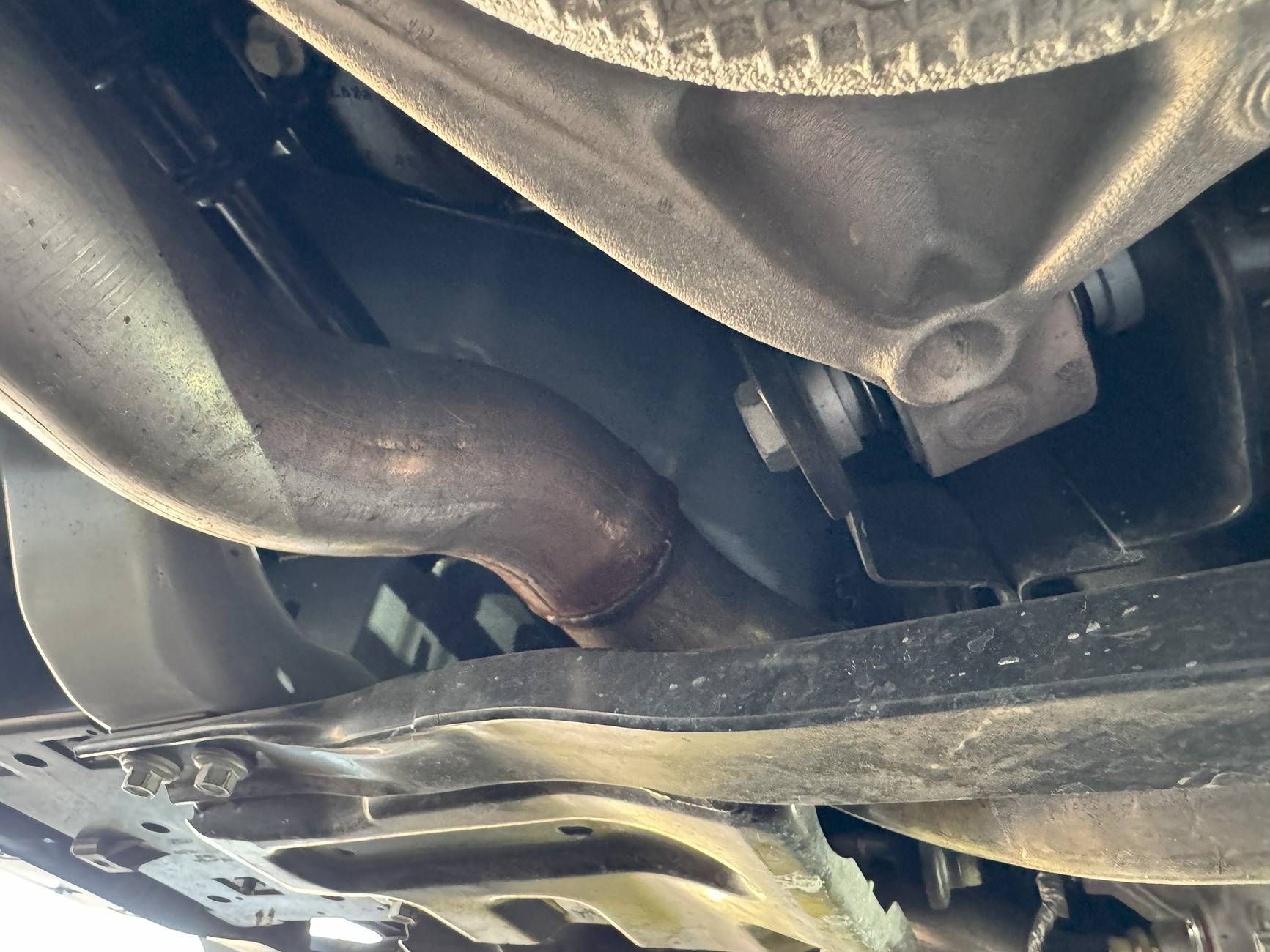

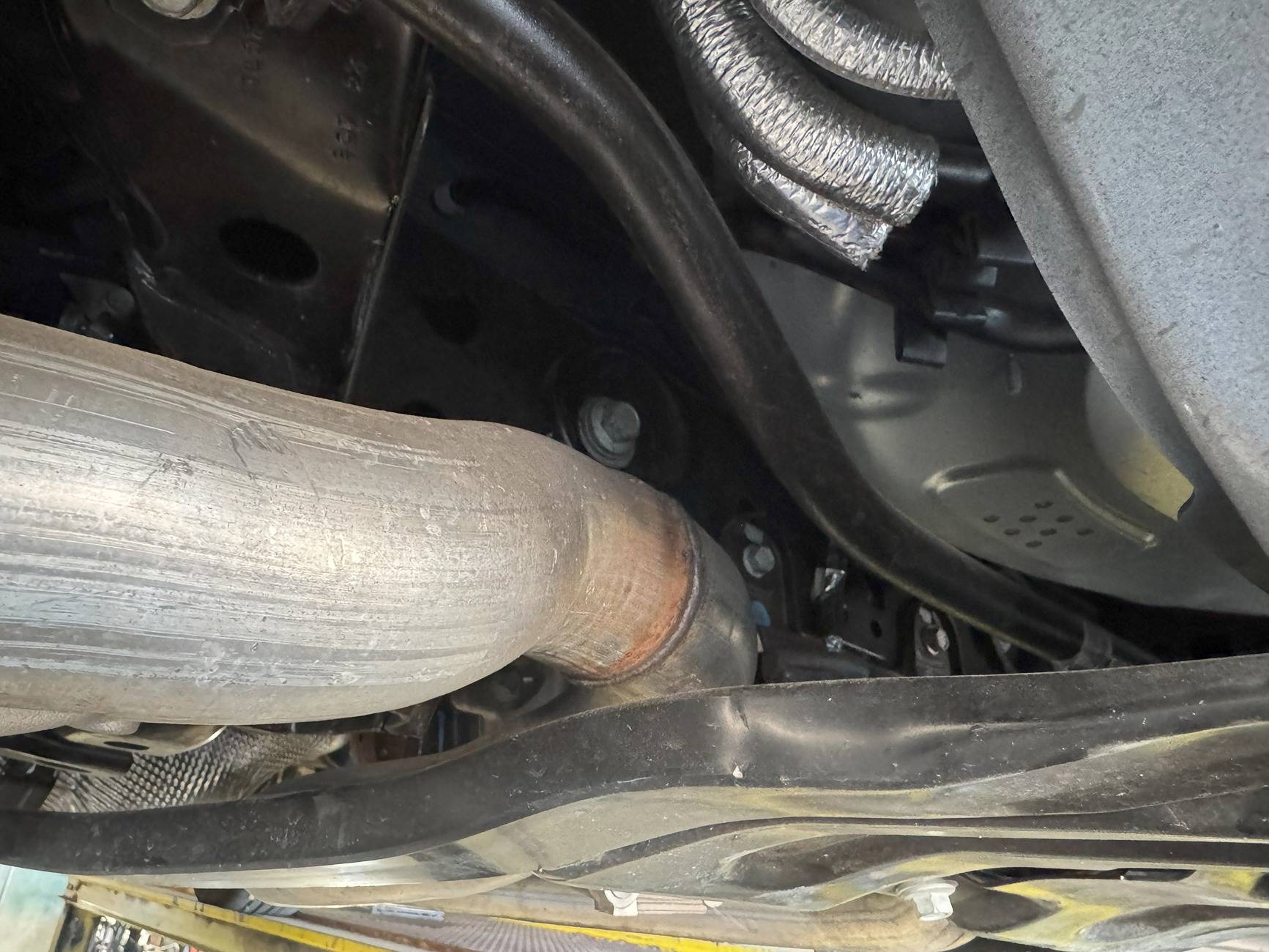

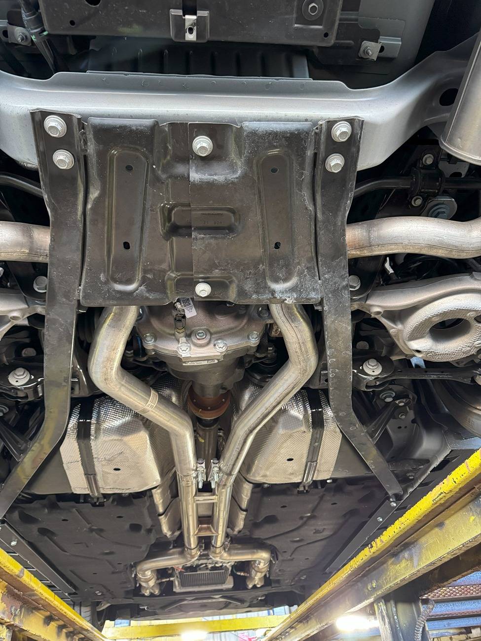

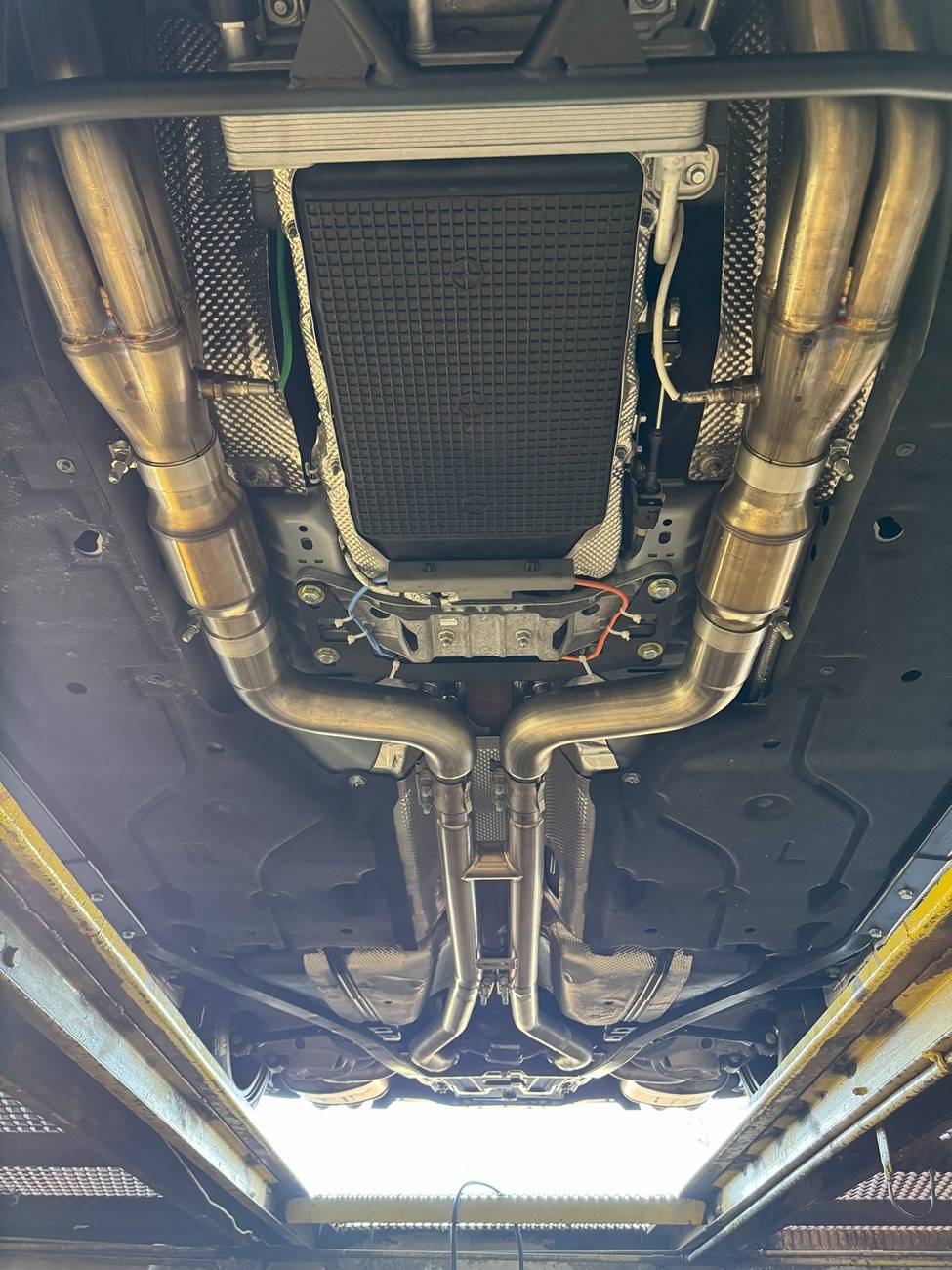

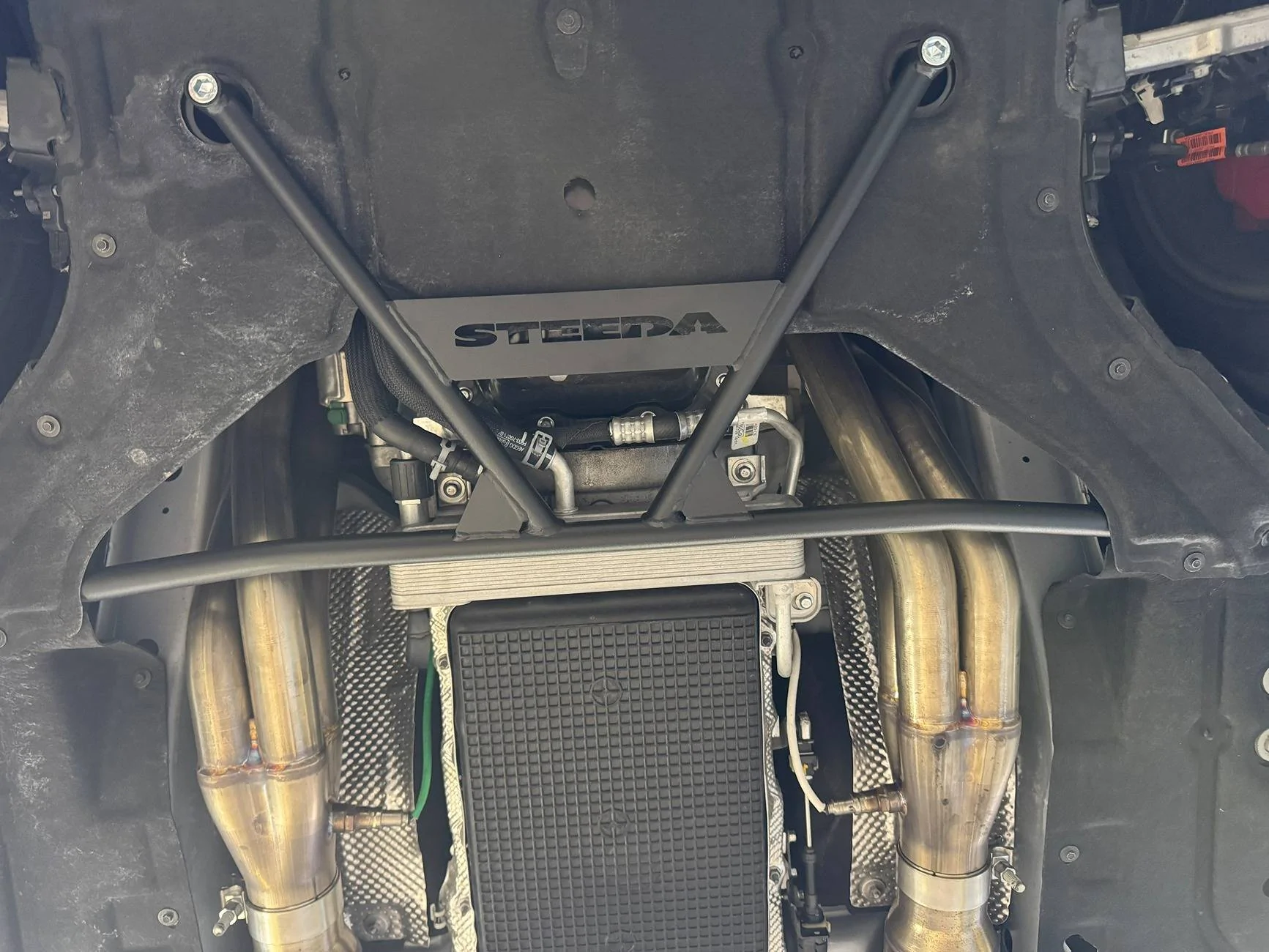

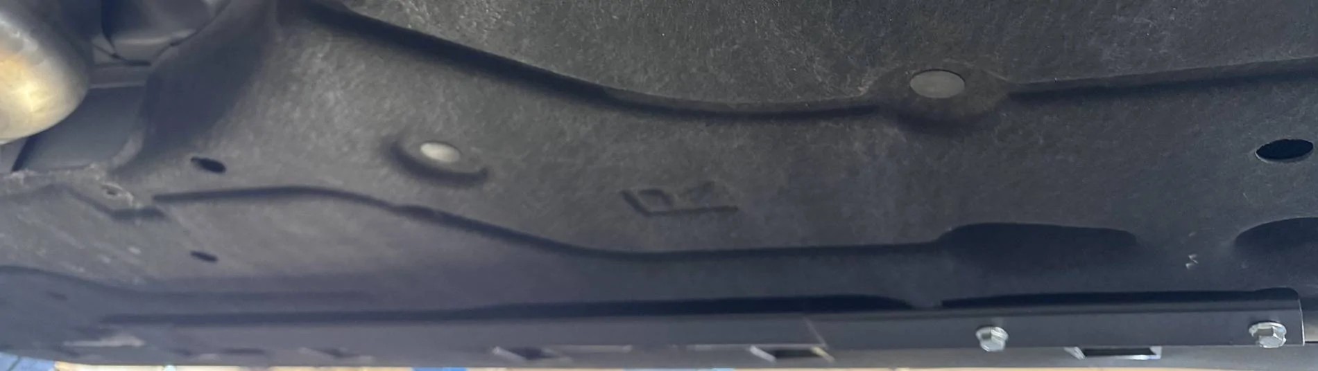

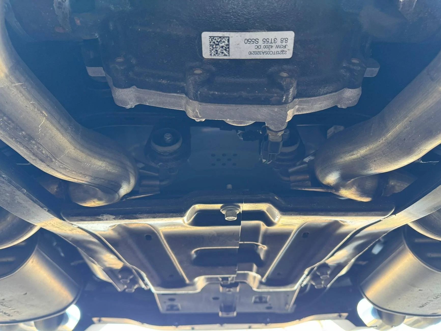

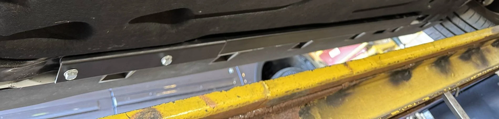

I put the Steeda Subframe Alignment and Support kit on the back of my 24 GT Convertible PP over the winter. I have driven it about a month with it on and it has made a huge difference. It seems to make the rear end more compliant and confidence inspiring.
I also added the BMR front of the K-member brace (CB763) and the Steeda Extreme G-trac K-member brace two weeks ago. Cowl shake over bumps has almost disappeared. Now the front and rear of the car seem to be more compliant and stiffer. I also just added the Steeda convertible low-profile jacking rails a few nights ago. The car is really coming together. Now I think it is ready for some more power! Here are some pictures of the underbody. I want to find full 3'' exhaust that fits the convertible as well.

that is great to hear. Those are the mods I’m aiming for.
any NVH after the rear alignment kit?

How are you tackling oil changes with the steeda k brace covering that lower pan? Do you have to unbolt the k brace to lower that pan?
