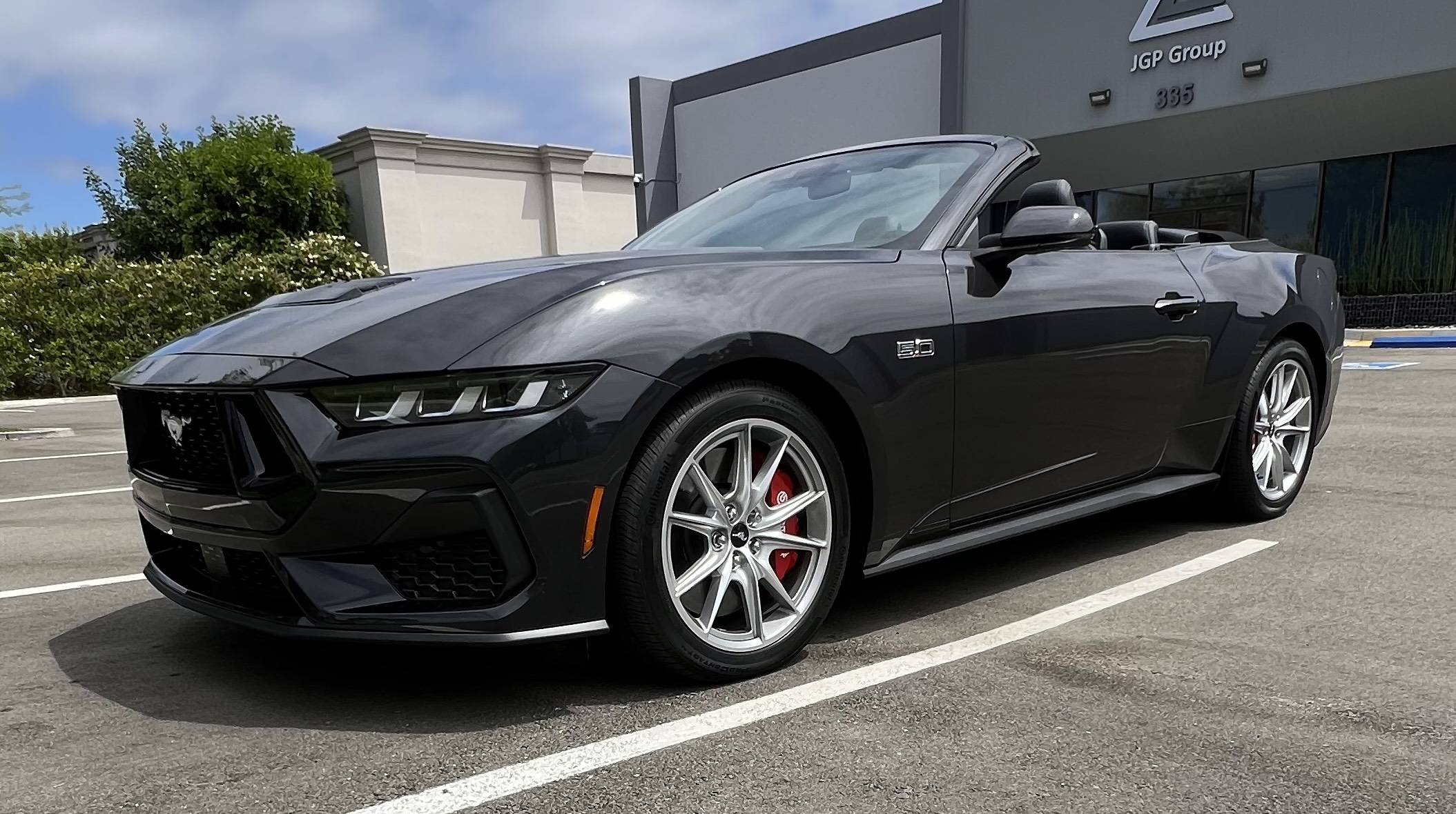

Anyone supercharged their convertible yet? I'm thinking of adding in the whipple from Ford Performance for the 810 hp.
Now I know what you're asking, but why on a convertible?
I wanna go fast with the top down. Hear the supercharge whine with the top down.

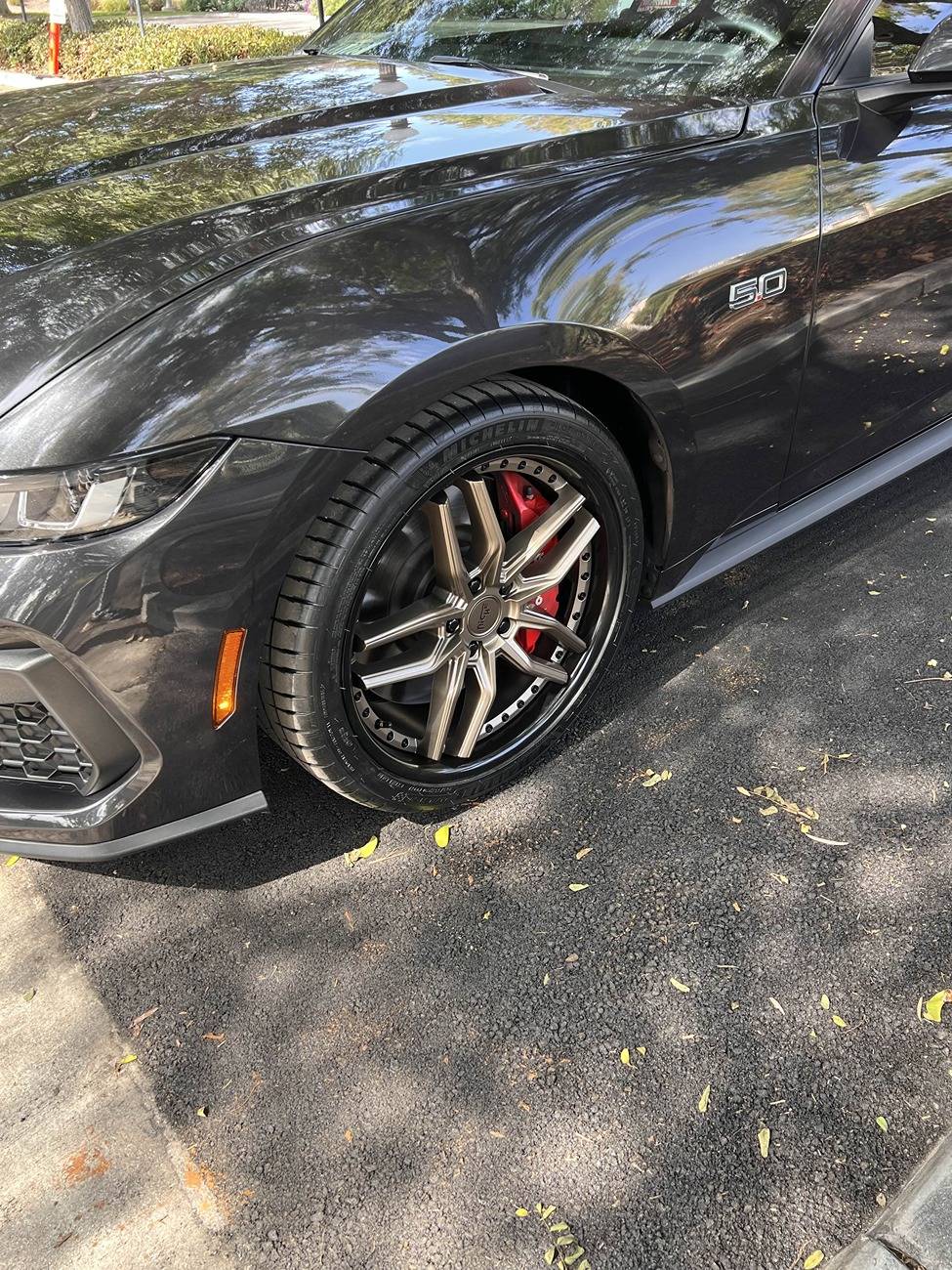

I have upgraded my factory wheels to Michelin Pilot Sports 4S.

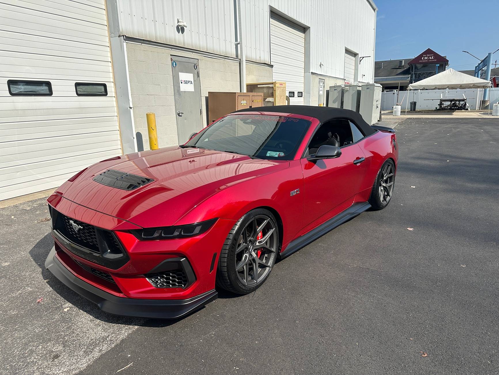

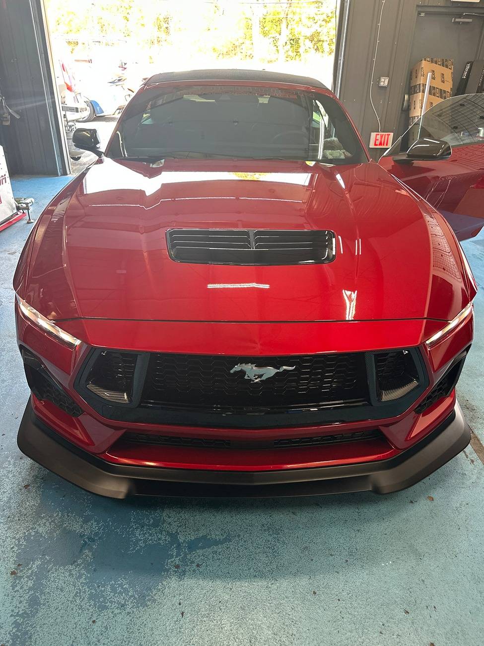

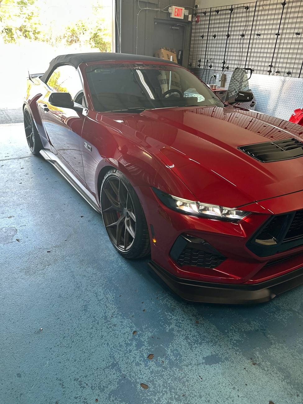

I had the Whipple Stage 2 installed by Evolution Perfomance about 2 months ago. They also changed the exhaust, tires, rims and few other things. I do not have pics of the motor right now but will take some tonight and give you more info as to what was done. I have had no issue except the fact that I do not want to get out of the car. It is over 800 HP of fun and well with it if you have the money set aside for it. Call Fred Cook at EP. He is a genius.

I am curious as to where the skirt is from and what is going on with the headlights? Is that a midnight pony pack causing that with non black emblem up in front? Looks reaaaalllly nice!

As for the tires, I recently upgraded to Michelin Pilot 4S and had 0 wheel slippage, it’s actually quite phenomenal even when I really get into it through corners.
