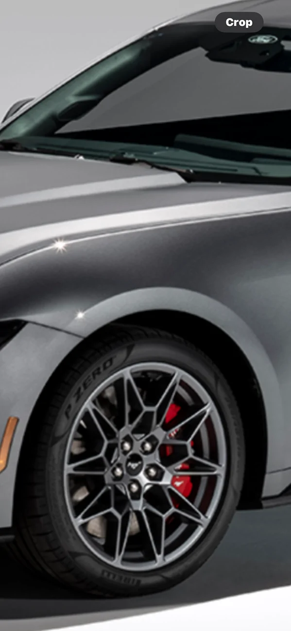

Yeah those I don’t like…
see attached for stock look
S650 Mustang Stock PP Package Wheels Question- Widened by Weldcraft? IMG_8269
