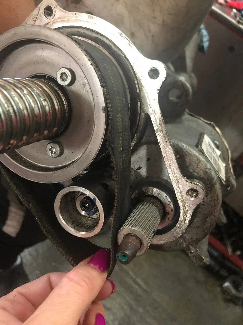

I'm attaching three files.
The first is a tutorial on Ford's Electronic Power Assisted Steering (EPAS).
The second, a picture of the physical connection, linking EPAS to the mechanical suspension. Notice the linear screw in the photo. Given a screw and proper gearing, you can achieve extremely precise movements.
The third, a list of acronyms.
So yes, there is the mechanical linkage of the suspension; this must be properly aligned. Ford provides one free alignment check and adjustment in the first 12 months of ownership. I use a tread depth gauge and formally check tire wear several times a year.
Connecting the mechanical suspension to the driver: EPAS. IMO, the steering is not fully electronic, but a hybrid of sorts: electronic to the EPAS motor, then traditional mechanical. Generations past, the driver directly interfaced the suspension via physical steering linkages.
I did a quick troll of who is using what for steering. It varies widely, even on 2024 cars, from fully electric to traditional mechanical.
YMMV.
S650 Mustang Steering Wheel  Not Centered epas belt fail
