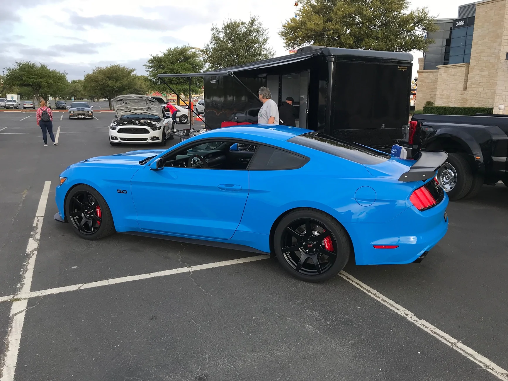

I have the full Steeda set up on my 2017 S550 the NVH is negligible until I did the differential bushings and I used the softer density bushings.
This will require an alignment after install and I would suggest a shop that is familiar with these cars and track settings.
I have checked my car at least twice usually before a big track outing and the torque has never changed.
you will get used to the added NVH quickly and as a driver who is pushing their car towards its limits you will appreciate the confidence Steeda’s suspension provides.
My car is only limited by the tires and the stock seats and the nerves of its driver.
Good Luck
