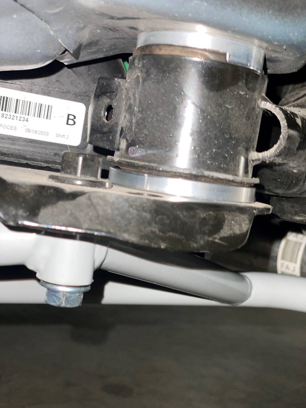

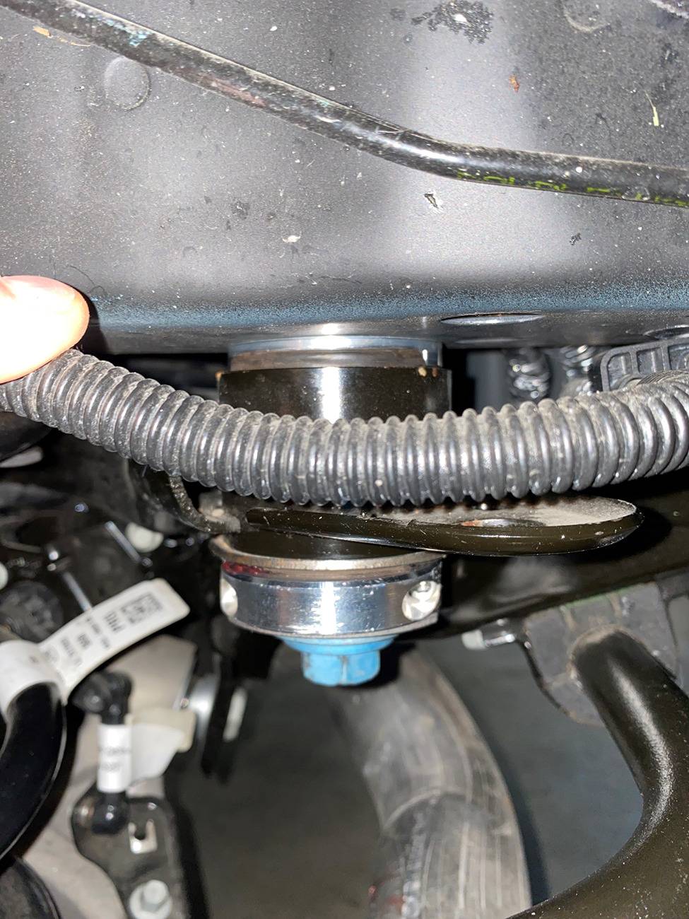

Had the day off so decided to do the install today. Wasn't that bad at all.
S650 Mustang Anybody install the "Steeda Mustang 'Stop the Hop' Street Starter Kit" 1
S650 Mustang Anybody install the "Steeda Mustang 'Stop the Hop' Street Starter Kit" 2
