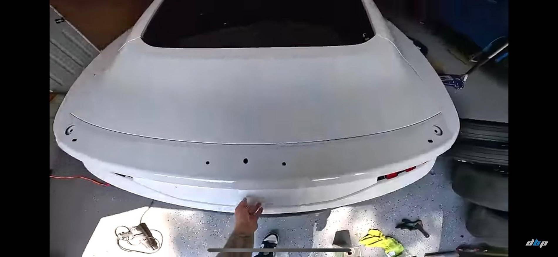

Yes, you will able to remove the performance pack spoiler easily. It has one bolt on the left and right support beams (Access from under the trunklid by removing 2 grommet covers). Then the middle support section have 3 alignment pins and all 3 support sections have some factory 3M tape you'll need to heat up and cut through with some dental floss or similar. After you remove the spoiler, your decklid will look like this, ready to mount another a spoiler, either pedastal, blade, duckbill or similar.
S650 Mustang Spoiler delete or not? 2024_Spoiler_Removed

I say get the spoiler. If you search ebay you can find a spoiler delete pannel. I have one with the dh spoiler and one with a duck tail style. Takes about 15 minutes to swap out.

Look through all the threads on this because there is a video someone posted about how to take it off. For me going to get the Shelby Ducktail spoiler and have it color matched.
