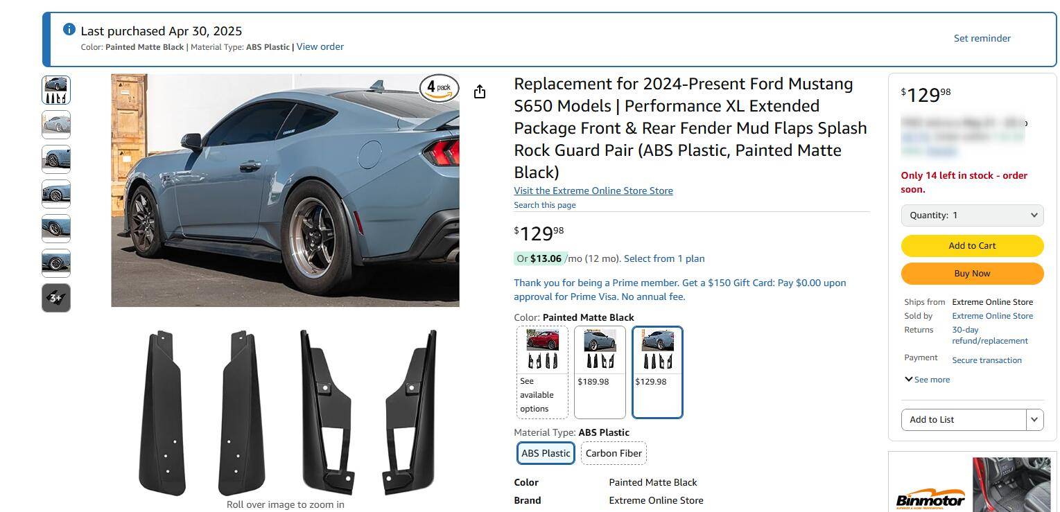

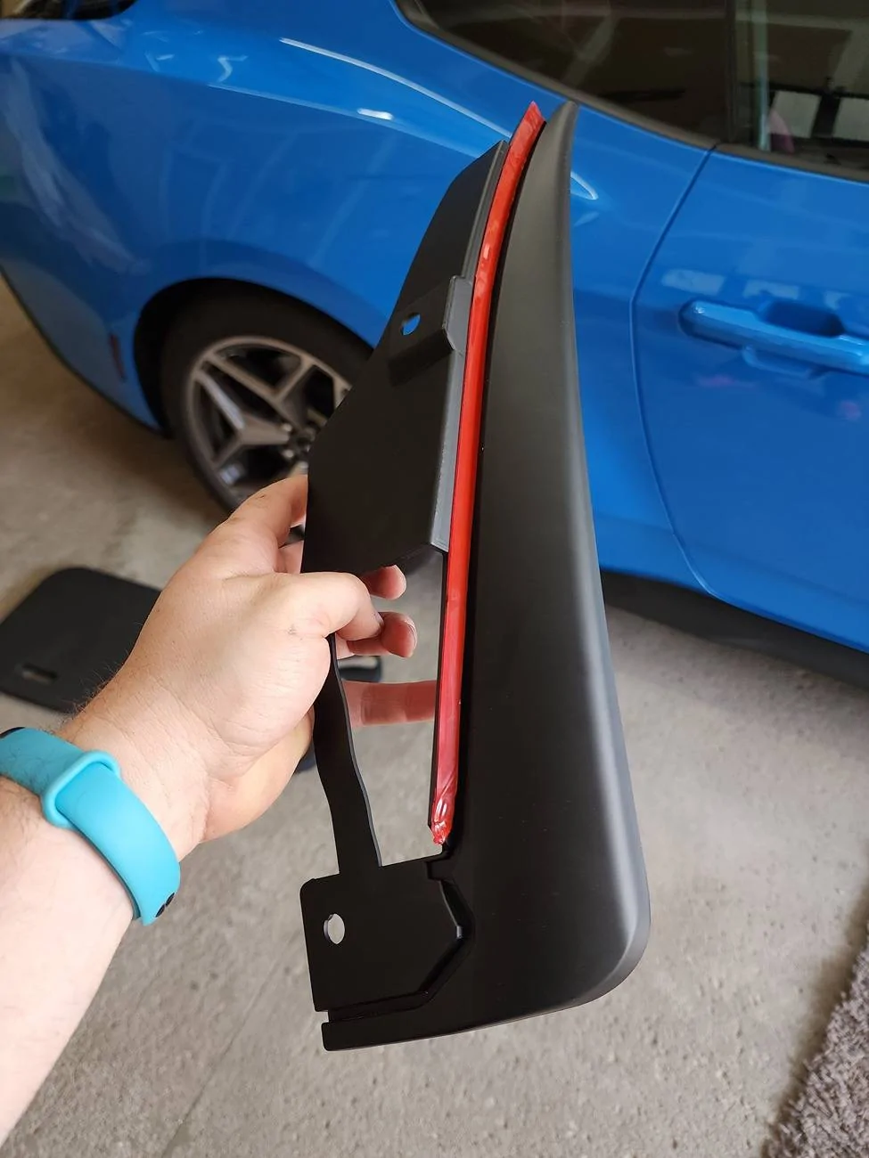

I recently bought and installed these:
S650 Mustang Splash Guards 2025-05-13_14h36_59

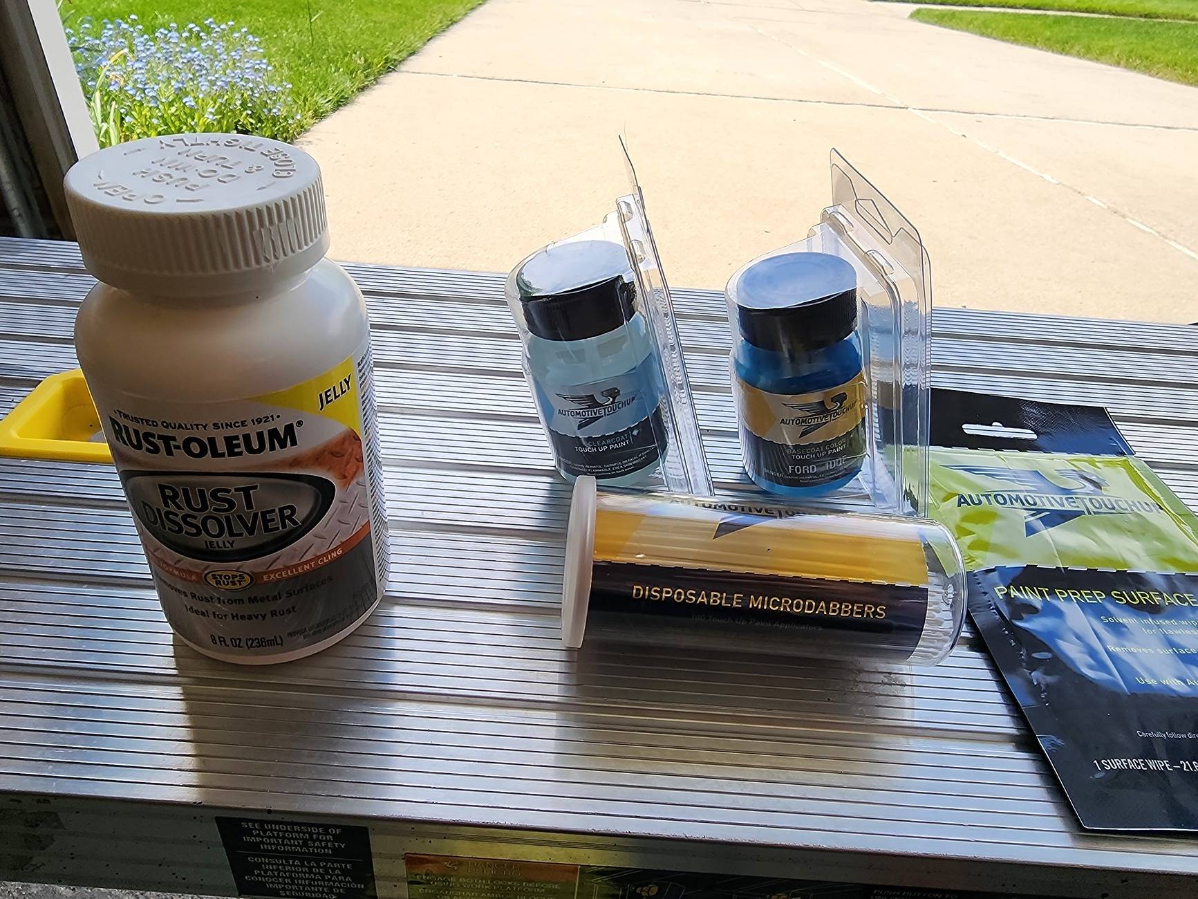

Because of the conditions of paint (see next photo) I did a little touch up using paint chip kit from www.automotivetouchup.com
S650 Mustang Splash Guards 20250512_132719
Car is only 4,000 miles and already this kind of damage :(

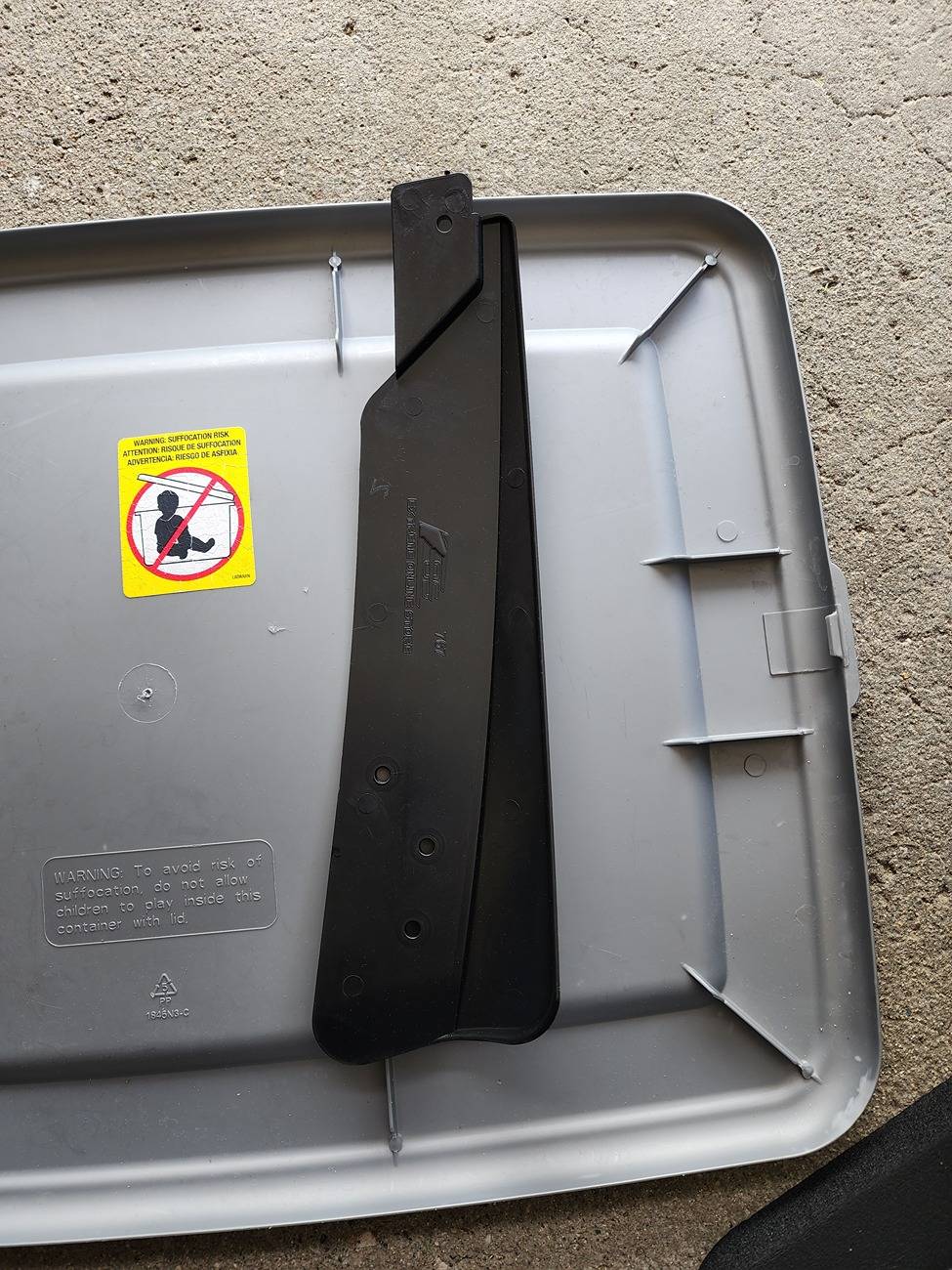

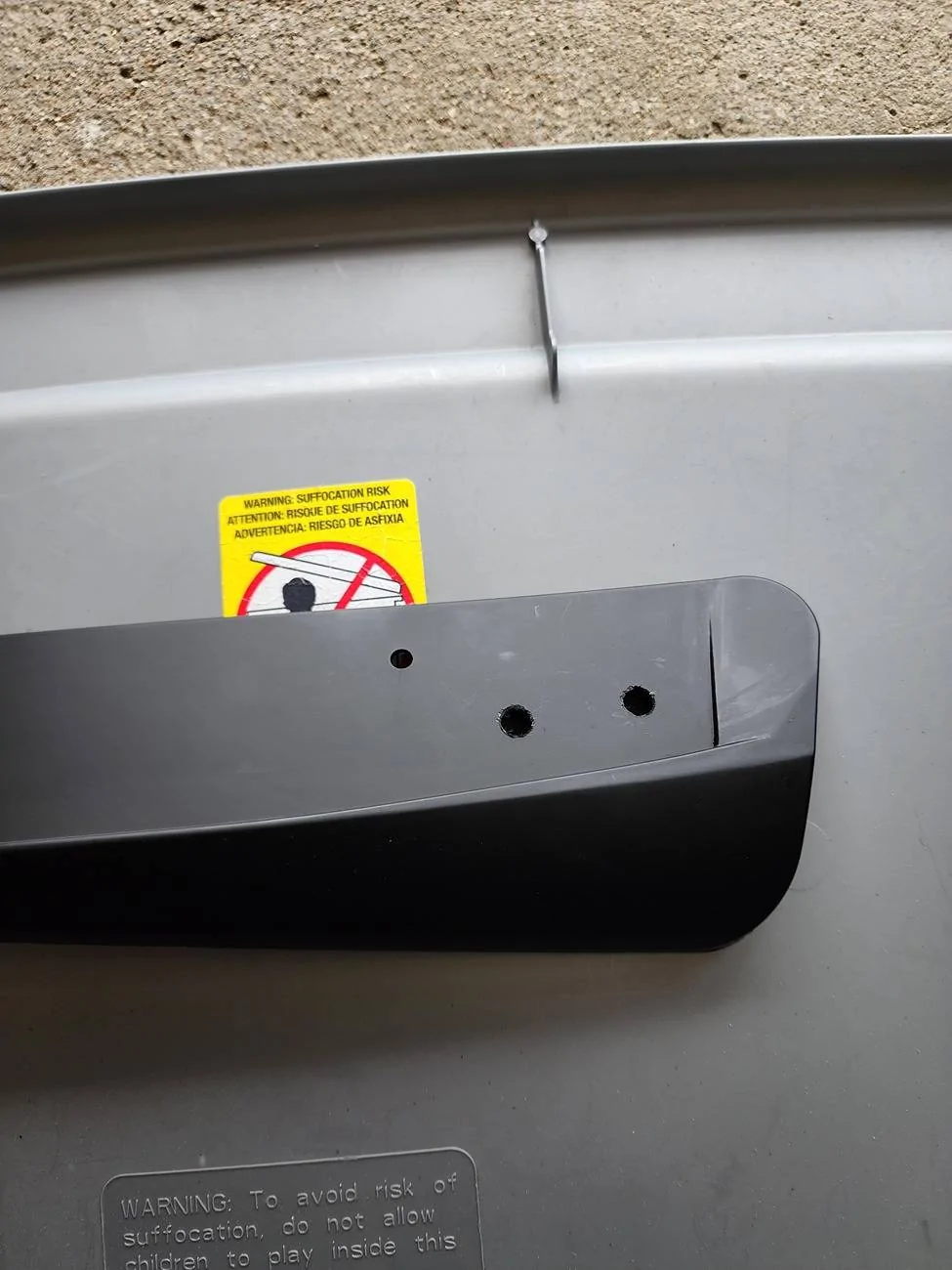

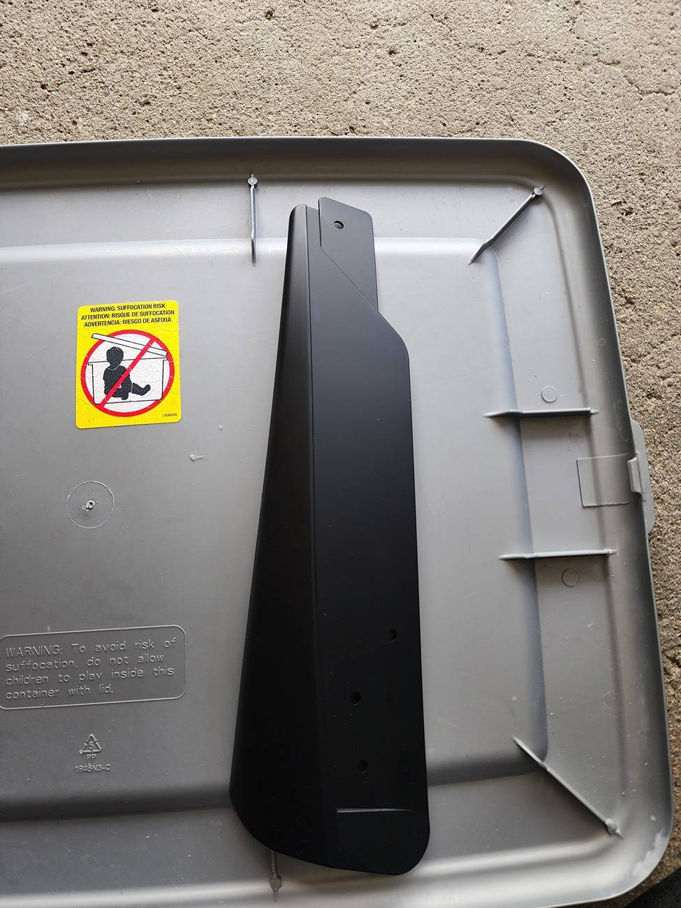

Front mud flap.
S650 Mustang Splash Guards 20250512_134025
S650 Mustang Splash Guards 20250512_134018

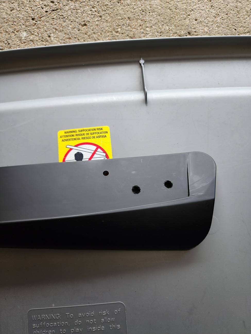

Lower holes are too small for the push pins, so I butchered them open a little using a file
S650 Mustang Splash Guards 20250512_135052
Tape is provided, but no instructions whatsoever on how to attach it. Used my best judgment :)

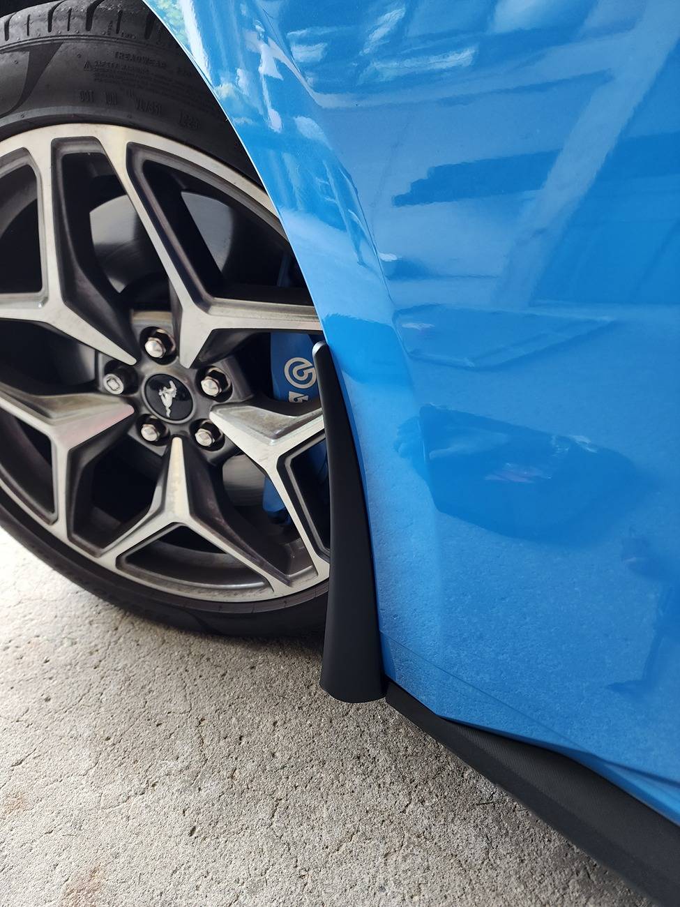

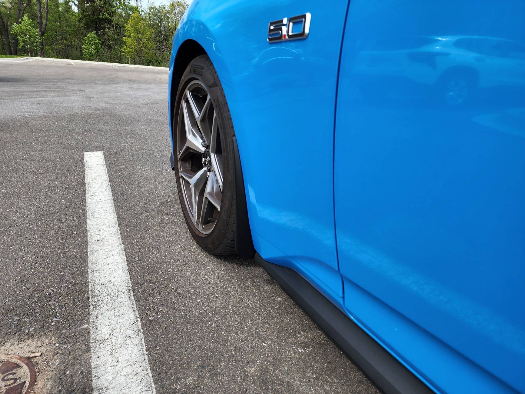

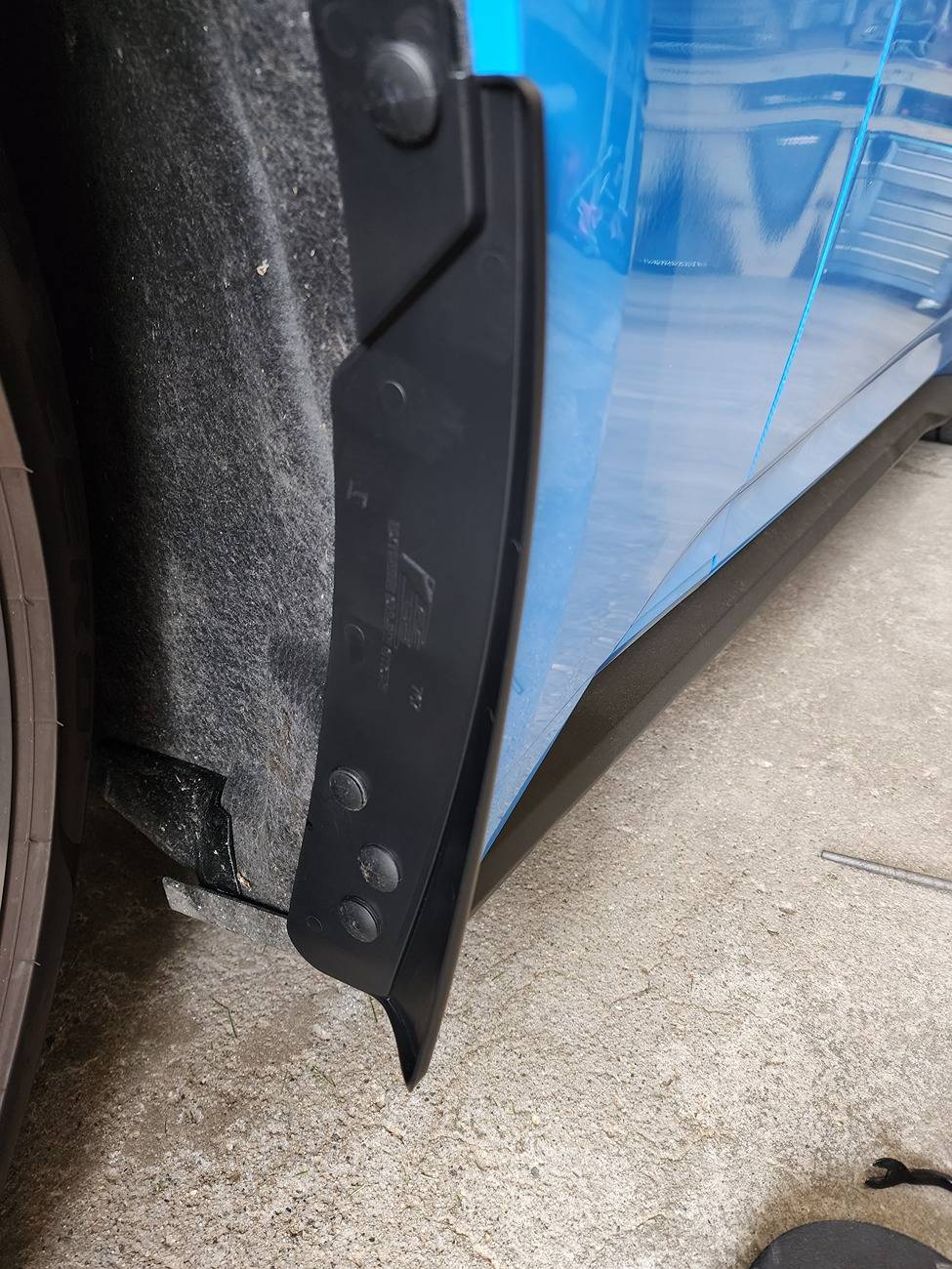

Installed. Just remove clips/pins and reinstall back, nothing special
S650 Mustang Splash Guards 20250512_135730
S650 Mustang Splash Guards 20250512_135741
S650 Mustang Splash Guards 20250512_160155

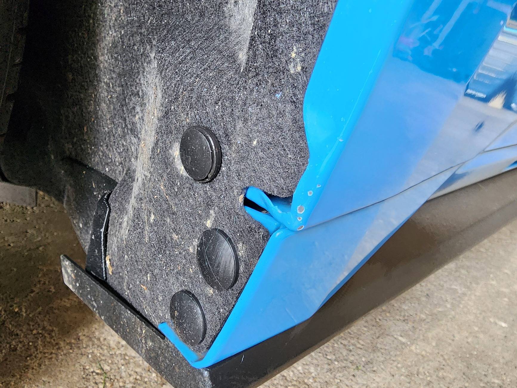

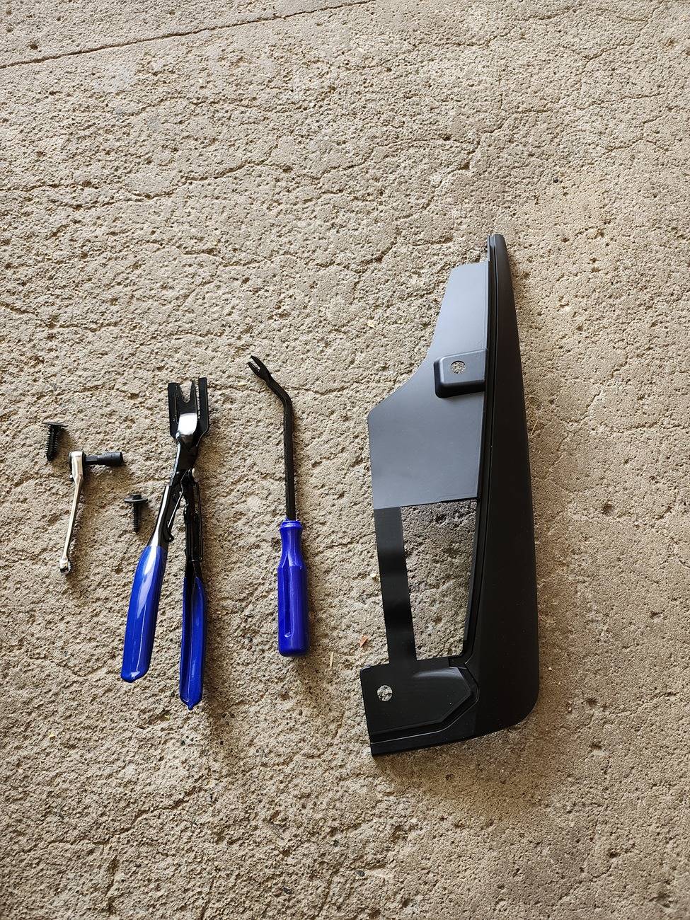

To install the rear you'd really want to have the smallest rachet you can find. I have really small one and managed to install them just fine without removing wheels.
For the lower push pin (Christmas tree type), pins removing pliers is a must. I replaced this pin with two-part "normal" clip
S650 Mustang Splash Guards 20250512_141549

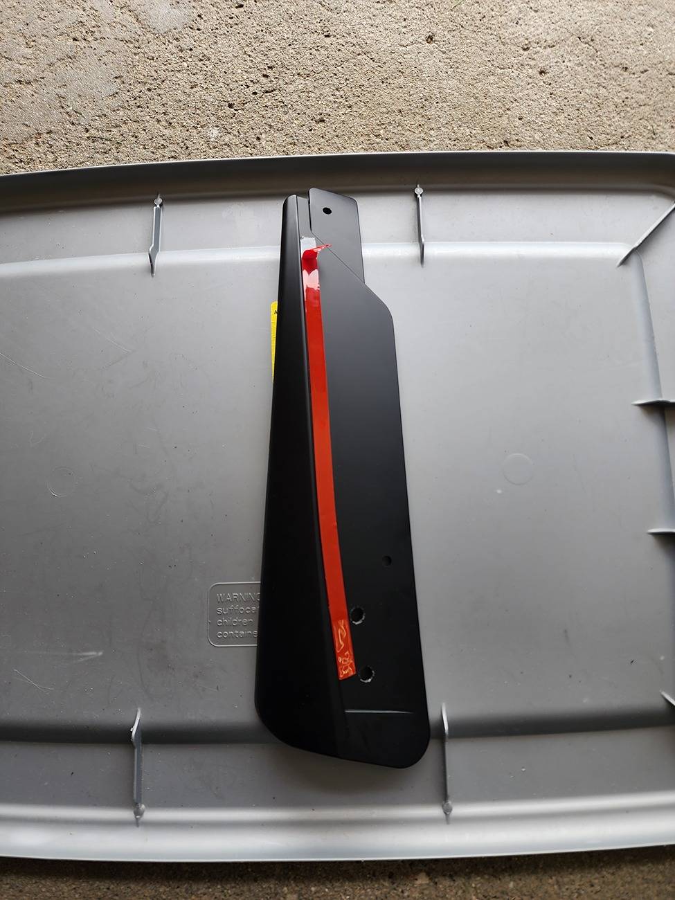

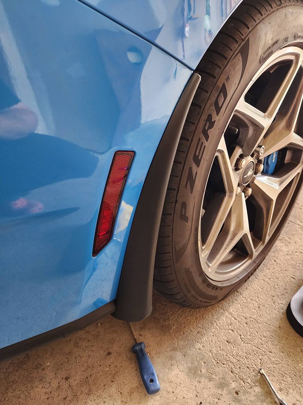

This is how I attached tape.
S650 Mustang Splash Guards 20250512_141730
S650 Mustang Splash Guards 20250512_142542
S650 Mustang Splash Guards 20250512_160150

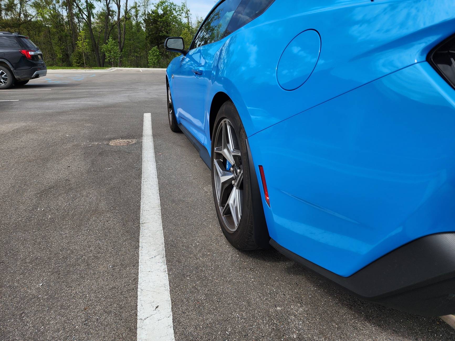

Total time with cleaning, painting chips, filing out holes, installing etc is about an hour.
I really like how they look and fitment is 100% spot on. Guys did a good job modelling them. In hands they feel a little cheaper than OEM stuff would (a little on the thin side I'd say), but good enough. Really look OEM. Recommend.
