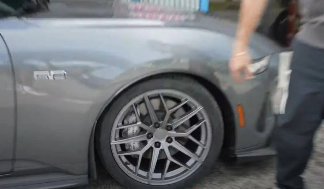

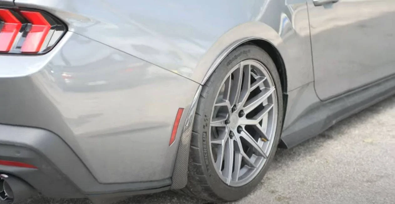

I think these are similar but also with NYTOP fender lip flares.

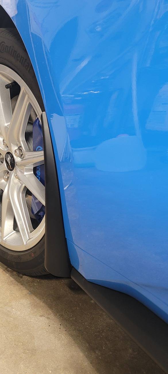

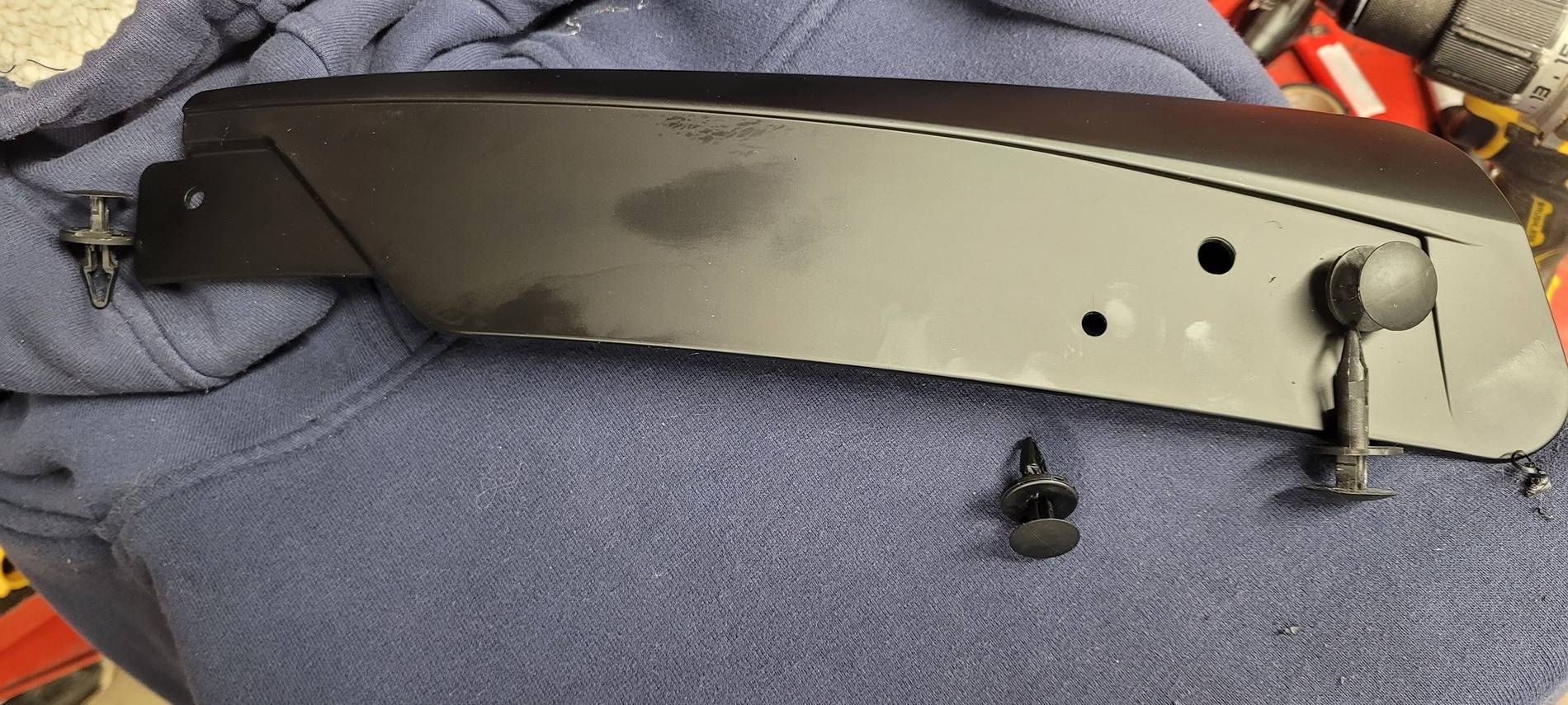

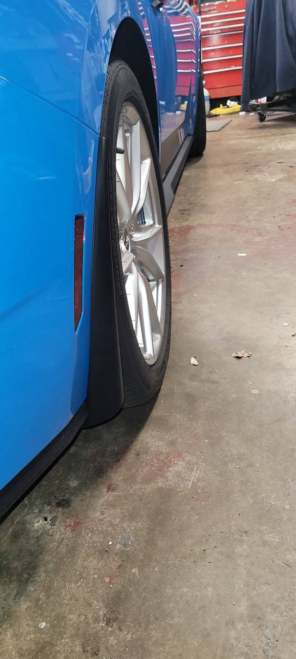

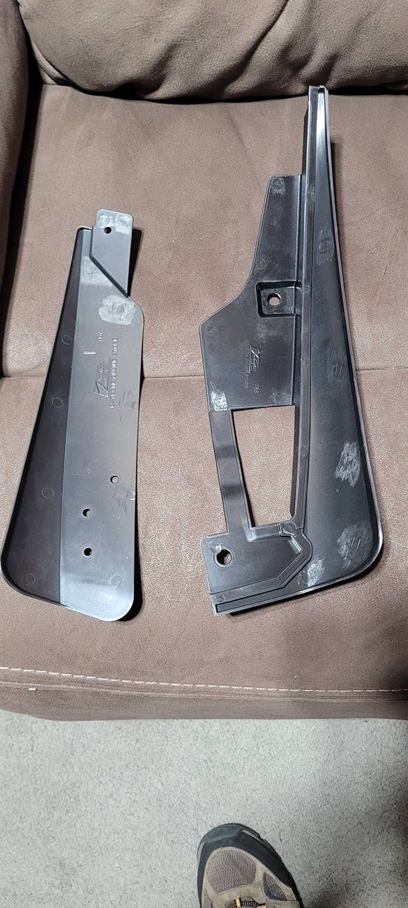

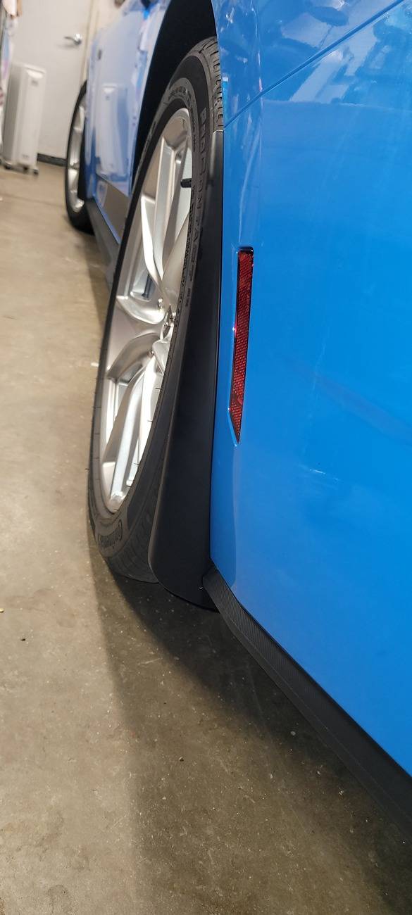

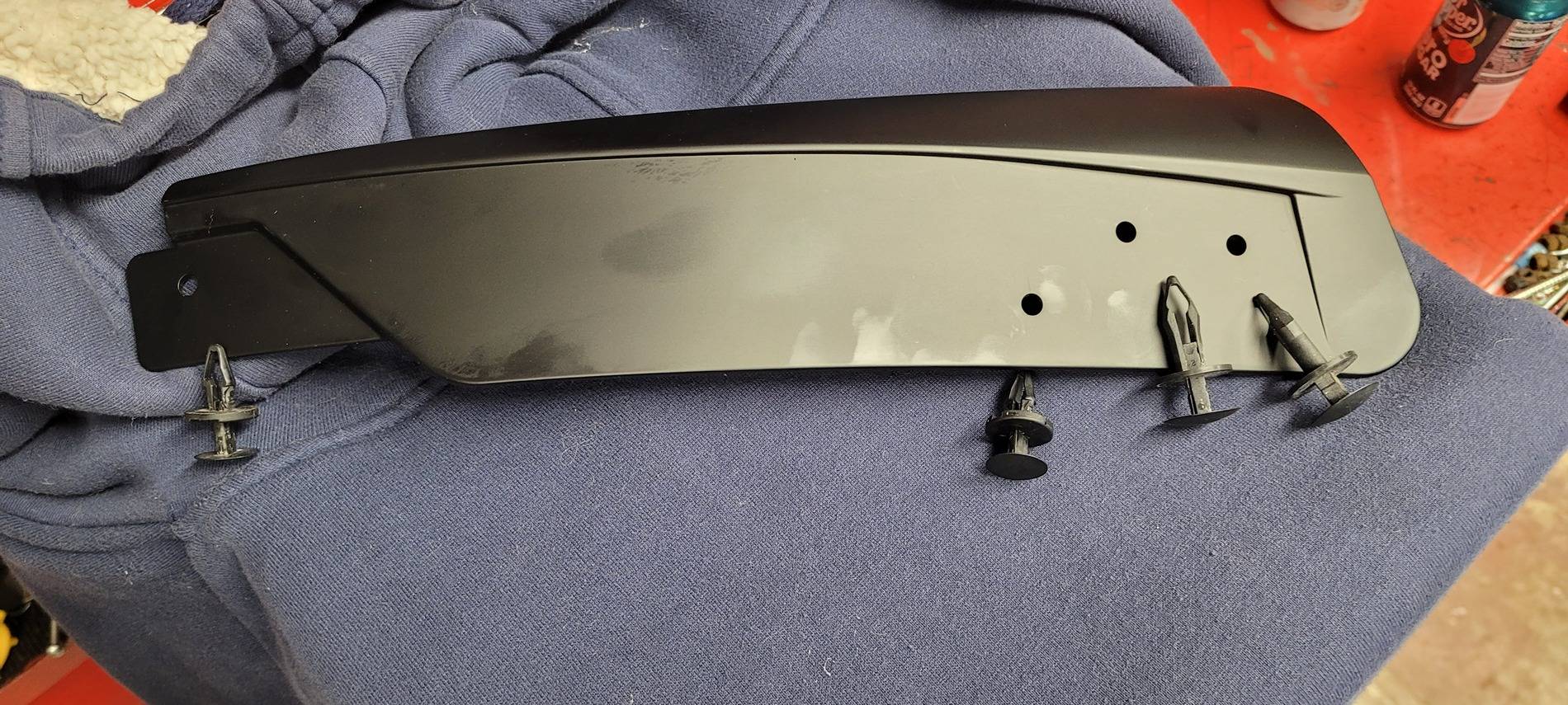

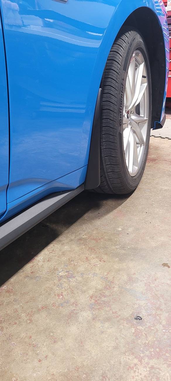

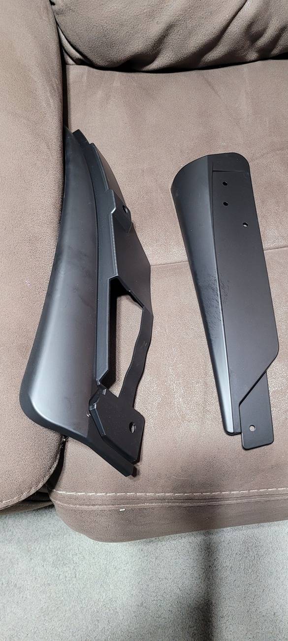

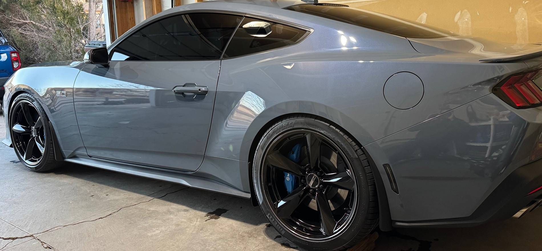

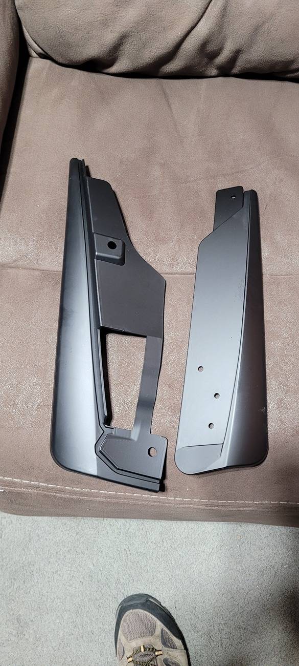

I installed them last night. There were no instructions. They say so on ebay so that was not a suprise.
They fit the body well and look as good as something like this can. They seem to be secured well. I do not plan to use scratch-o- matic so I will not be able to comment on that.

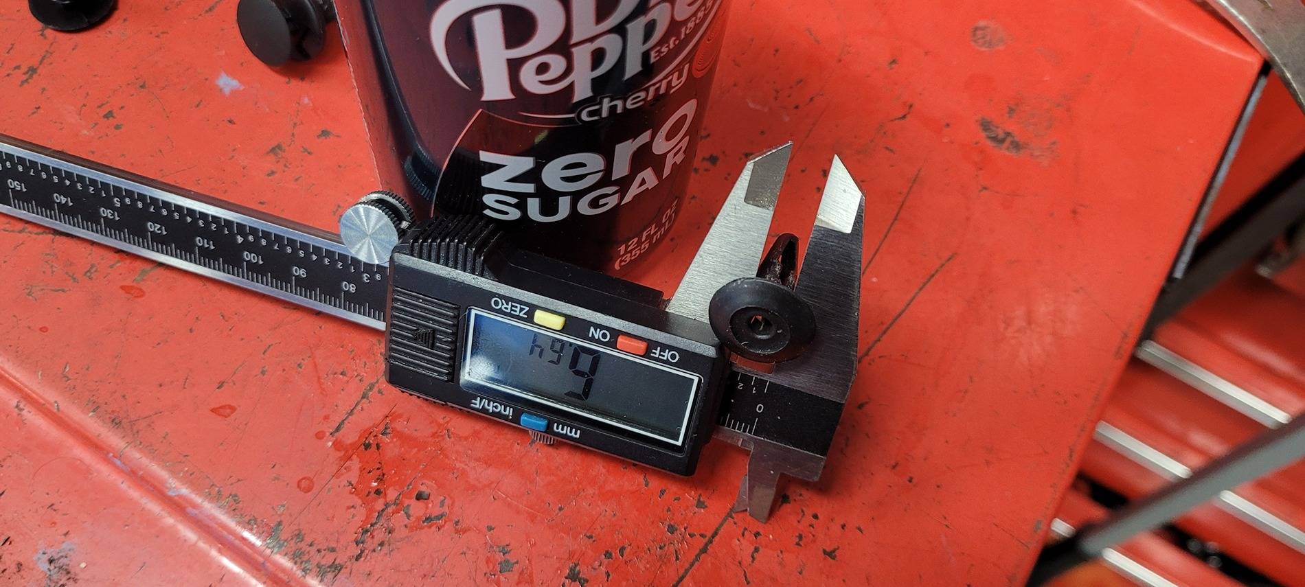

I had to drill out the lower 2 holes on the fronts to 9mm. I had to use a longer plastic rivet at the top hole on the front because the factory was only long enough for OE configuration. I also reamed the top holes to accomidate the slightly larger rivet i substituted.
The rears went on without any mods. I did not have to remove the wheels. I just turned the front wheels out of the way.
If i could change anything i would prefer they were maded from a softer plastic like ABS. These feel like polystyrene and that makes sense as that material holds paint very well overall I am satisfied with them for $130.

It came with 2-sided tape but I did not use it. I did not see a place that made sense to use it. They seem sturdy enough without.

Just tried installing...back went on fine, can't get the larger push pins in the front to reinstall...help?

Saw your comment about drilling the front lower holes out to 9mm...makes sense now. Gonna try that and finish install today. BTW, I did, in fact, use the 3M tape and it went on really well

Have them on order. Thanks for the post. What and where you get the bigger push pins from.

I bought a variety pack from Amazon for a different project. The Christmas tree push pins are great for pinning cardboard boxes together for forts and other kid projects.

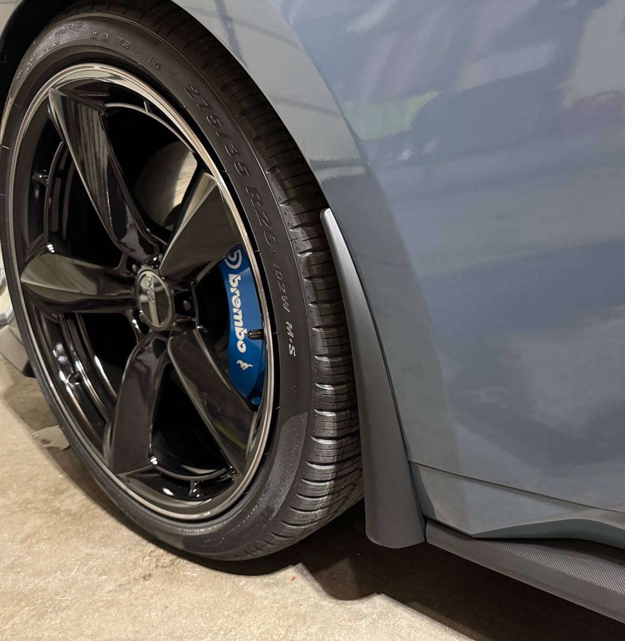

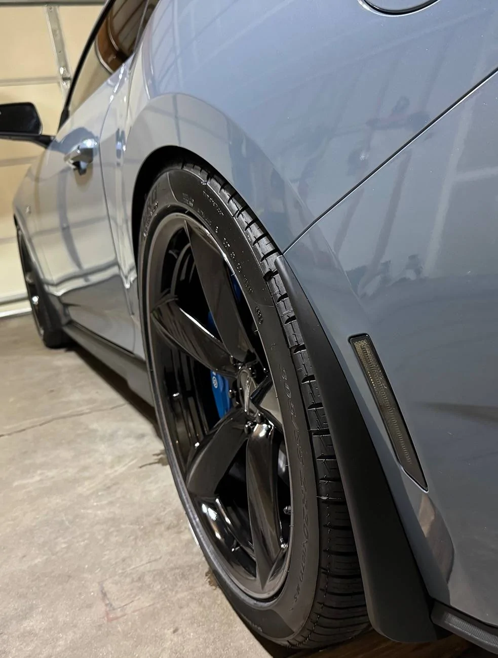

Well, I followed PBBLASTER and gave these a try and wanted to provide feedback.
I had the ZL1 Addons Deluxe prior to these. I thought the ZL1 Addons were fine, but I like these EOS splash guards better. In my opinion they look more integrated into the car, the mounting for the rear is better, and they offer more coverage for both front and rear.
Here are some pics.
