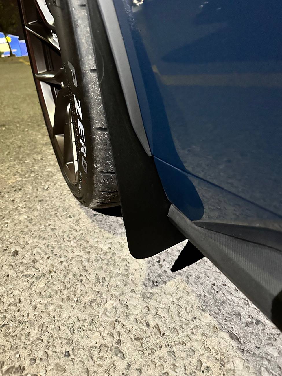

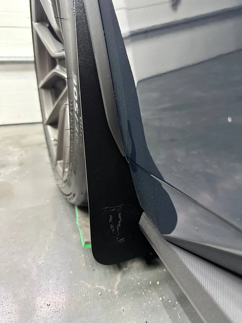

Does anyone know the mm size needed for the bolt to take of the rear fender guards on the DH handling pack? I need to get out all the rocks stuck between the fender and the pane in that area. So far none of the mm sizes that I have tried fit the bolt there.
2,715
4,122
looks like it's held on by a push clip and two 7mm bolts (4.2x25mm to be specific)

Thanks I'm going to get a 7 mm in the morning. Rocks are getting in-between them because my fender guards are not flushed at the top. There is too mush play at the top and it doesn’t stay put. It honestly needs a clamp or should have had another screw near the top.
