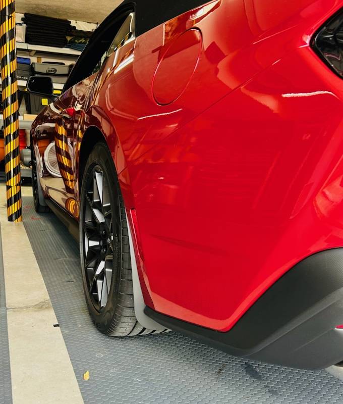

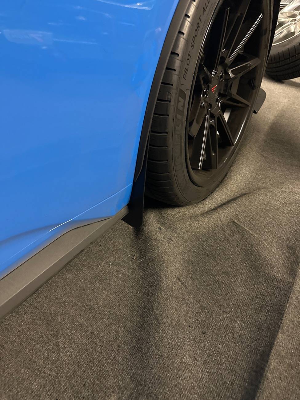

I just finished installing front & rear rock guards on my 2024 Dark Horse. Thought I’d share lessons learned.
1. Kit comes with everything except replacement push pins. So be careful removing stock ones or have some extras on hand. 2 different sizes for the front.
2. DH has moulded front wheel well trim. Can’t mount guards between it & fender due to the moulded lip on the trim. Was able to mount it over top of the trim. Seats pretty nicely. Looks ok. Not perfect but ok.
3. DH has a short piece of moulding on the rear. I removed it. It’s like a mini rock guard but the new ones are bigger. Fit nicely.
4. Turned front wheels to make room for installation. Removed rear wheels.
5. Need isopropyl to clean site inside fender for small support block to be mounted with 3M adhesive strip.

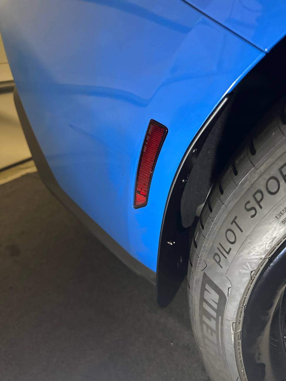

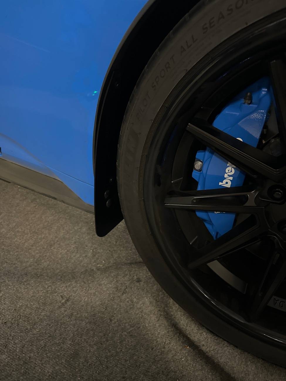

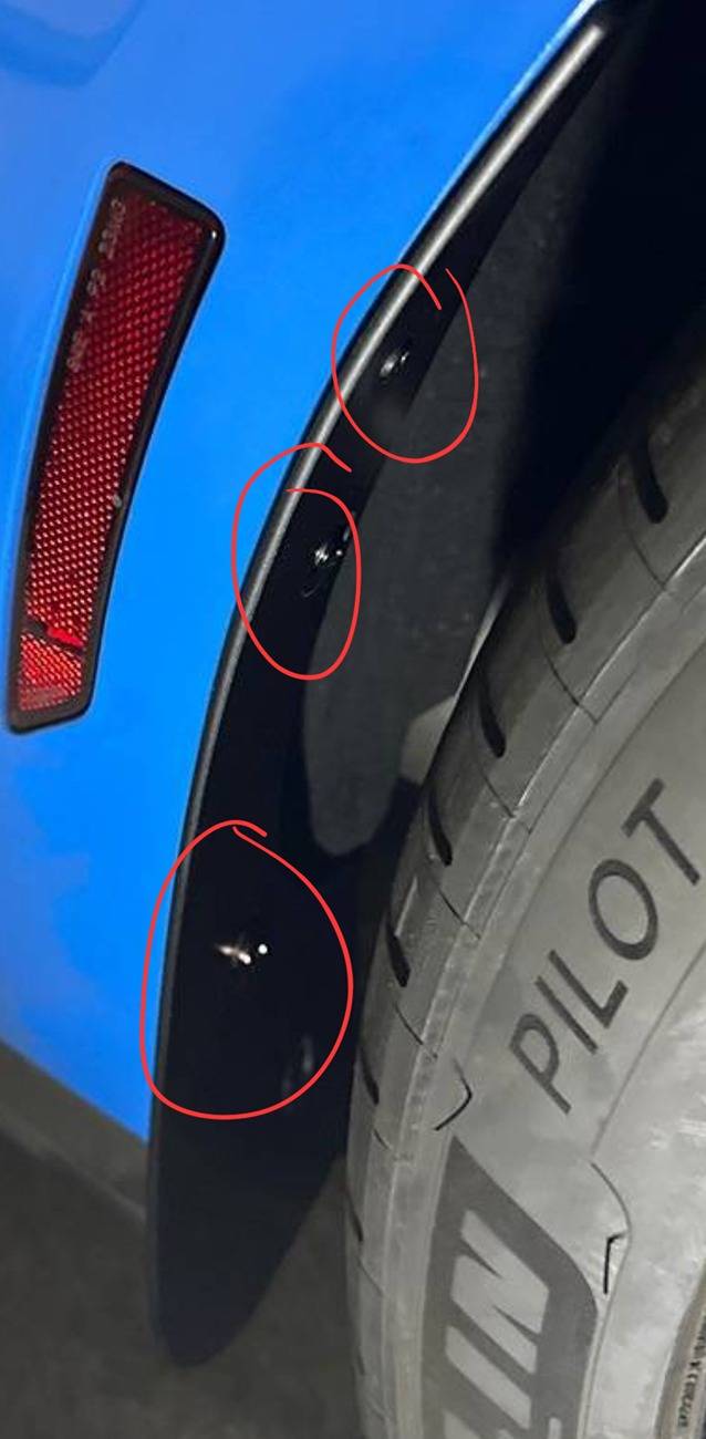

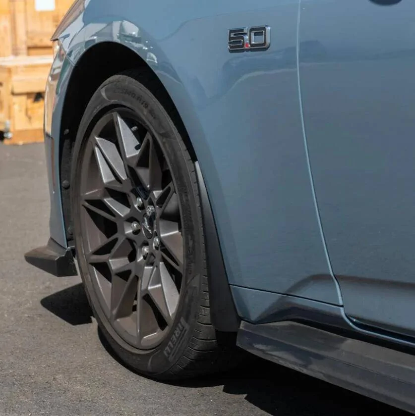

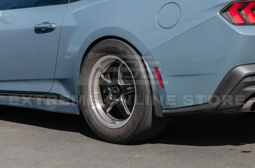

Nice. Today I ordered the ones from Extreme Online Shop.
I'm really curious on how it will look on mine.
I looked at the ZL1 ones but I find the rear one sticking out from below too much.
Also the chrome pins are also something that stand out, that bothers me.
I wanted the smallest looking guards, but still effective enough to do the job.

Those look good. I hadn’t considered the length issue. Hope it doesn’t start to bug me or I’ll have to change them. 😂 It never ends!

chrome pins? I have ZL1 addons and have no clue about anything chrome.

2 of Those are the machine screws that come with the kit. They are silver - zinc plated I think. I colored them black with the Sharpie that I used to mark the support block that mounts inside the fender to hold the top screw that is provided (black)

Those aren’t chrome lol. I swear mine are black but even if you can’t even see the screw head unless bent down on the ground. I mean if that’s your hang up first world problems lol

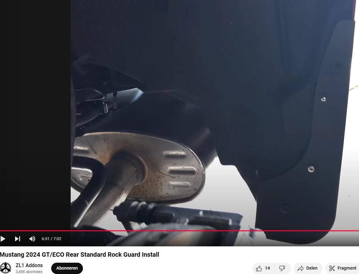

Well, the company posted a video where I can see the chrome screw.
lol. Still not chrome. You must not know what chrome is. But that’s with the wheel off. If that’s your hang up then you do you

So you had the same idea as me haha. Yeah, making them black is a good way to solve it. Or black screws.
