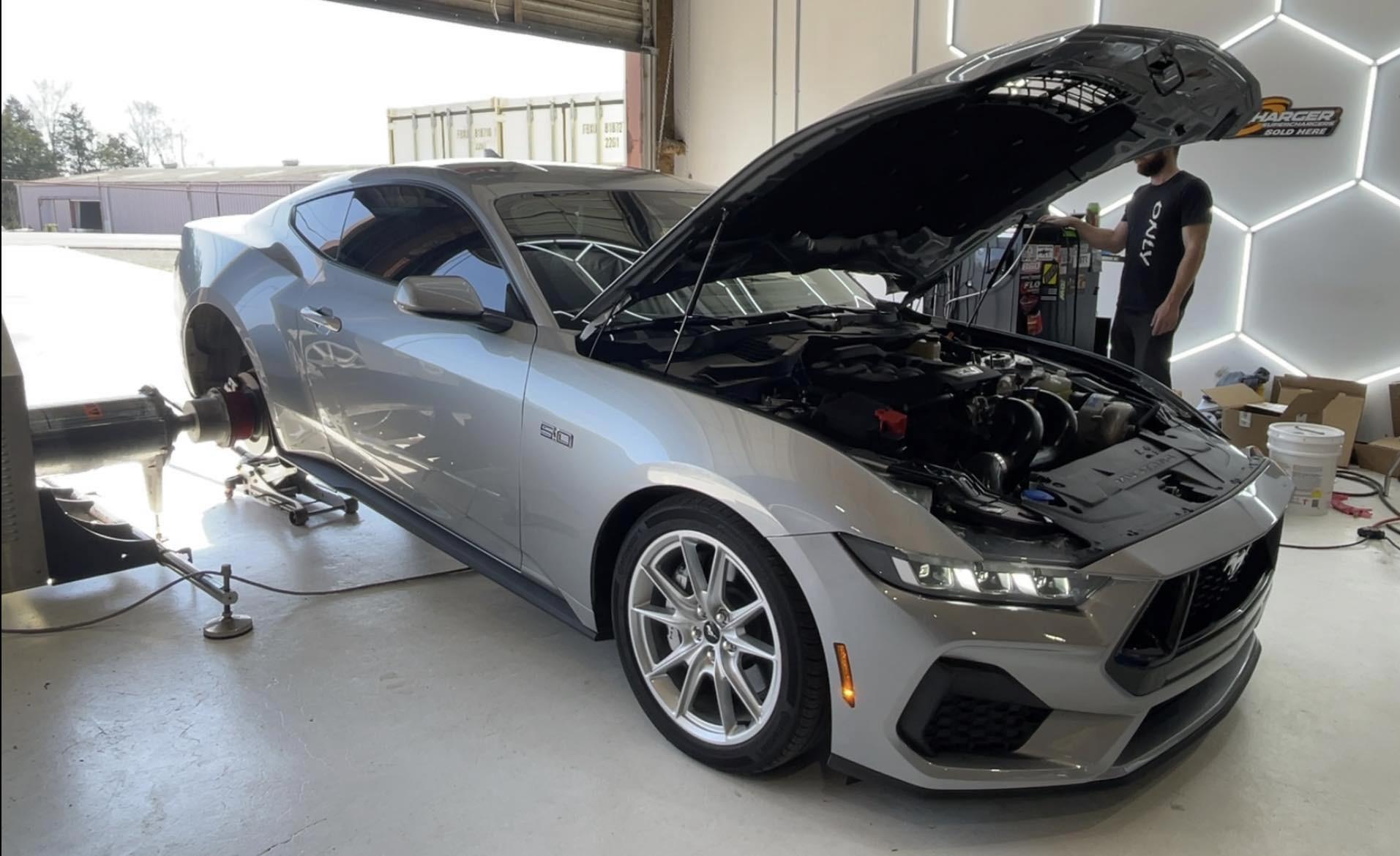

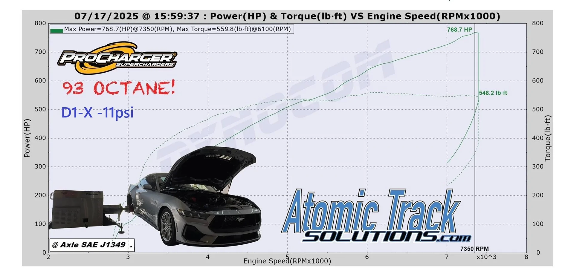

I drove it 400 miles round trip to Ponies in the Smokies. Did great. Then I put it on the dyno and I’ve been doing some playing when I get time. Made solid power for only 8 psi with the stock calibration and some C16 thrown in for safety. Running out of fuel/going lean and haven’t had time to try my next idea. Hopefully have an update with a real power soon. So far, VERY comparable power at 8psi VS other options currently that have tuning and more boost!
