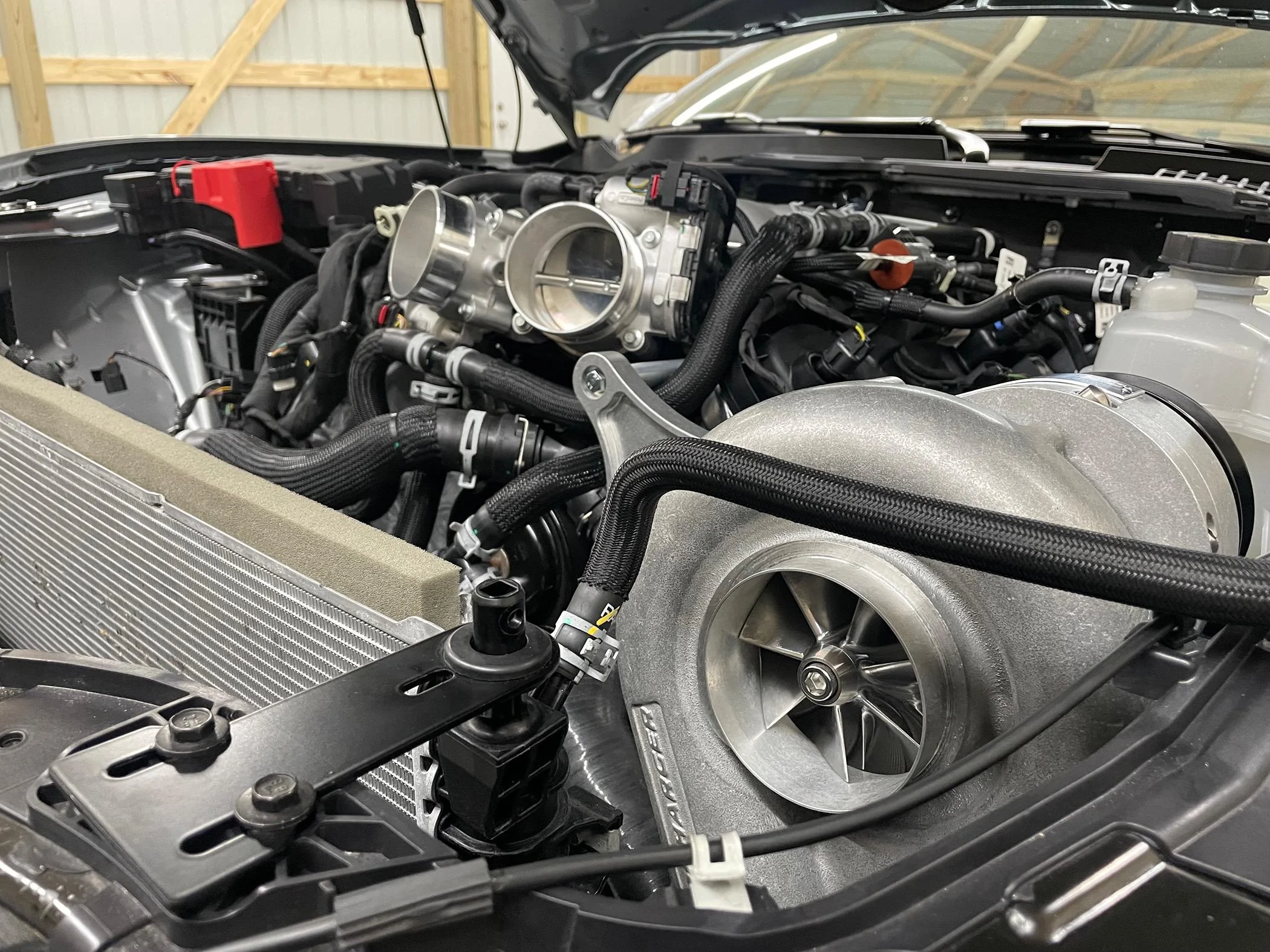

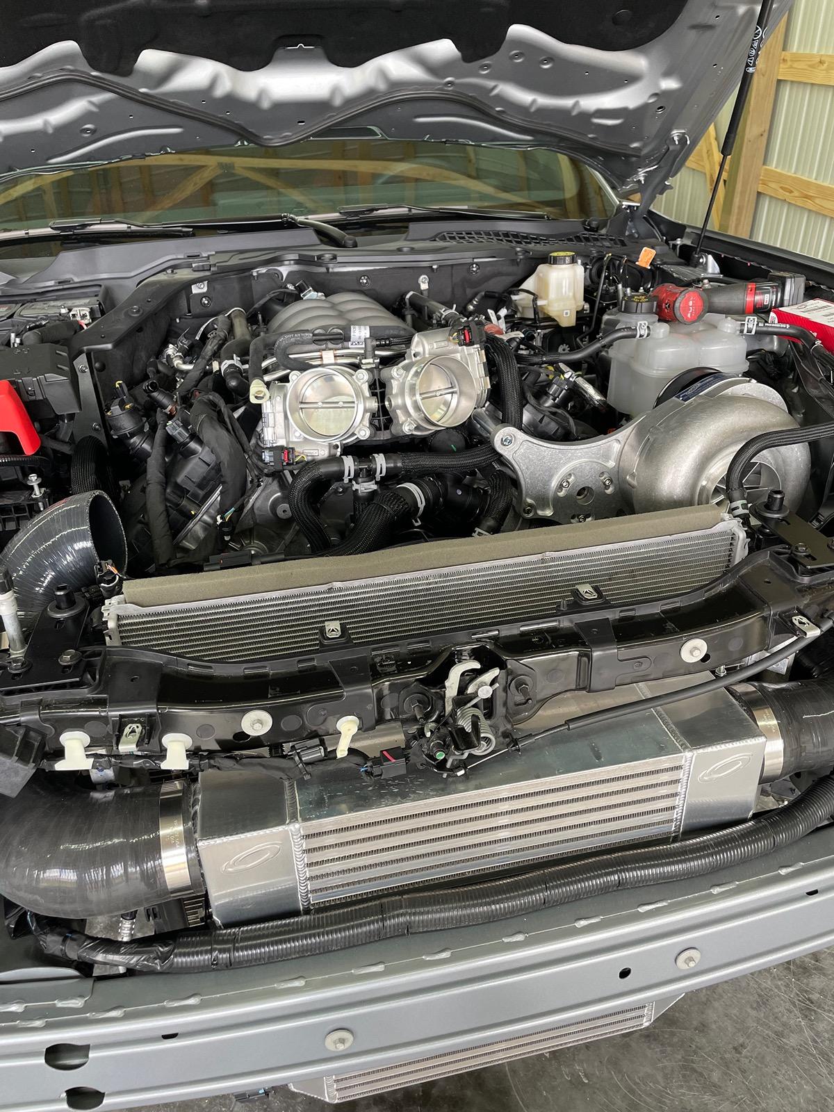

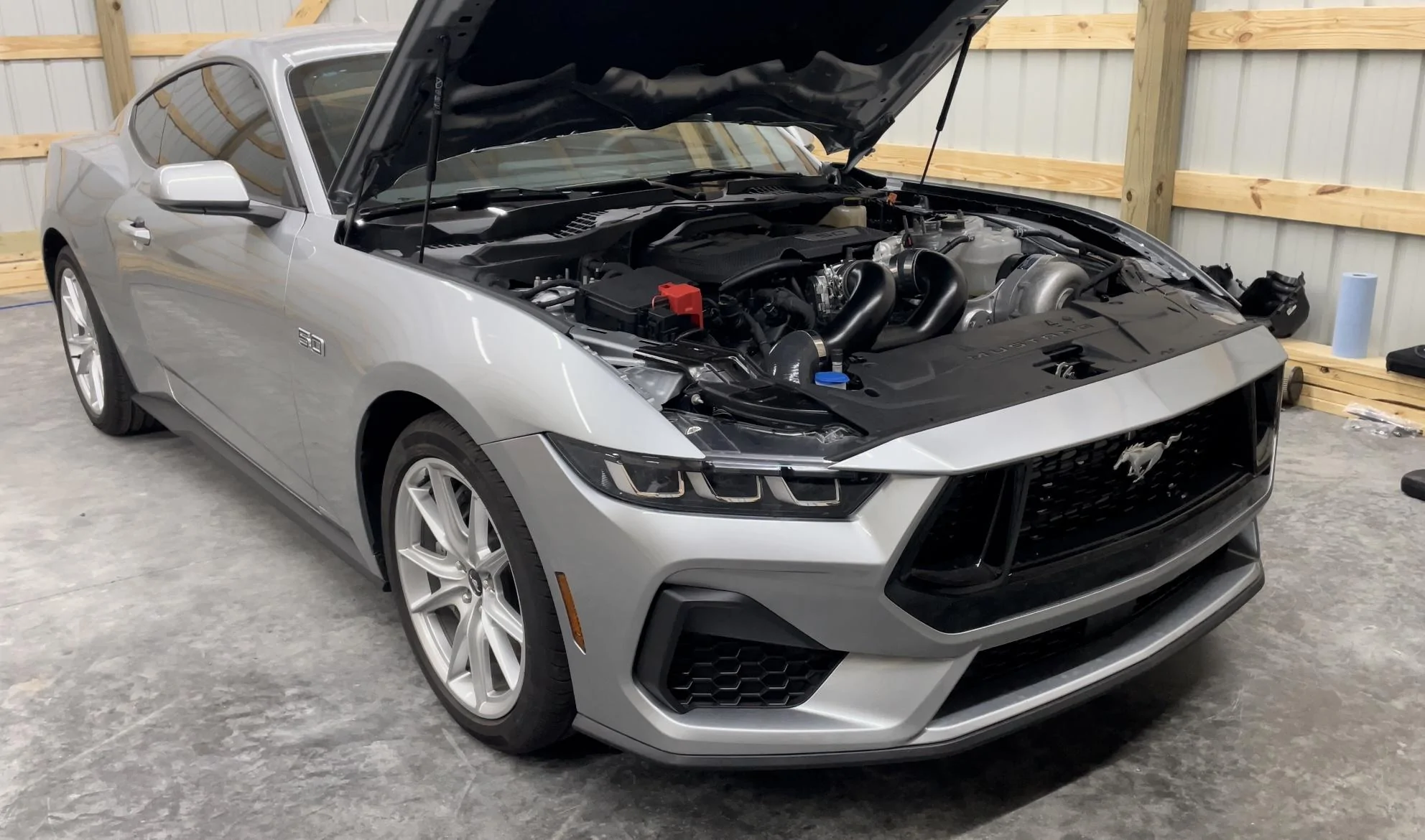

Got a little more done yesterday evening! Hoping to have it fired up by the weekend! Ponies in the Smokies is this coming week, and if nothing else, I’d love to get out that way with the car. Definitely won’t have the tuning or stuff I want to try done yet, but I’m expecting to be able to roll around to some of the spots, and hang out at Knoxville Dragstrip on Thursday.
S650 Mustang Someone say… ProCharger S650 GT? IMG_3817

Is the mounting bracelet redesigned from S550?
Awesome BTW… can’t wait for performance metrics
I believe all the blowers will now use the same bracket as this one/keep the blower inlet facing forward. I’ll talk with them Monday as I have a list of good questions including that one, and will report back!
