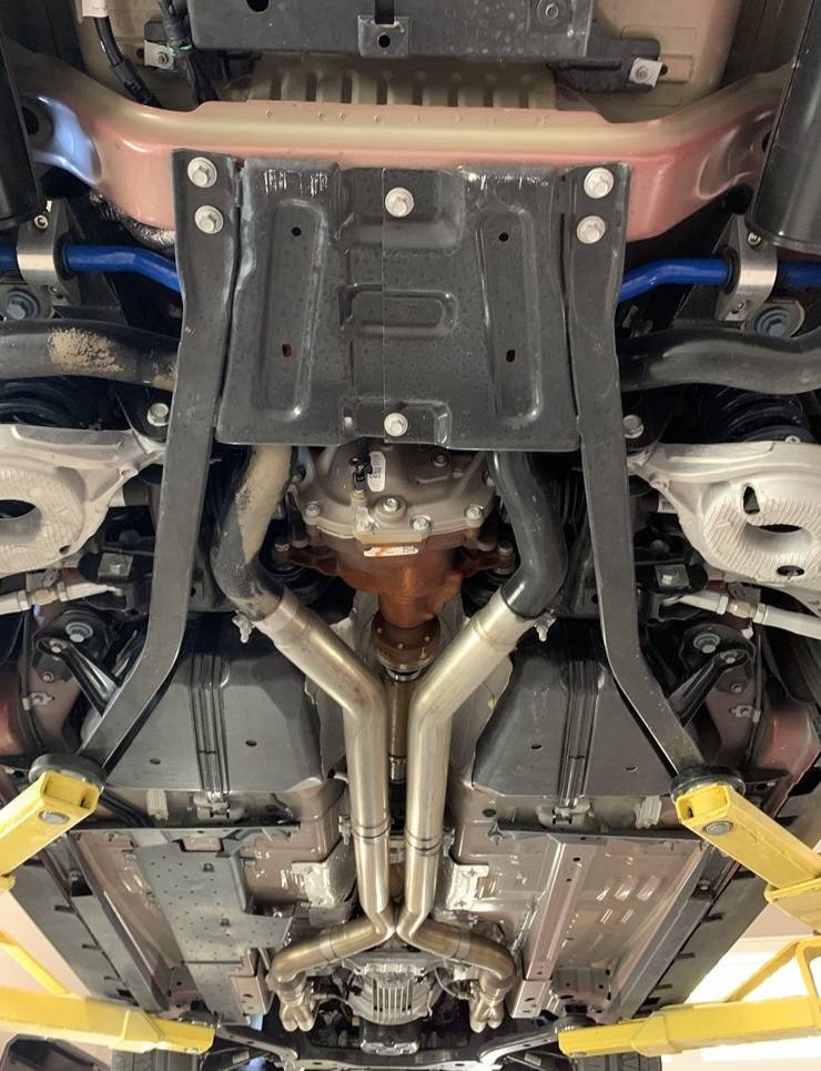

@MAT1955
What BMR had to say about those braces (which rust out like yours did and most people ended up just throwing them in the trash so they didn't have to take them off to work on the rear of the car):
I do not have the engineering or "scientific" data to back up my thoughts on this.
But, I have always had a very hard time accepting that the OE braces do much of anything.
1: They are not very strong.
2: They are bolted on via weak hardware.
3: Where they attach to, the sump/tire well is a very weak area.
4: If torsional rigidity is the purpose - I fail to see how they are effective when they span from the outboard subframe area and mount inboard close together. When we design a chassis stiffening part, especially for something like this particular part, we would want it to spread wide and triangulate together. When you mount a "brace" to an area of the car you want more rigid, why would you mount the two individual pieces so close together?
As you will see in the picture above of the aftermarket braces - look how narrow. Would the chassis not easily be able to "roll" or "pivot" around those "braces"?
A lot like those useless bolt-in subframes some SN95 cars had.

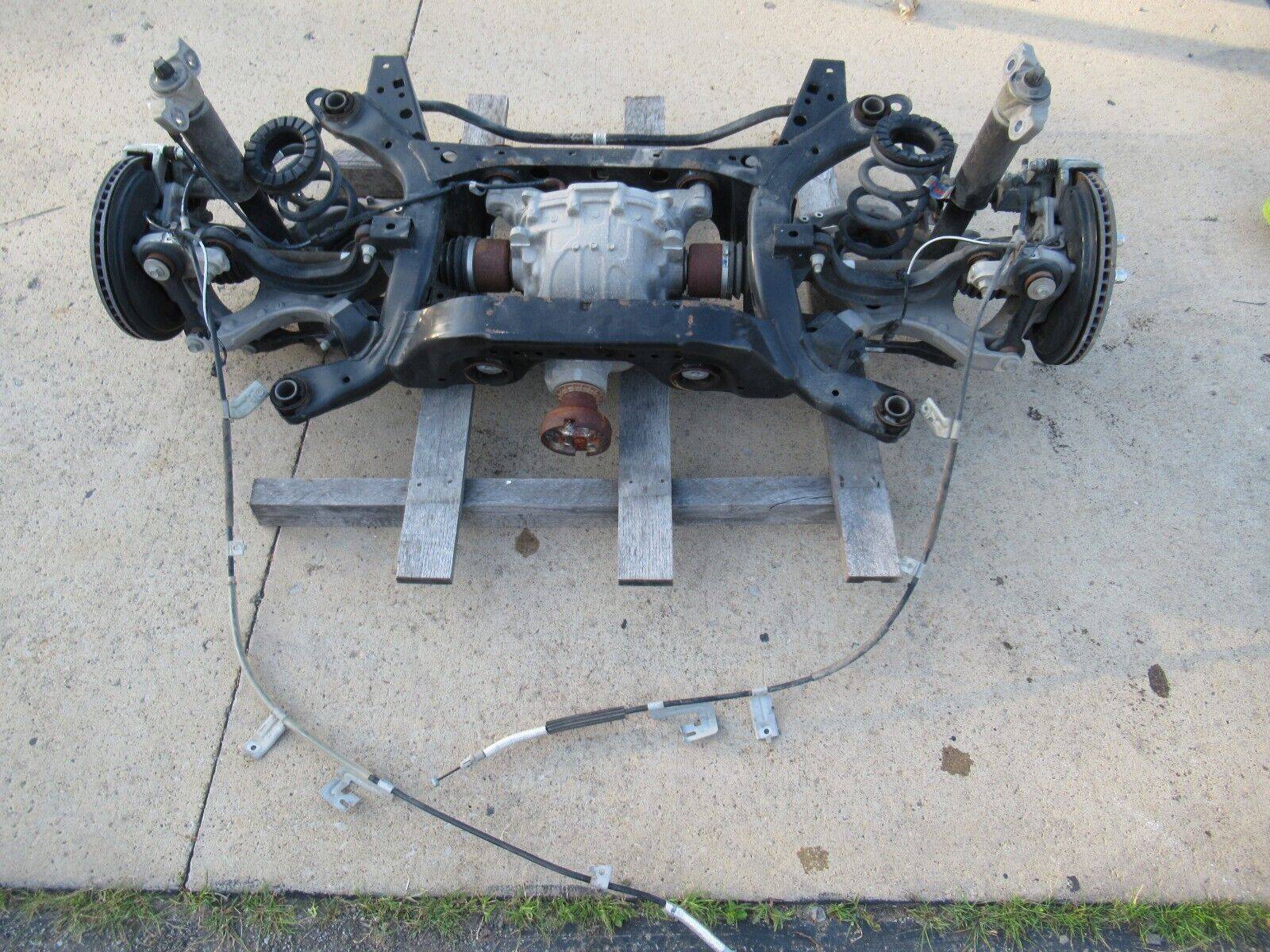

What exactly is the rear subframe? Obviously to stiffen the chassis but is this tubular?
1,393
1,162
It's the stamped piece above the IRS in this picture. It bolts into the cars body. The aftermarket makes stiffer bushing and braces to tie it into the body better.
S650 Mustang So why does my S650 GT not handle as well as my S550 GT? s-l1600
Appreciate the picture, thank you.
