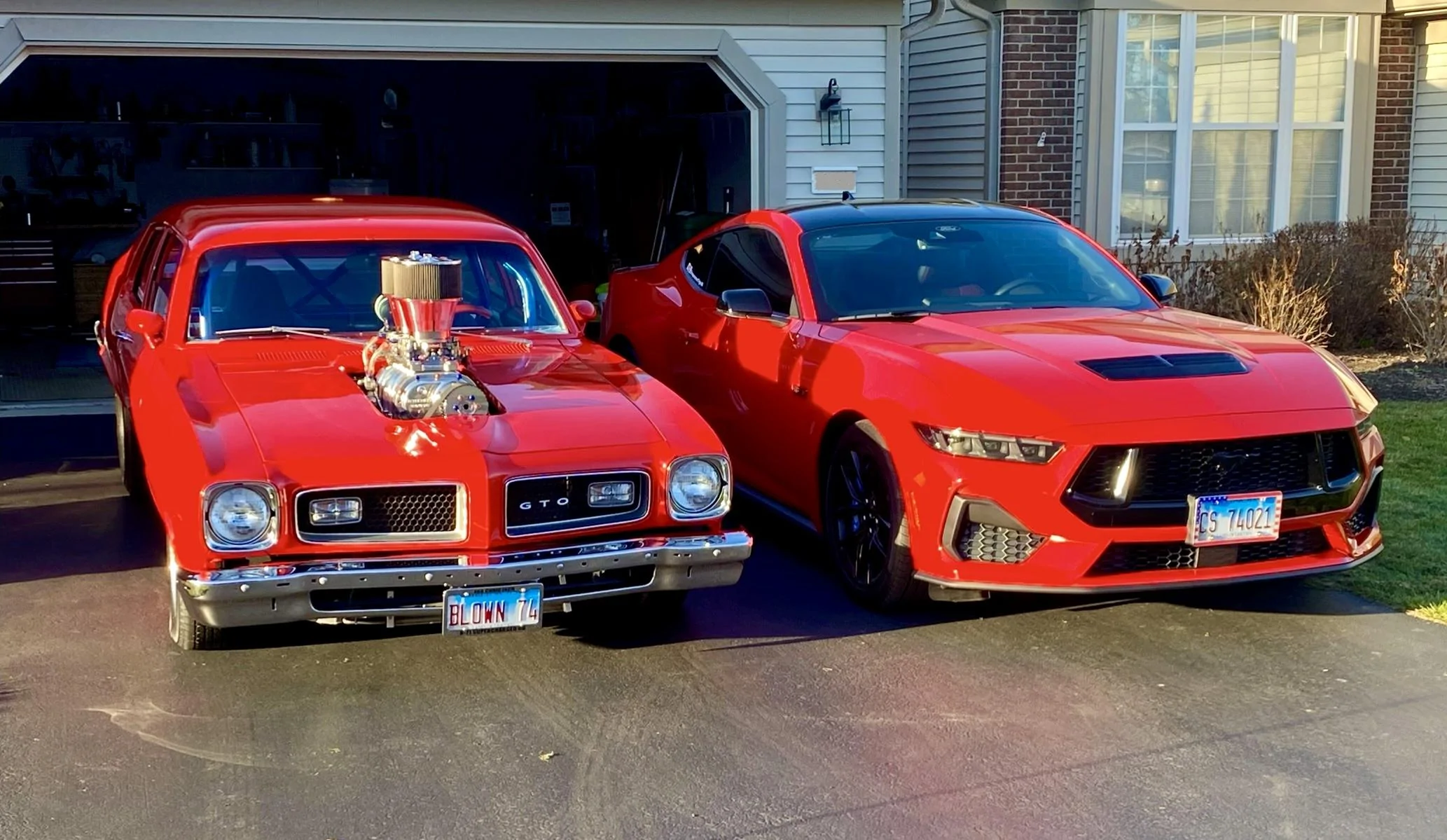

I’ve been pondering and researching this exact question. First and foremost, if you drive aggressively your whole drivetrain is under much more stress with FI. If you plan on doing digs…launching hard, then the half shafts and possibly driveshaft are at risk (ESPECIALLY with manual trans). Clutch and manual trans are also at greater risk doing digs. If you limit yourself to rolling sends, you have less to worry about. On street tires, you are far less likely to pop a half shaft under any conditions, sticky tires create more of a threat. I personally will seriously consider upgrading half shafts for peace of mind even tho I have the 10-speed and will run street tires. I also have a pro street car with 8-71 blown big block that I’ve street driven for 26 years so I’m no stranger to FI lol Tire spin is frustrating, annoying and destroys tires, but is a blessing for protecting the drivetrain.
