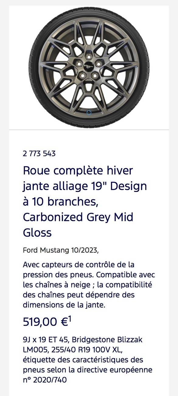

Hey, i’m driving to Switzerland in my DH to do some snowboarding in February and wanted to prepare snow chains just in case if i needed some.
Have you guys had any experience with that? What chains did you buy? What do i have to be on the lookout for?
Also these are the tires and rims i’m running.
Thankss!
S650 Mustang Snow chains IMG_7917

If those tires are the standard summer tires for the Dark Horse, get some snow tires and swap them. You will have no grip at all with the summer tires.
And as far as weight in the trunk. I never found any need to do that. Good tires are enough.
Plus IF you do have an incident, that weight isn't going to just sit there. It will continue to move and the seat backs will simply fold down as the weight comes through - and it will conveniently be stopped though when it connects with the back of your head.

The blizzaks are a winter tyre. I put them on my merc during winter last year and they’ve recently gone back on for this winter. They are a really nice tyre although it hasn’t snowed in my parts for over a year so I haven’t tested the snow grip. They are highly rated.
If you wanted to go chains I’d find a narrow tyre as wheel well clearance on stock tyre isn’t that great and last thing you’d want is the chains eating the car.
For those championing 4x4’s they only help you get going (and probably faster) they are limited help in steering and do nothing for braking.
Full winters and even Nordic winter tyres make a massive difference to all 3 compared to American all seasons (3 season really) and summer tyres that won’t even get off your driveway

Nah, everything went suuuper good. The snow tires were enough!
