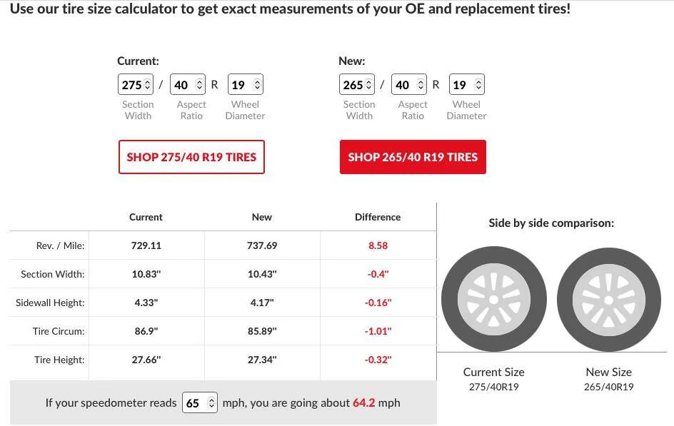

Here are the differences between what you have now and what you want to put on. The differences are not that great.
