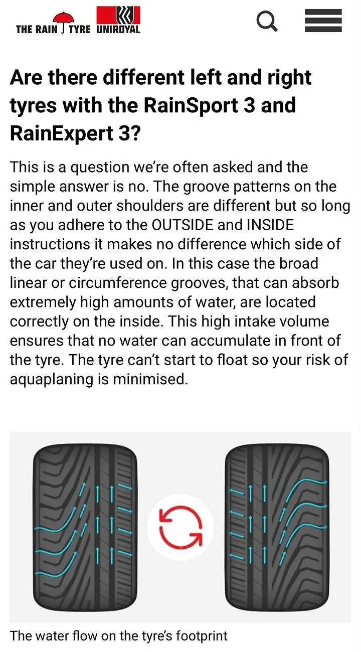

I don't believe the stock Pirelli tires on my car are directional as I don't see any arrows indicating that on the tires.
I'm not familiar with the Pirellis. Some brands continue to use arrows. Others, if directional, will have the words "inside" or "outside" somewhere along the sidewall, the "outside" being street-side.
If a staggered setup, moving from side-to-side would provide zero benefit. In your situation, I'd do what others with staggered setups do: leave them where they are at.
While the tires cannot be rotated, the mechanics could be asked to re-torque the lugs. Using a torque wrench, not an impact gun set to the highest setting. And, confirm air pressures.
It would be a good practice to check the tread depth every so often with a gauge, all tires, to confirm they are wearing as expected. I check mine once a quarter with a Milton tread depth gauge.
