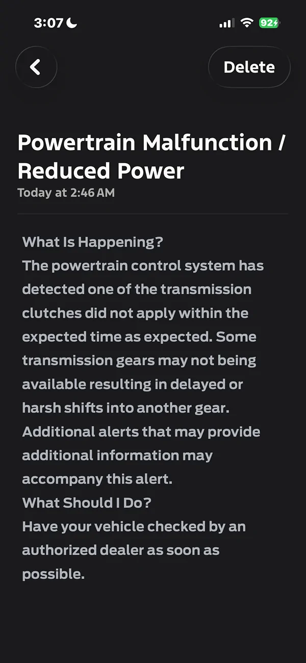

Yesterday afternoon after I got out of work I drove home and the transmission on my car felt rough when shifting. So earlier today I went on the ford app and got this notification that my transmission might be fucked. Car is a 2025 Mustang gt with 35k miles. Hopefully it’s covered under warranty.

Your are still under warranty, take it to your dealer and get the answers you need!
1,763
2,772
≈39N
The bumper-to-bumper warranty is 3Y, 36,000 mi / 57,600 km.
The powertrain warranty is 5Y, 60,000 mi / 96,000 km.
Automatics are complicated. Could be something simple, like a stuck valve in the valve body, a solenoid needing replacement or low fluid. Transmissions are ocasionally found a quart or more down from the factory. Could be something more significant.
I'd drive it as little as possible before taking to the dealer. If you do drive it, drive it lightly.
The dealer will open a ticket. If repairs are involved, that date and mileage will be the reference for the warranty.
Good Luck. :please: Let us know what you find out.

You are not screwed yet, but someone has a rubber and a tube of K-Y out and is looking for you.
Unfortunately the transmissions are the weak points in these cars
Get it to a dealer, let them diagnose it and determine how it is going to be fixed.
Is it shifting funny? Can you put it thru the gears manually?
There are so many things that go on it an automatic transmission between computers, programming, electrical inside the unit, fluid pathways in the valve body and into the various clutches and accumulators it is hard to even guess what is going on in there.
“..did not apply within the expected time as expected.”
“Some transmission gears may not being available resulting in delayed or
harsh shifts into another gear.”
if as broken as the english then possibly… who’s writing these alerts?

@Zig - To your point........"expected time as expected"............ Pretty sure this was written at/by Ford's "Department of Redundancy Department".
Let me fix that for you Ford - did not apply within the expected timeframe

Quick update: I took the car in today to ford and the whole transmission is being replaced
The other one is actually the one that snagged me first: ‘may not being’, Say what? I suspect they either meant:
“Some transmission gears may not be available resulting in delayed or
Or
“Some transmission gears not being available may result in delayed or
but either way, not exactly the confidence builder regarding the whole concept of smart app.
3,875
5,462
Well, that sucks but at least its under warranty. And Id rather have a new transmission than a rebuild.
Did you have any symptoms prior to this message? How has the transmission been up until now?
