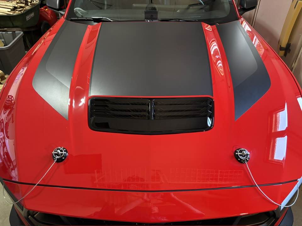

I wouldn't want the lanyards rubbing on the paint. Some cars have a chrome trim where they would rub. The MY2024-25 doesn't. The pins really do not need to be captive. Also be thoughtful of the hood being aluminum and hardware used so galvanic corrosion doesn't occur.
Apr 18, 2025
Little Britain
2024 Mustang Dark Horse
I don't find that the lanyards bother the paint... they are covered with thick plastic sheath, and they tend to stand straight up off the body panels at speed.
