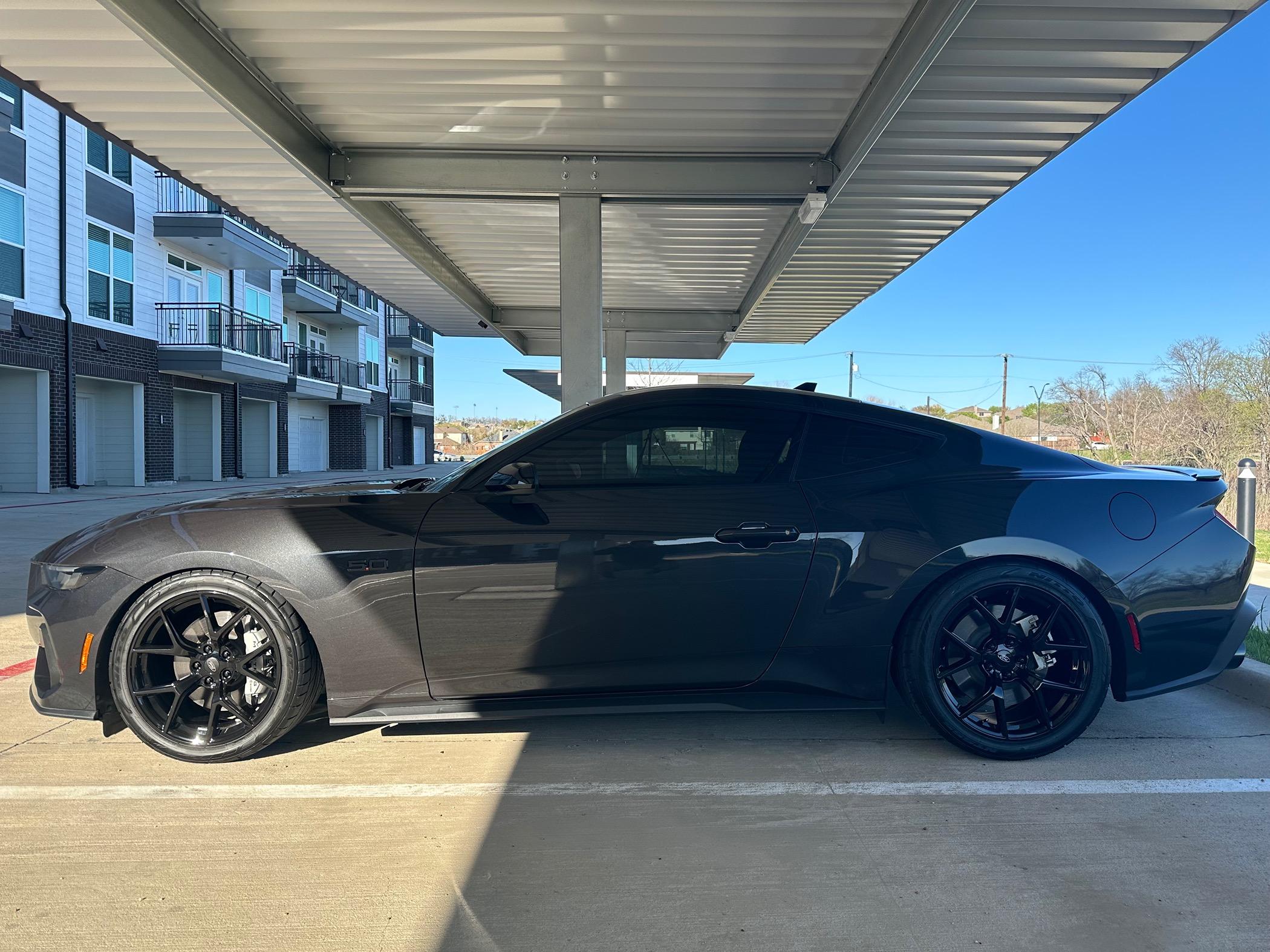

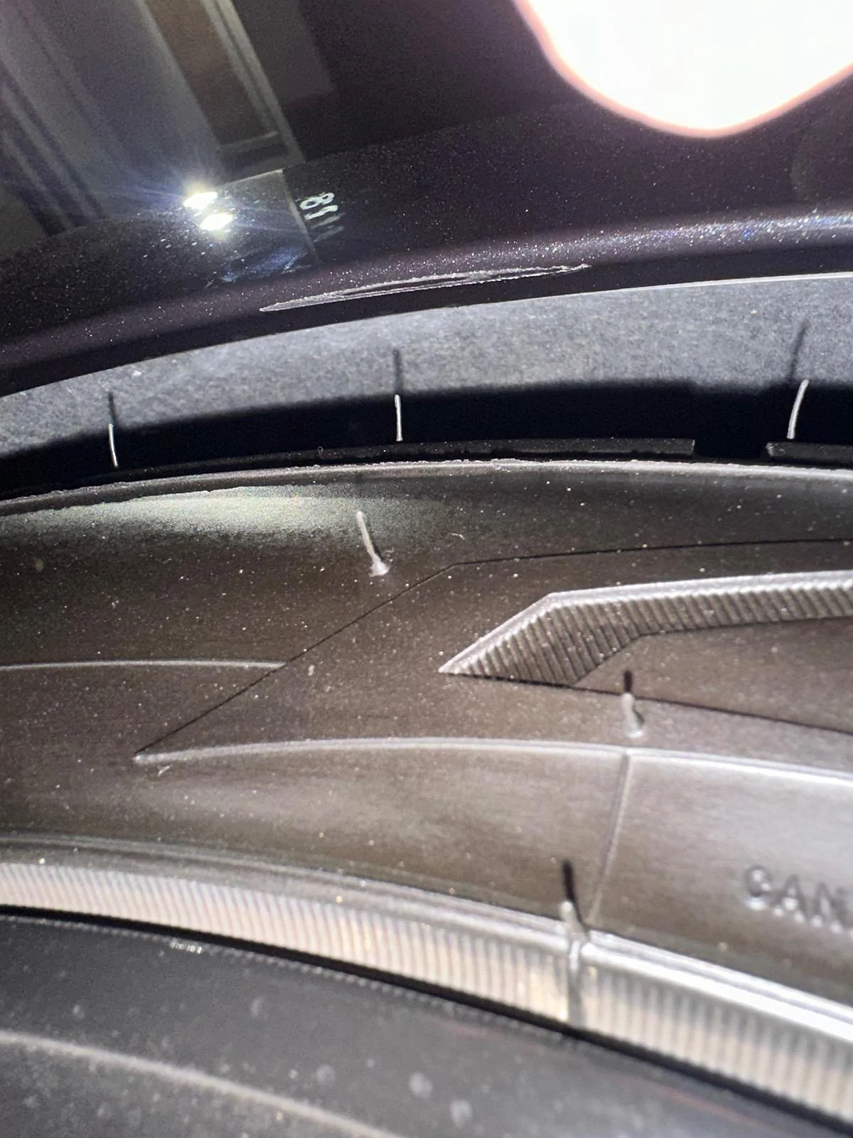

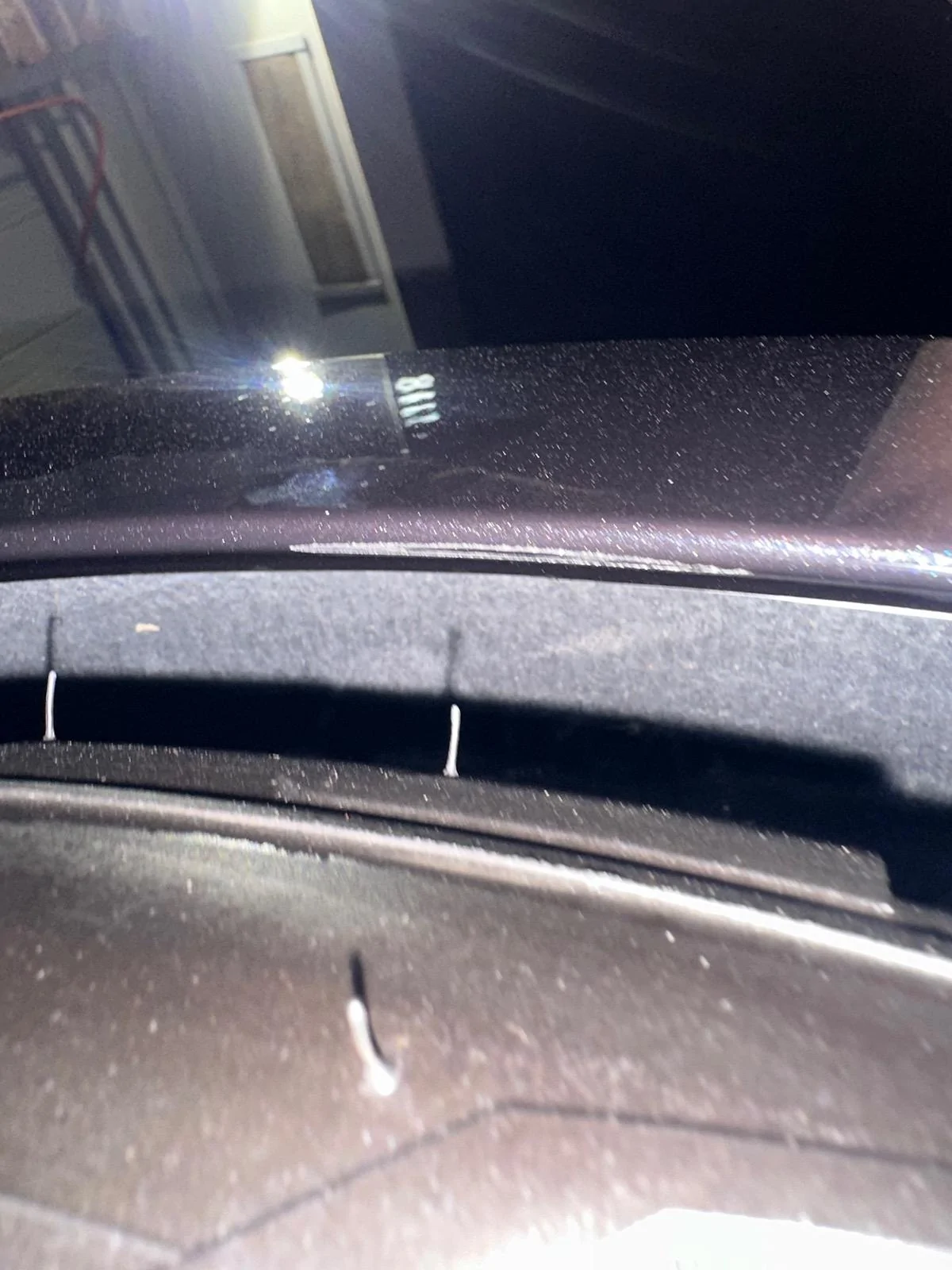

Hey everyone, I want to know if anyone has had issues with rubbing on their S650 if you’ve installed the Steeda sport progressive springs? I’m only rubbing on the front driver side, and only noticed it because it rubbed off some of the PPF I had just put on this past weekend. I have SVE SP2’s on 285/35/19’s in the front. Haven’t noticed any rubbing on the passenger side. Not sure if maybe I went too quick on a certain street that has some random dips when I drove it yesterday because I know I heard some scraping of the rubber guards. I’ve had the springs on for a month or so and first time I’ve noticed this issue. Just want to see if this could have been caused by that or should I get some Steeda front spacers to raise the car a bit?

I only rubbed in the front driver side maybe once and not sure if it kept rubbing when I tried testing it with some tape. I switched springs now and I did get Steeda’s IRS subframe alignment kit installed this time but never had any issues in the rear with rubbing
