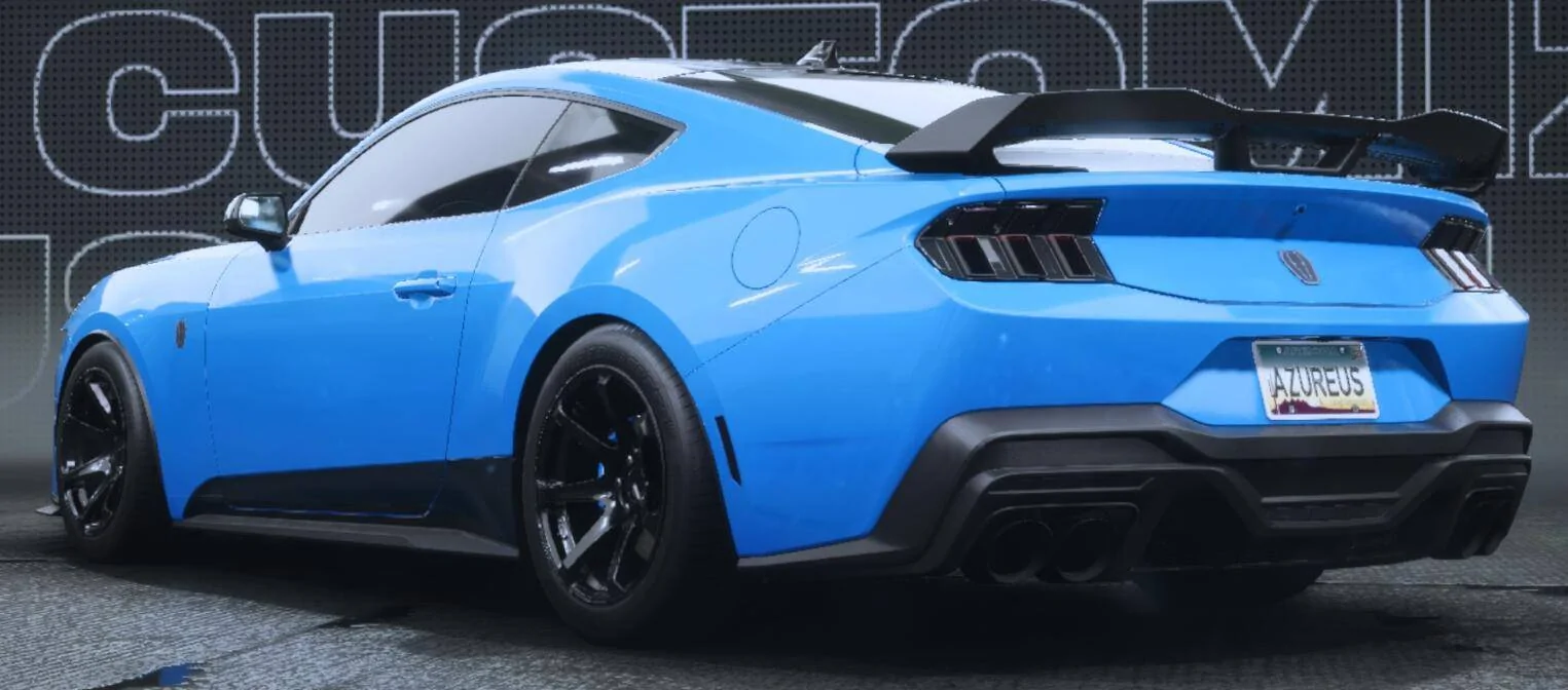

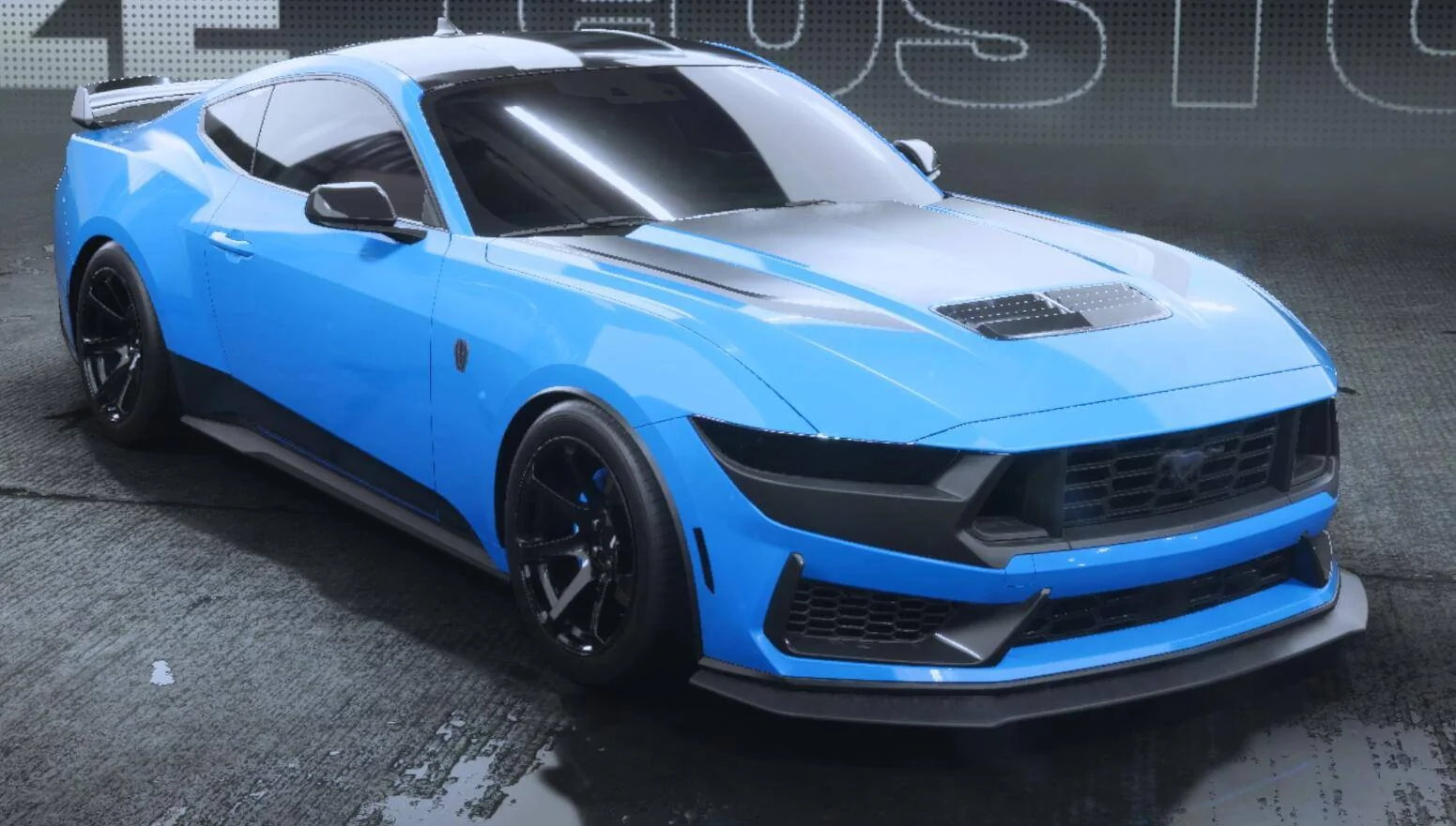

i guess Need For Speed Unbound added the Dark Horse a bit ago.
you know what i had to do
S650 Mustang roket's Dark Horse - "Azureus" Project 1741602895286-z6
S650 Mustang roket's Dark Horse - "Azureus" Project 1741602969109-js
its not 100% perfect and for some reason you cant remove the stock hood vinlys, but its close enough for me to be happy

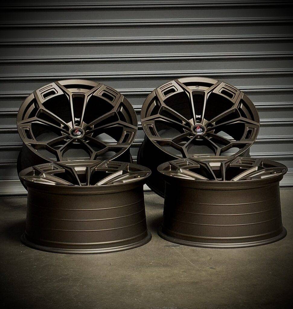

These ones? I don’t want to buy new wheels... but those are sharp... hmmm.
What sizes are they available in? Thinking 20x11 and 20x10...

they have these sizes:
DimensionsOffsetFront or Rear
19x10"+35mmFront and Rear
19x11"+24mmFront
19x11"+50mmRear
19x11.5"+56mmRear
20x10"+35mmFront and Rear
20x11"+14mm, +24mmFront
20x11"+50mmRear
20x11.5"+56mmRear
20x11.5"+43mmRear

Looks like they have all the good sizes... the 20x11 +14 and 20x11.5 +43 look a bit odd though, perhaps a wide body (GTD) spec? I need to quit lookin at them...

those are listed as GT500 spec wheels, because it has a widebody and comes factory with a 20x11" square setup

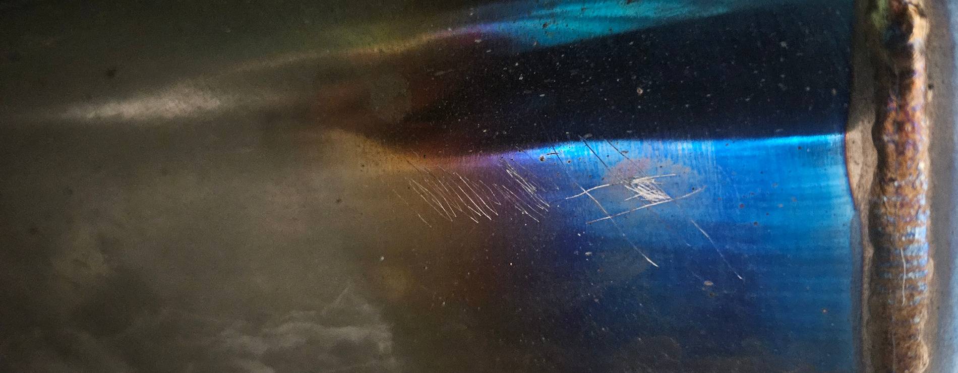

my "titanium" exhaust might actually be aluminum. i just checked with my Moh's hardness picks and it scratched from the level 4 pick
S650 Mustang roket's Dark Horse - "Azureus" Project 1743660610272-db
i dont understand why they put so much work into faking it so well

so, i was so wrong here. i dont know how it got scratched, but i did the grinding test today. it sparked white like titanium should. still gonna be replacing it due to pretty poor fitment. the exhaust tips refuse to stay aligned. plus, im not a fan of the overall tone

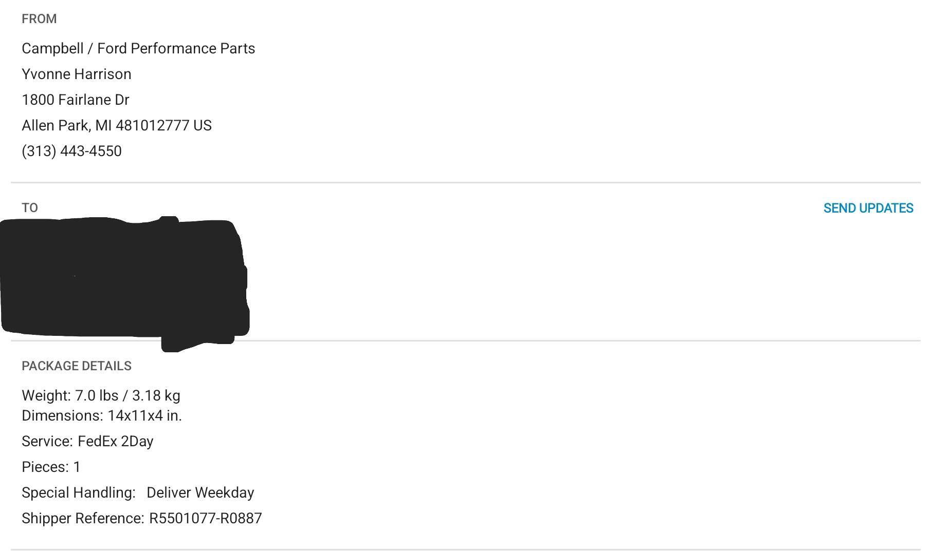

huh? whats this?
S650 Mustang roket's Dark Horse - "Azureus" Project 1000012277
that reference number is the last 8 of my VIN and my chassis number

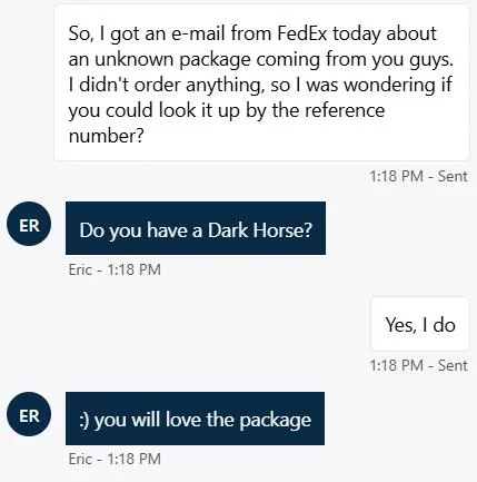

got in contact with someone from Ford Performance. its an owners kit!

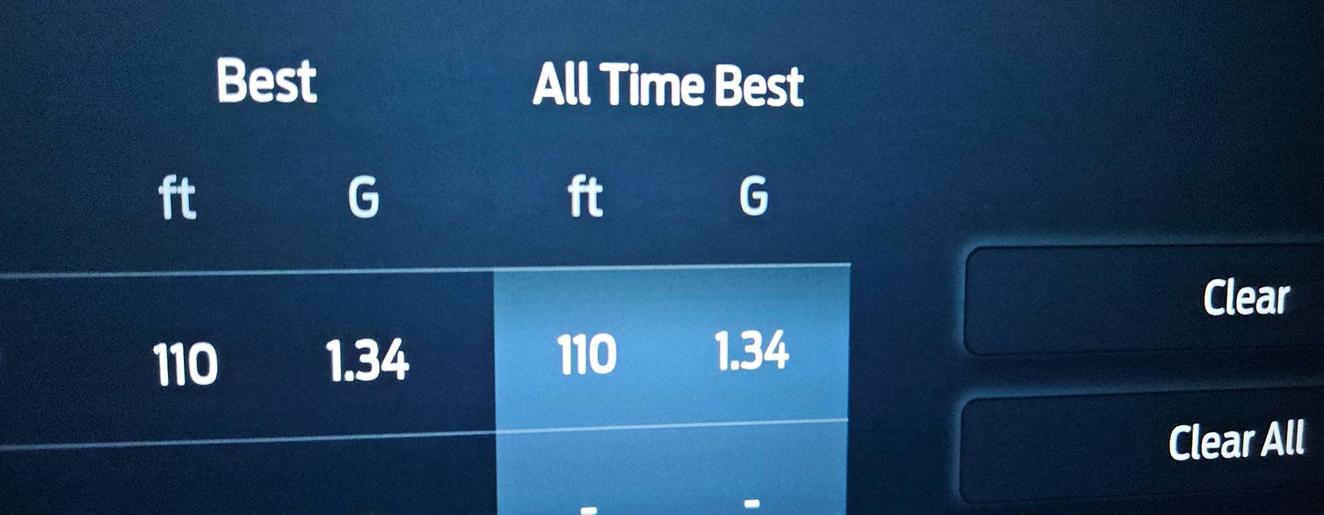

yesterday i installed the Powerstop Z26 brake pads, and here is the 60 to zero test. this was on a road that was sealed a couple weeks ago
S650 Mustang roket's Dark Horse - "Azureus" Project 1746283597338-t8
