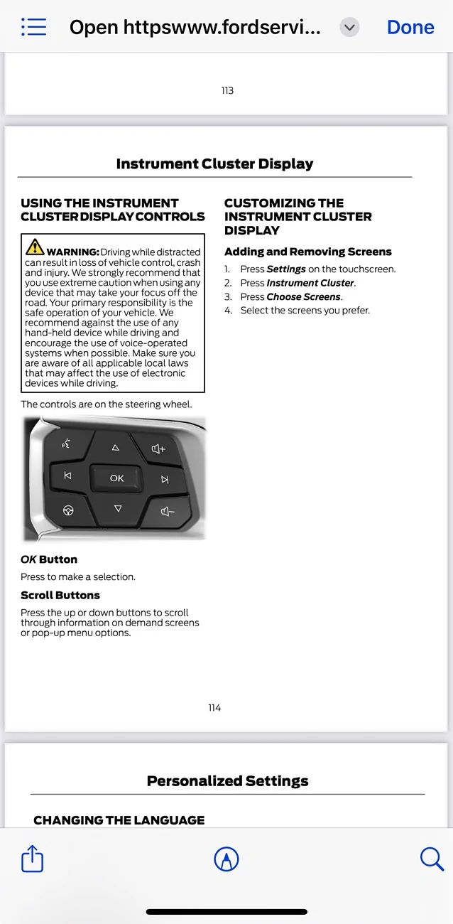

went through the owners manual. did not see anything regarding resetting TPMS

I also never saw anything in the Owners Manual either about resetting TPMS. Though it is commonly said they relearn themselves with no action needed. I think somewhere in this forum I read of a procedure that doesn’t require a TPMS learning tool. Haven't taken the time to search it.
I think this is one of those procedures that is detailed in the Service Manual, not Owner’s Manual.
