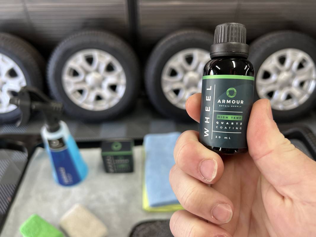

But all of the above pale in comparison to a proper ceramic coating. And in that I mean a high-temperature wheel specific ceramic coating, a regular paint coating won't last very long on wheels which are subjected to THE most contamination on a vehicle. Products like Carpro DLUX, Gtechniq C5 and Gyeon Rim are all candidates. But the one you want is Armour Detail Supply High-Temp Wheel Coating.
Armour Wheel Coating – Armour Detail Supply
So, why this coating in particular. Unlike a most wheel coatings, the ADS coating is super slick and hydrophobic. It will also have much better real-world longevity. I have this on multiple vehicles now and it makes cleaning wheels so brilliantly easy, while also being slick and glossy. I find that 99% off the brake dust simply rinses off the wheel, no agitation required.
