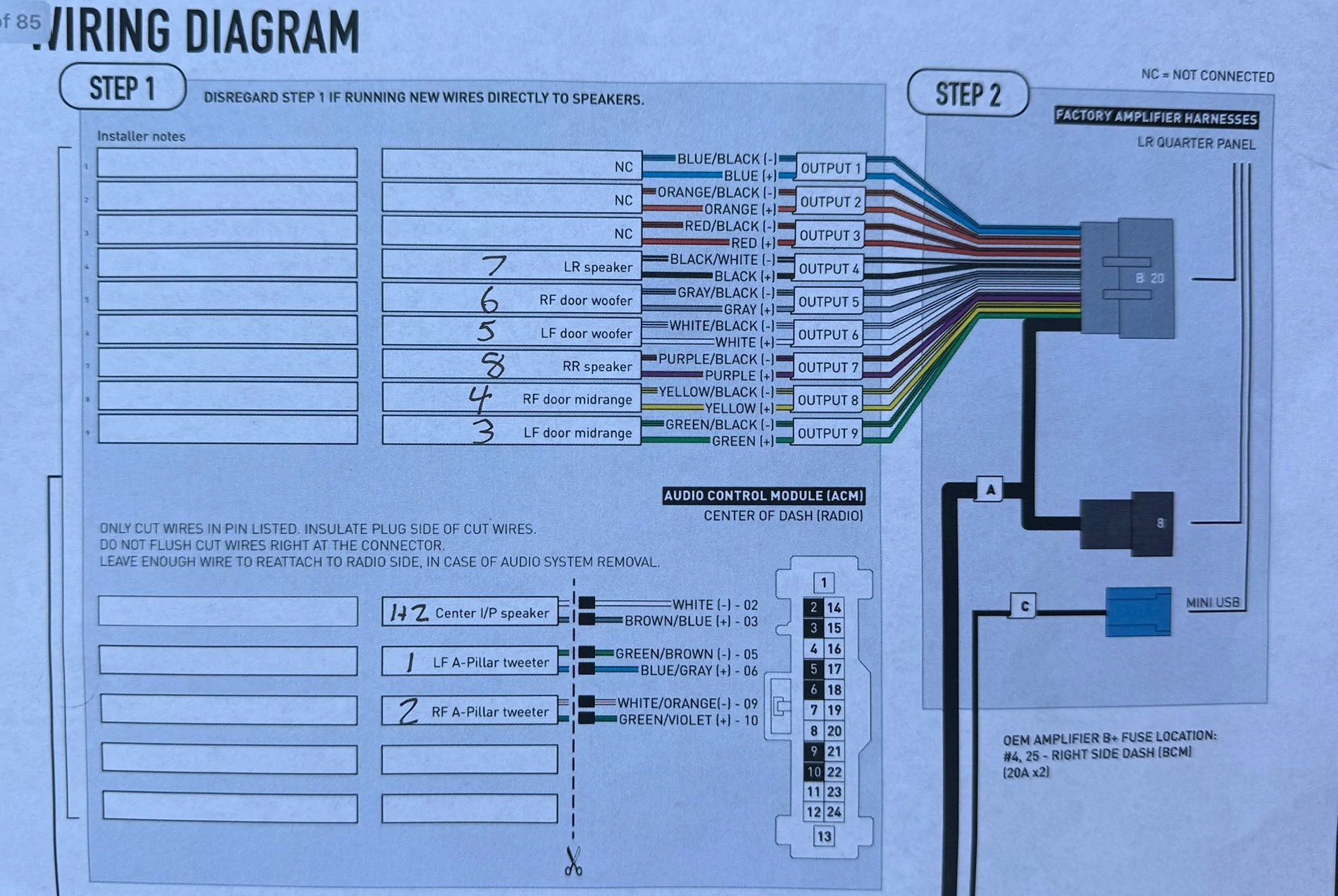

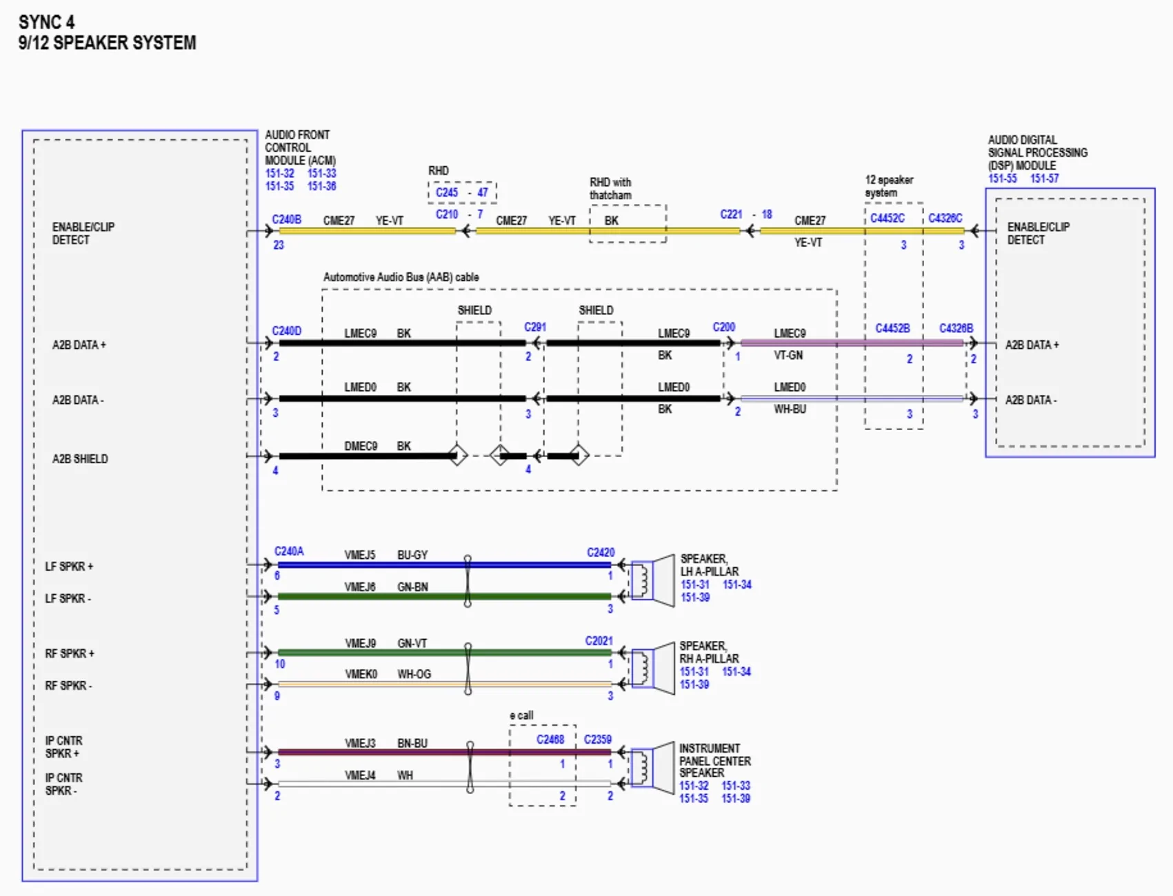

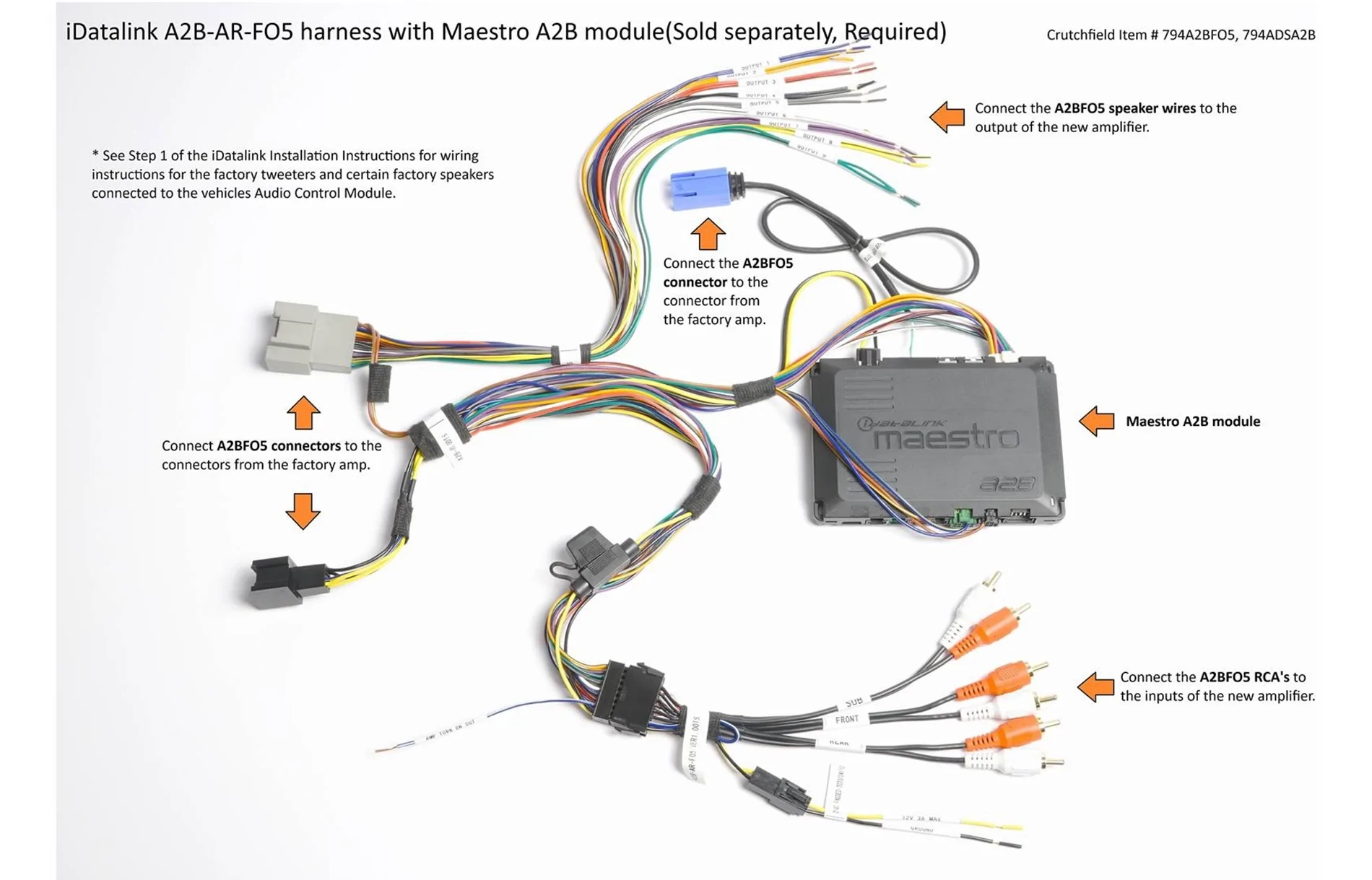

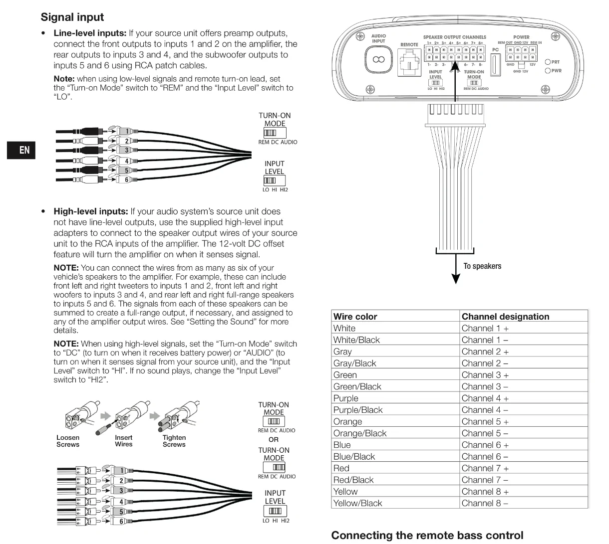

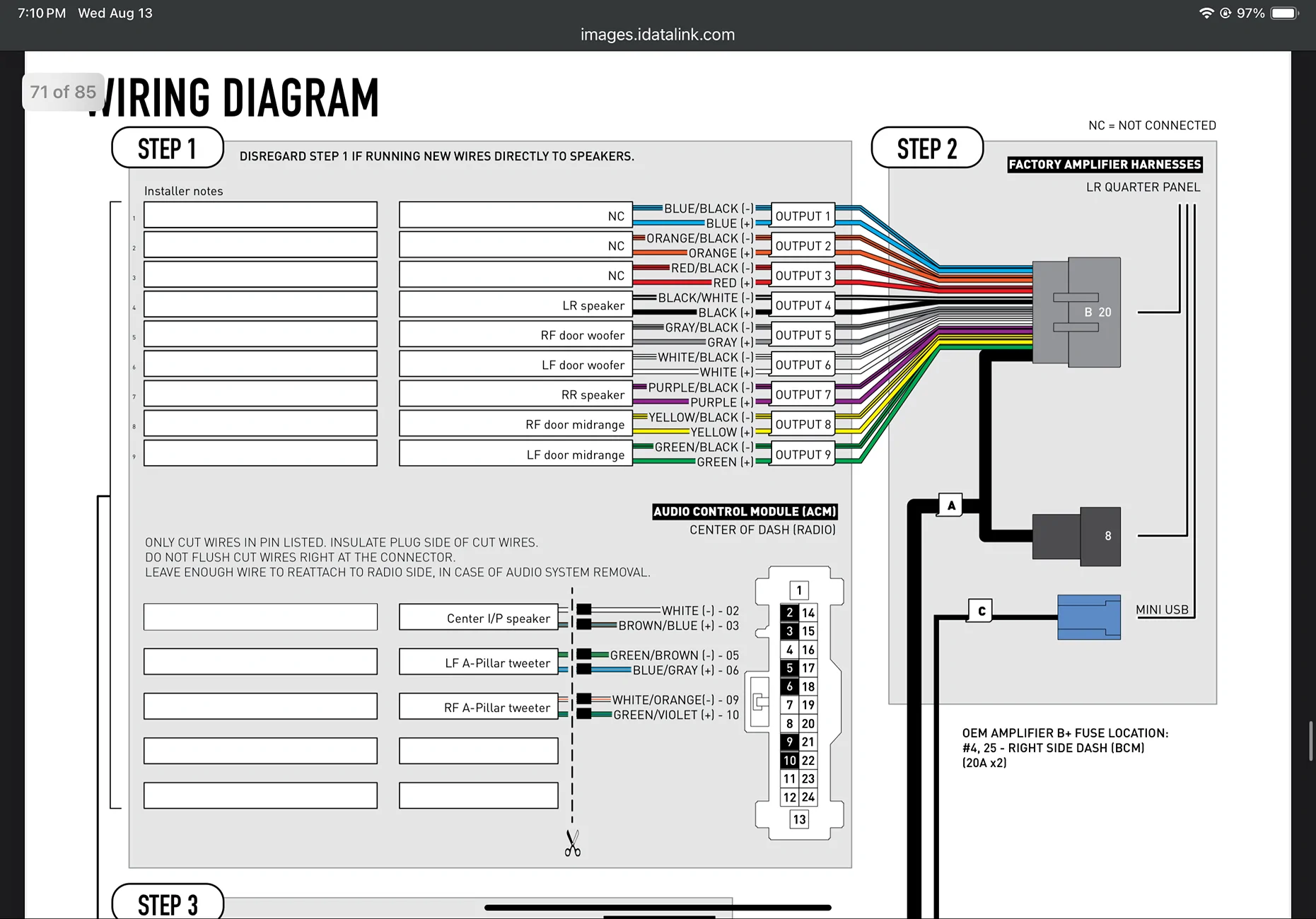

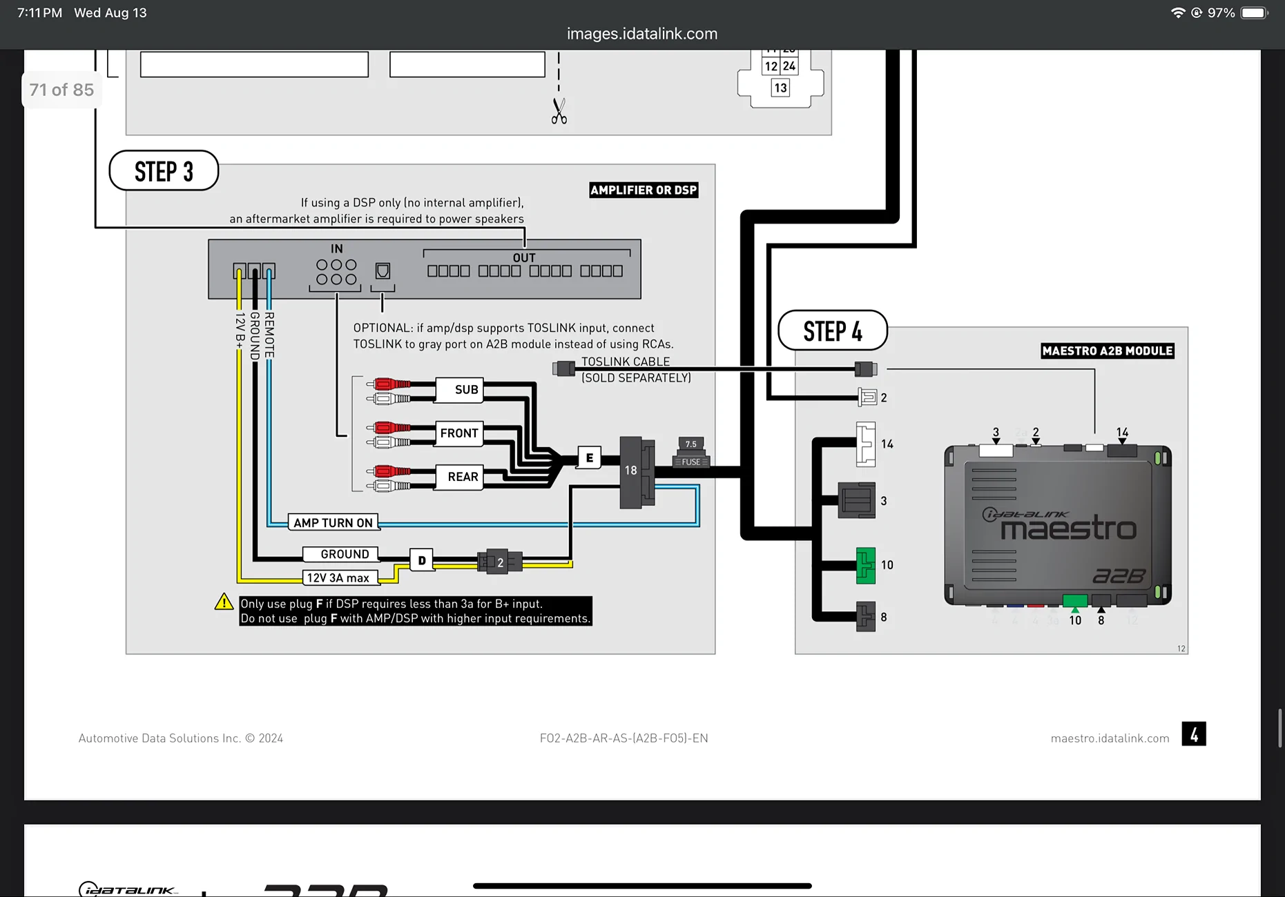

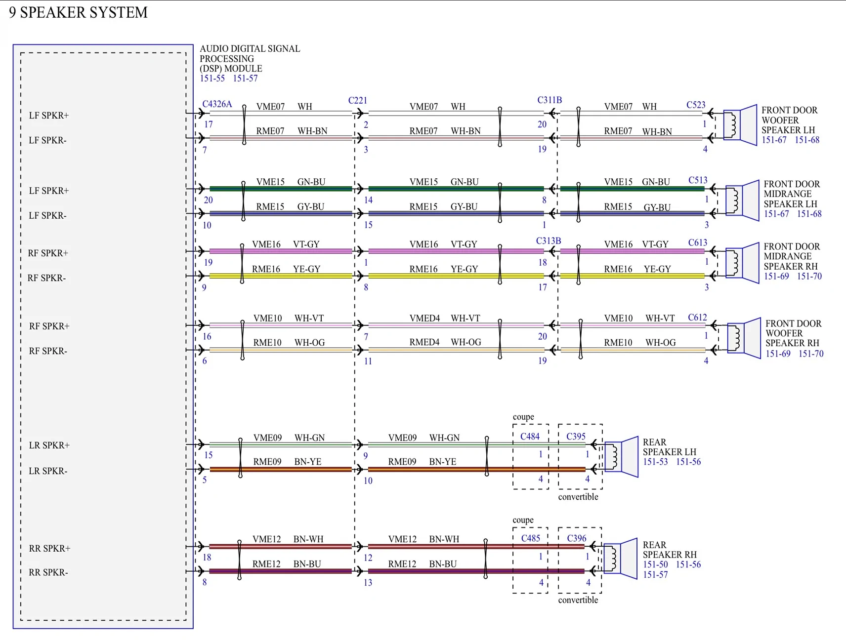

Here are the wiring diagrams for everything.
You will need to run new speaker wire to the tweeters in the A Pillars, and Center.
you can sum the Center on Channel 1 and 2, but in the end I decided to wait on doing that. So i am using 8 channels of the amp for 8 speakers, putting 120w per side to the front stage and 40w per side to the rears. The sub is powered.
The JBL directly wires channels 3-8 to the Harness. 1 and 2 go to the tweeters with new wires.
i use the Maestro’s RCA channel 1 and 2 to to the JBL (and use source controlls on the JBL software to assign the channels). I use the Maestro’s 3 and 4 RCAs with a F to Male RCA cable to the sub.
Power is a 4ga positive from the battery to the trunk with a 4ga to 8ga distribution block feeding the JBL and the Sub. The grounds are on the body in the trunk.

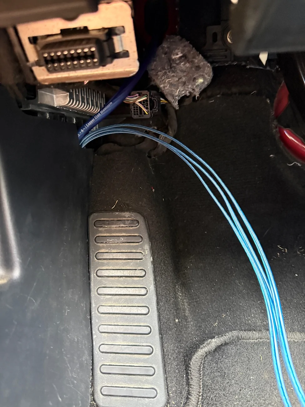

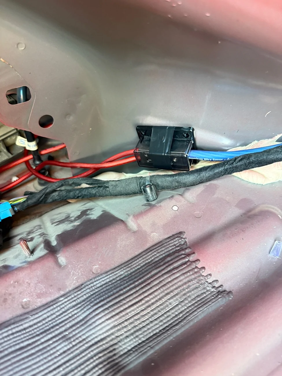

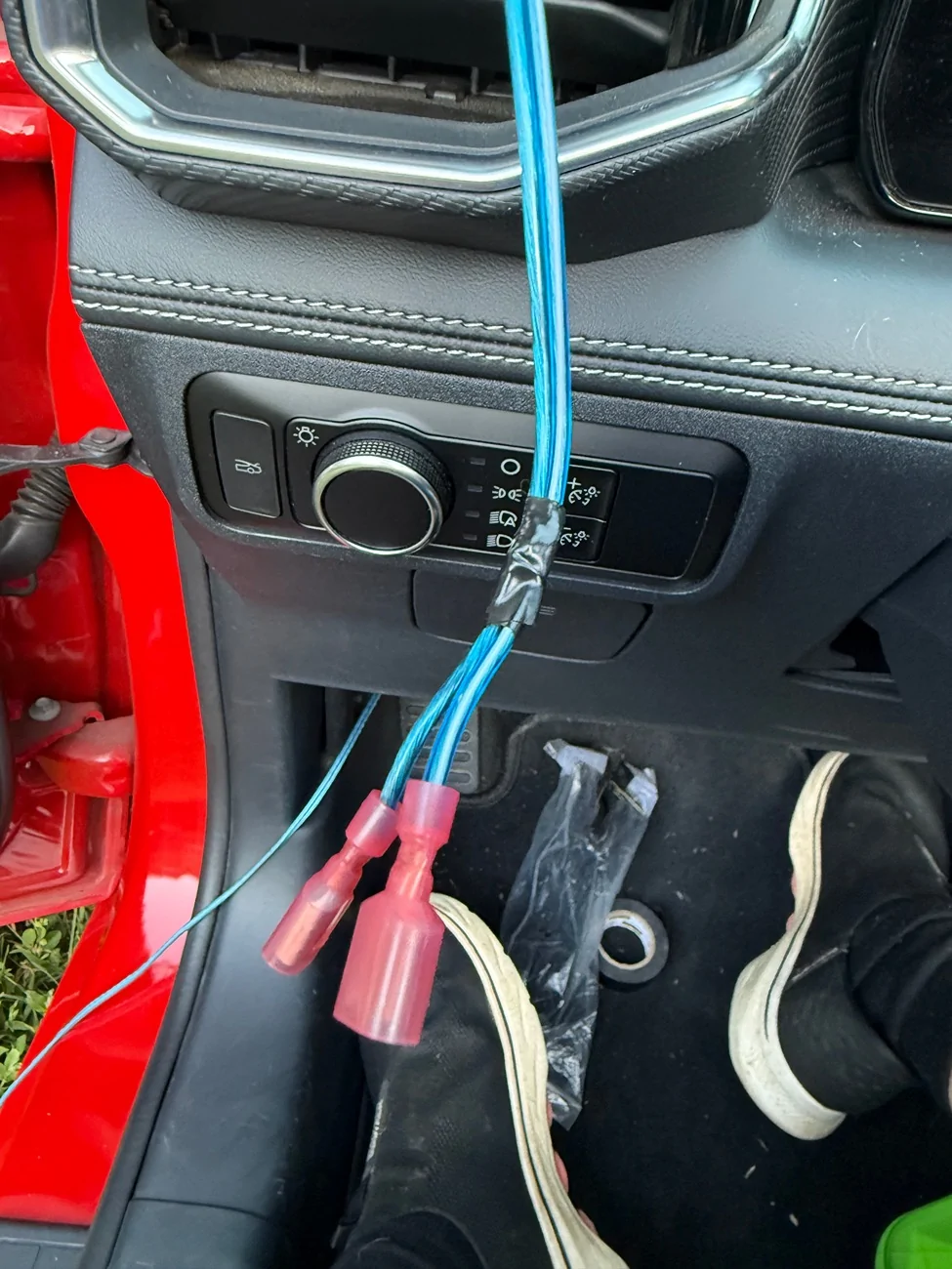

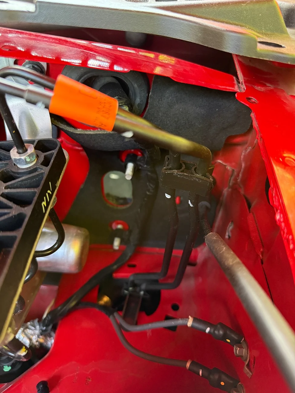

Cable paths are easy.
No remote turn on or taps needed. The Maestro supplies it. The JBL has a remote turn on out for the sub.

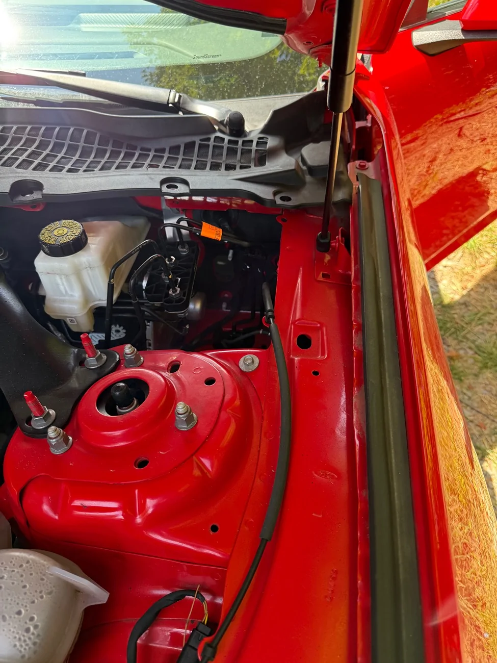

Run the 4ga through the giant drivers side grommet thats is easy to access to the battery. Run the tweeter wires ( and center wire if you choose ) along with the 4ga power under the trim on the drivers side all the way to the trunk.
You can easily fishtape the tweeter wires once you have the A Pillar covers off.

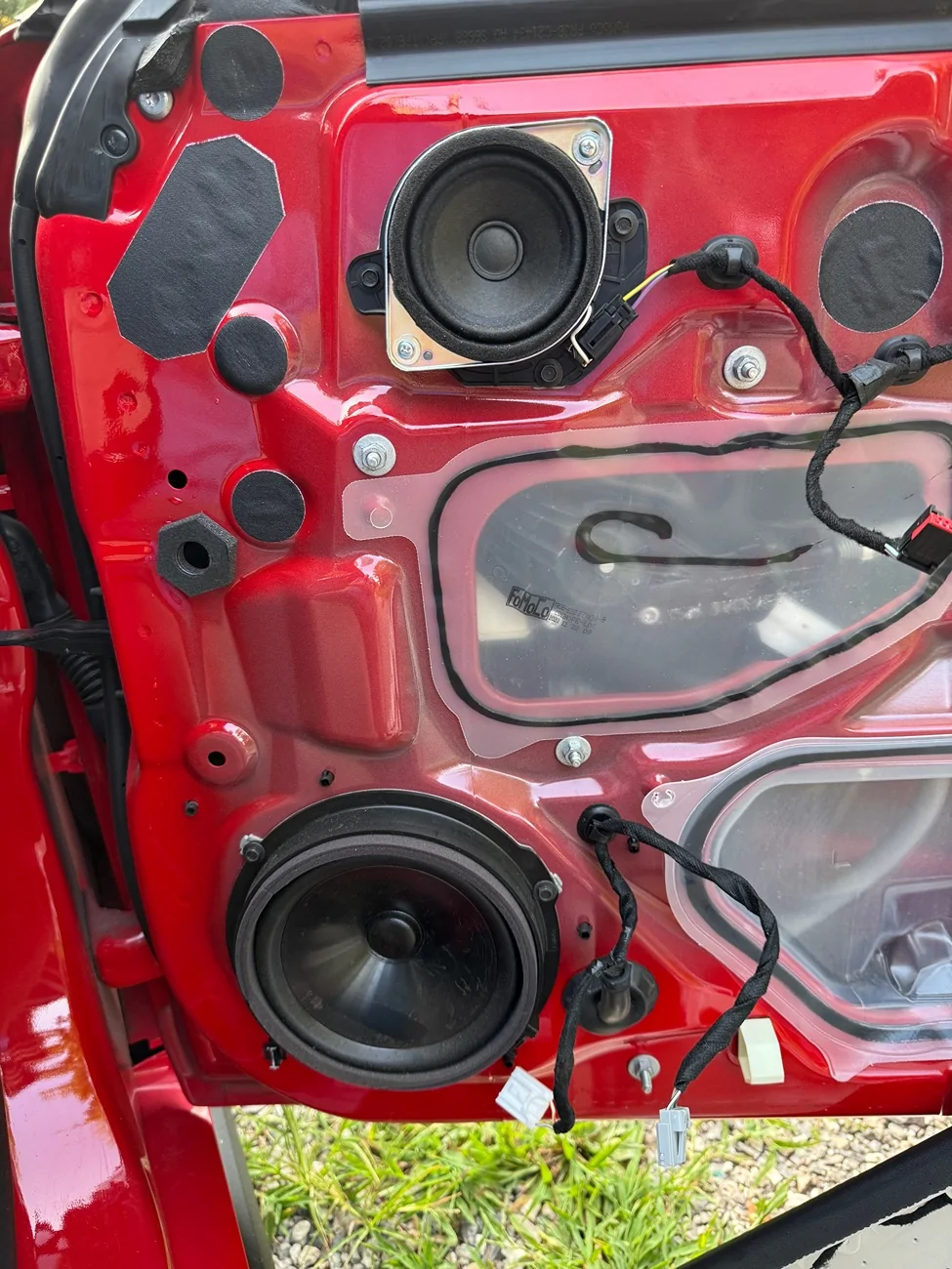

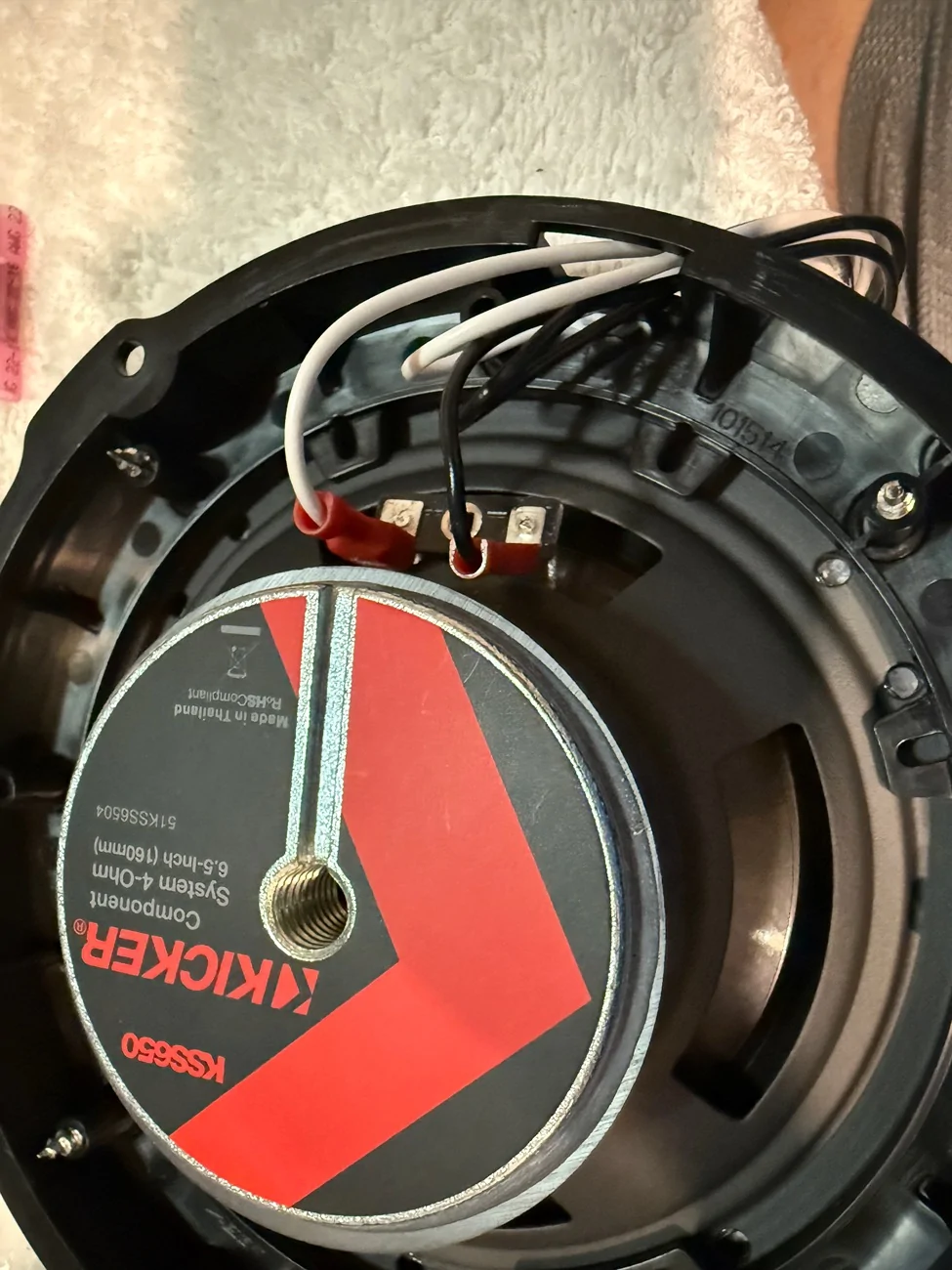

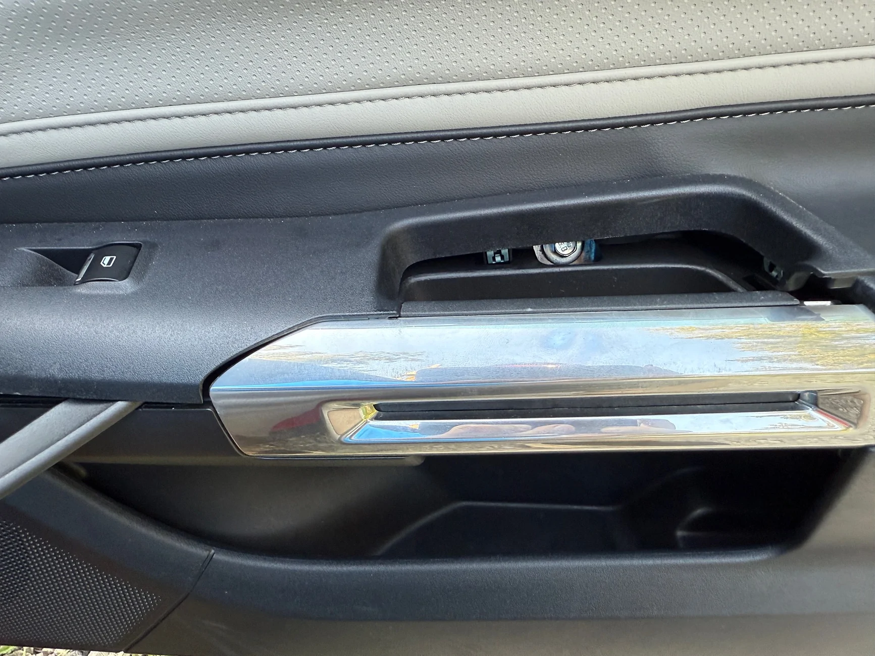

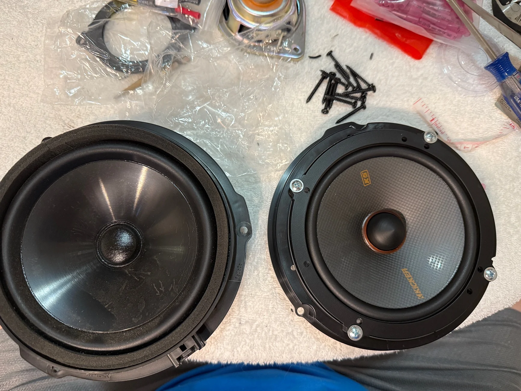

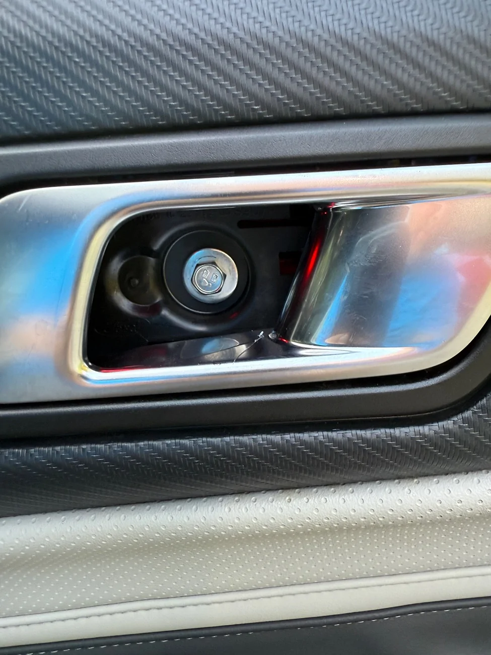

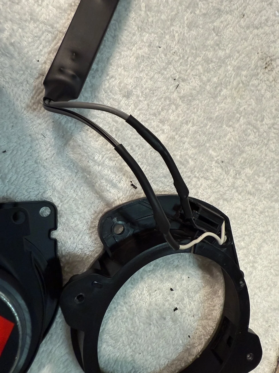

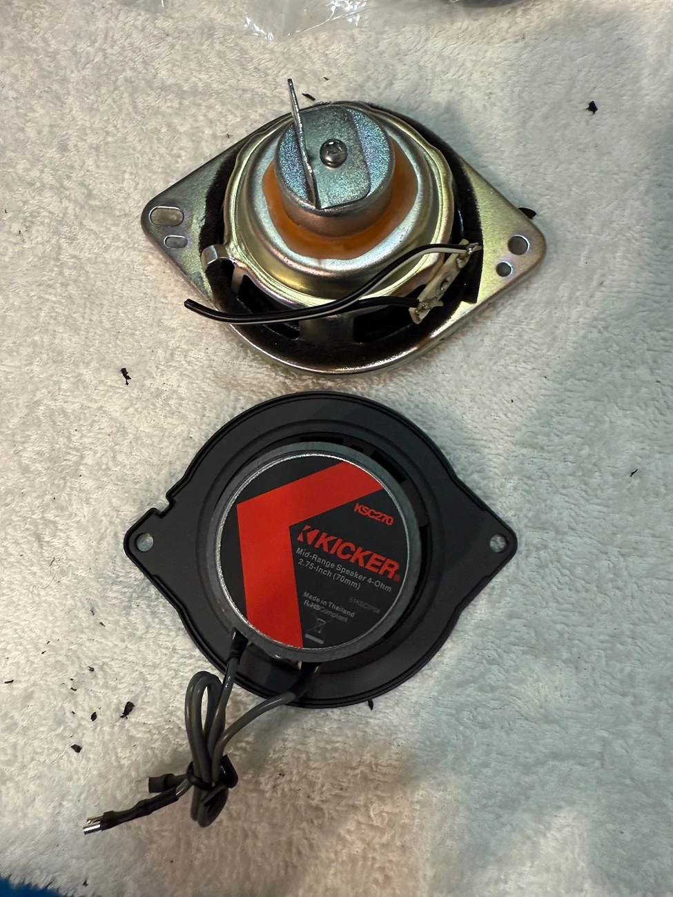

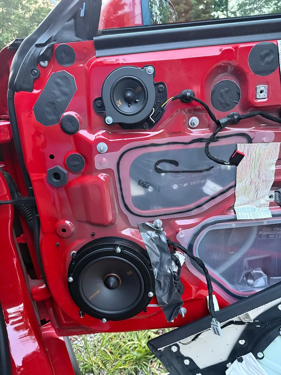

The door speakers are a little difficult. Use the metra adapters for the woofer. Kicker supplies a 3.5” adapter for the mid.
these kickers have inline crossovers. Thats why I chose them. You mount the cross over with each speaker in line with the factor speakers. You can use metra adapters for the 6.5s. All other speakers require you to clip the adapters off the old ford speakers to wire in.
be sure to sound deaden the inside the door areas, the door areas you can, and the door trim you can.
you need to move a covers on the handle, the switch panel pulls up, and the two screws on the bottom of the door.the rest are just clips you pull straight out.

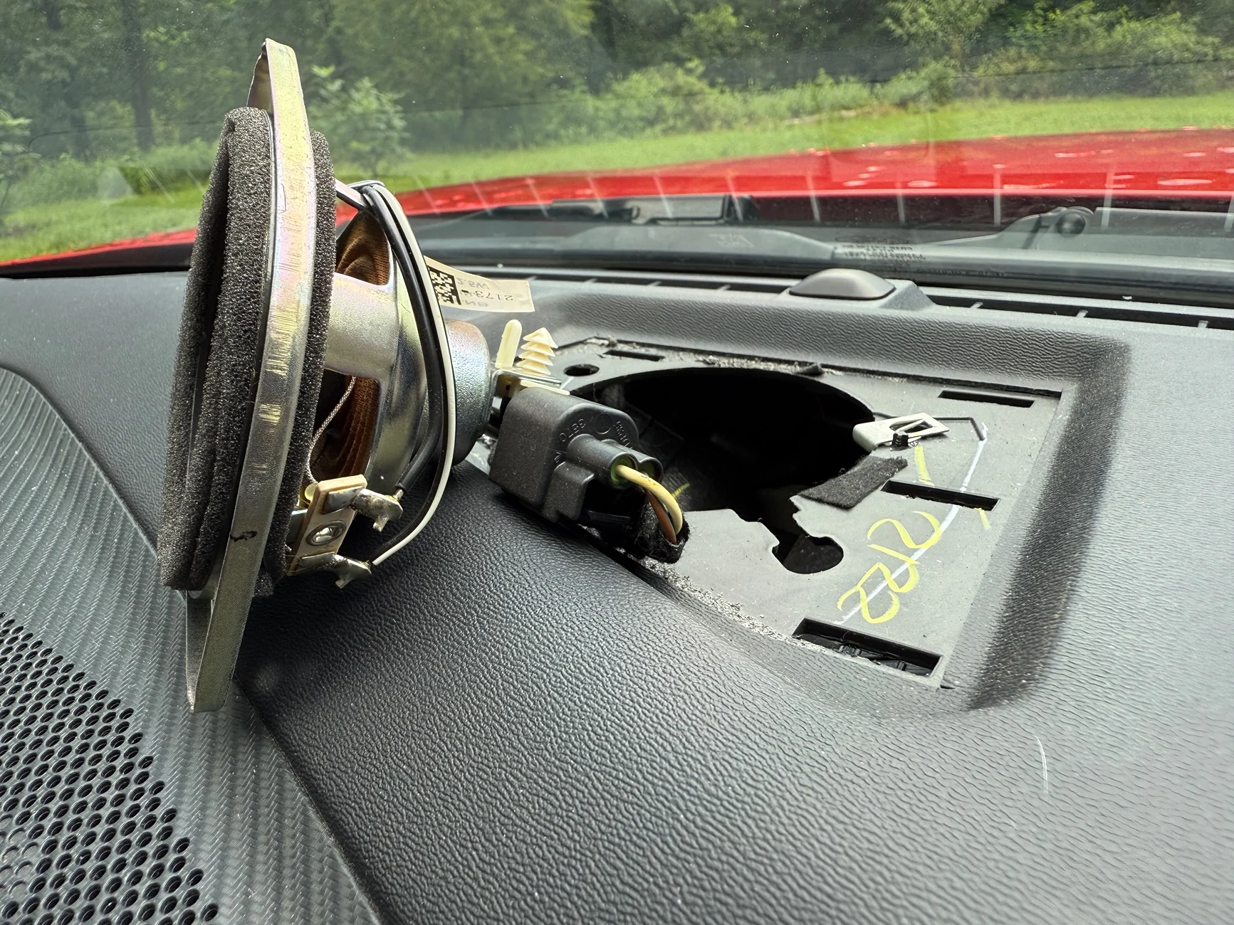

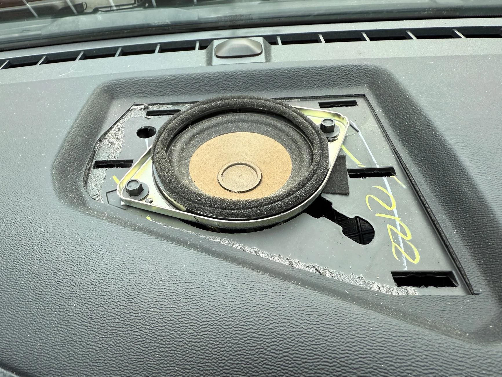

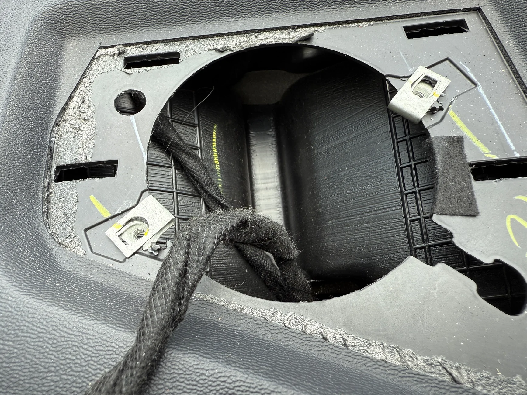

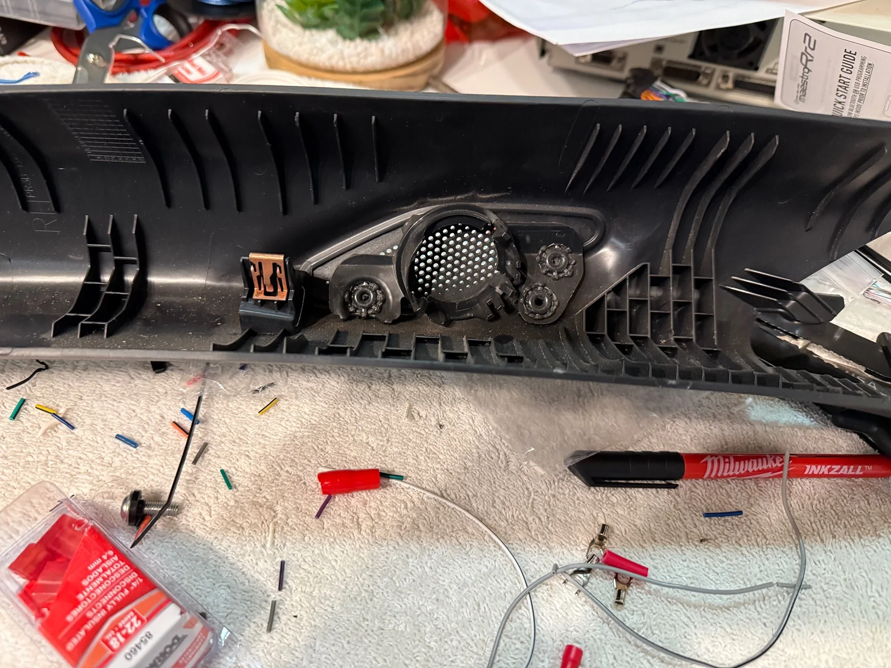

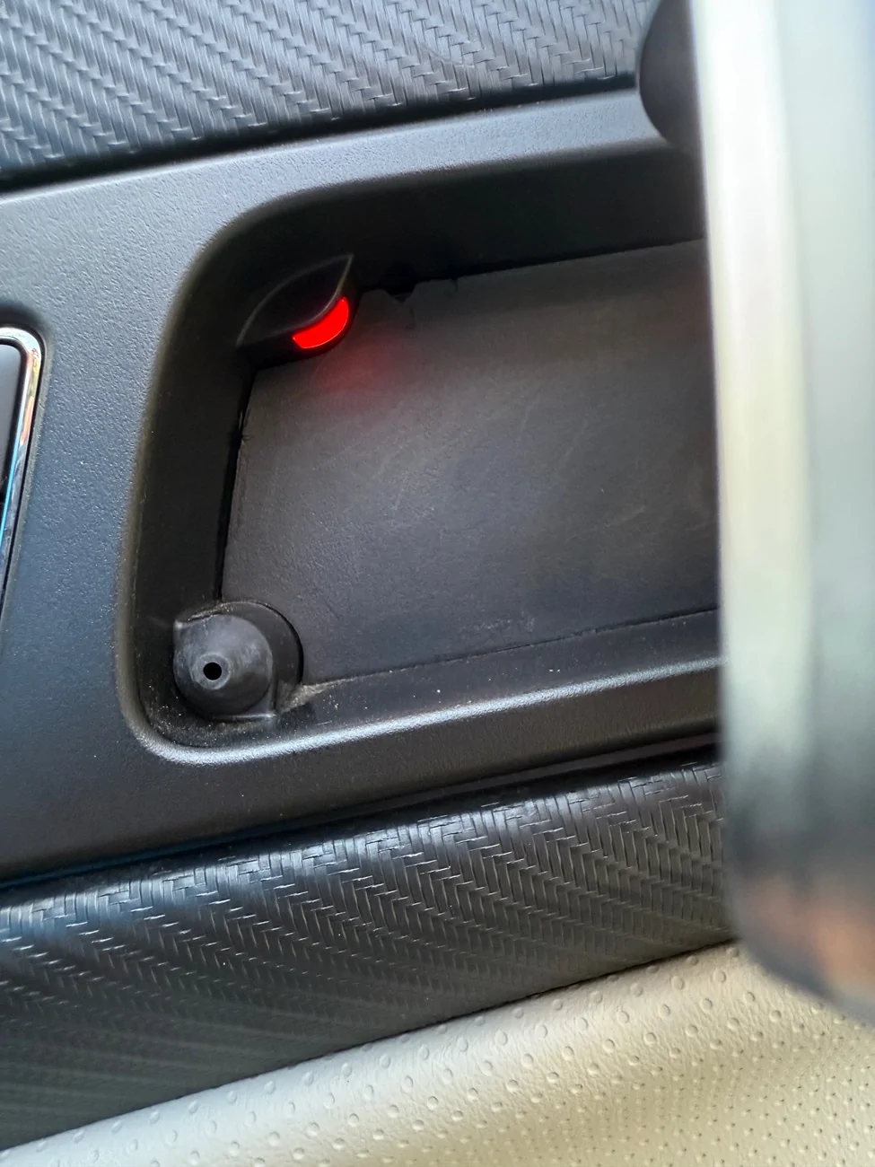

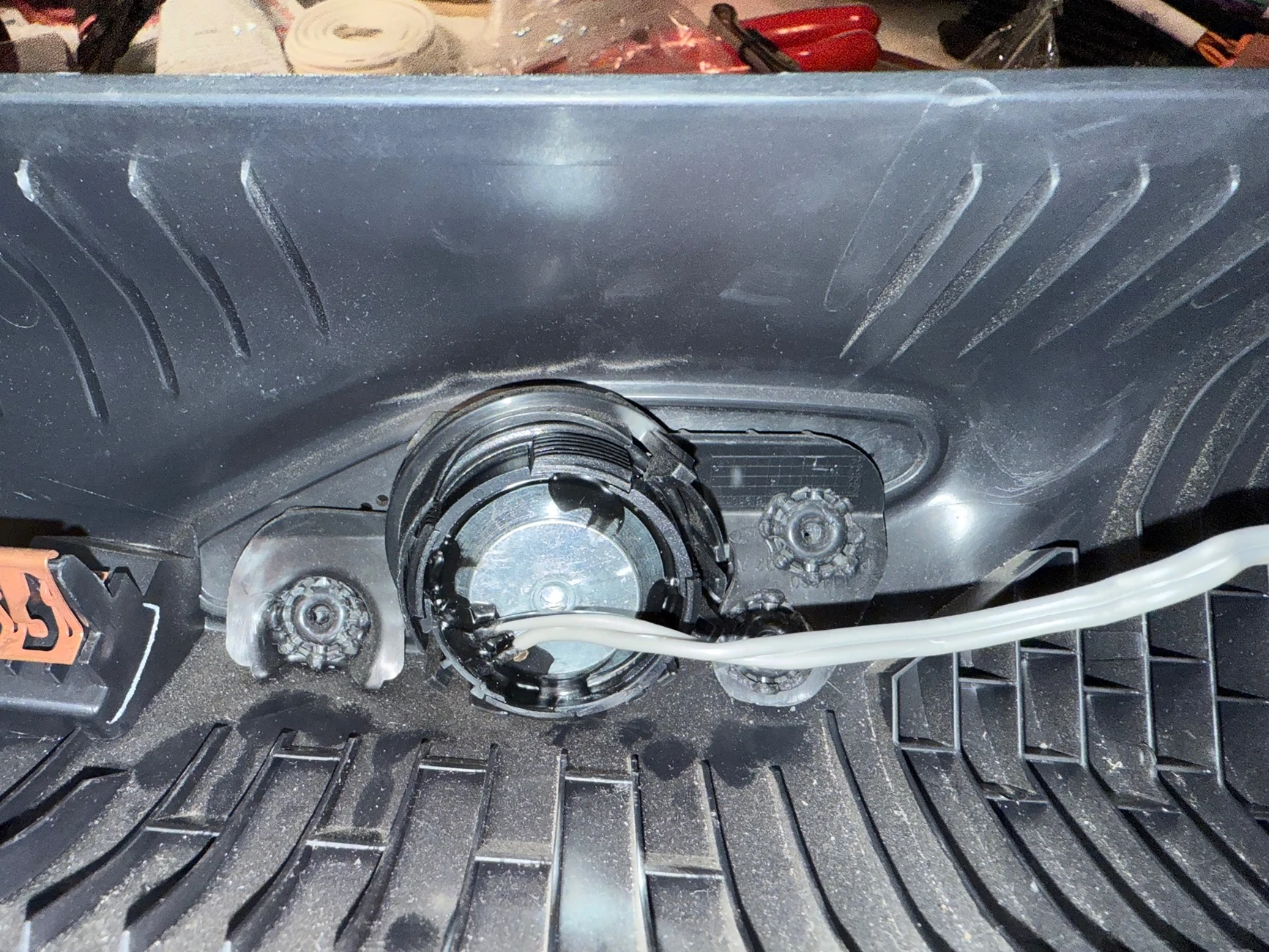

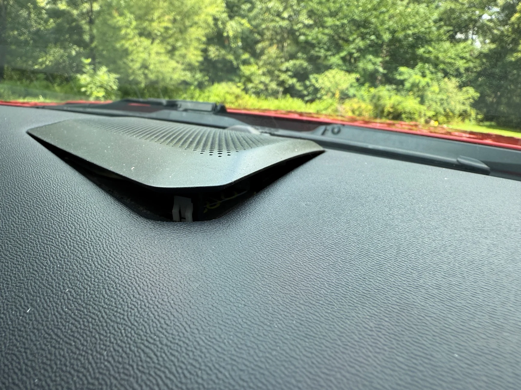

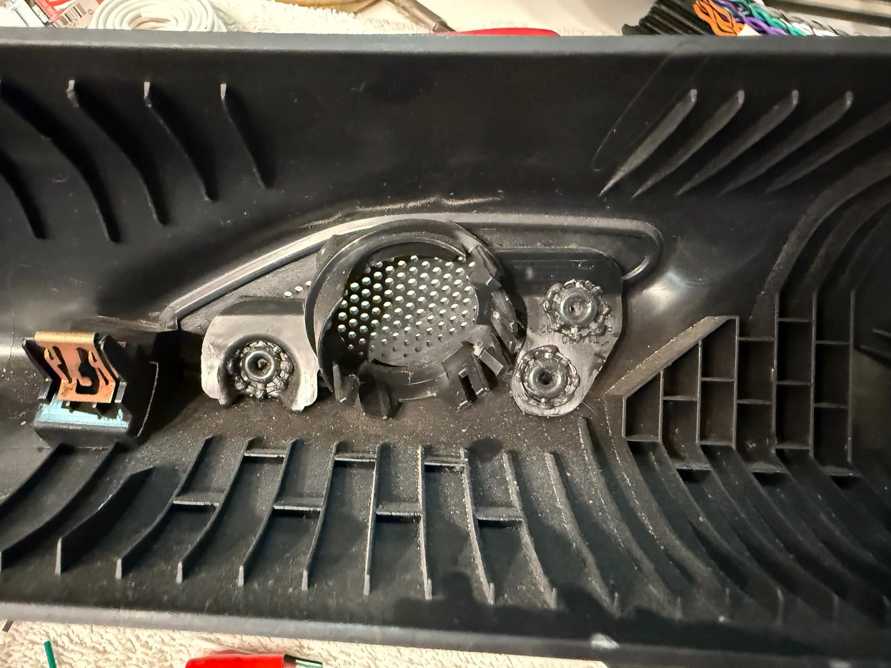

A pillars are a pain. You habe to remove the sun visors first. Then gently pry down the top, the pull out the rest from the sides.
unhook the factory tweeters. They remove from the a pillar plastic easily. The Kicker tweeters fit right in their place snuggly. You have to push them them in Firmly. Connect them with your new speaker cables.
the center is easy to remove and change out. But routing cable is a pain.

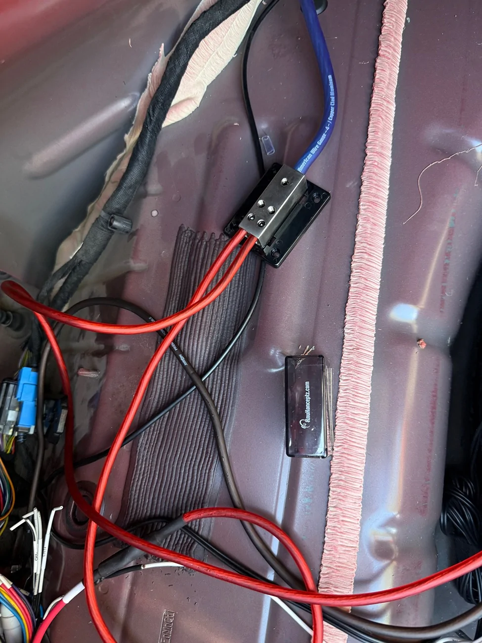

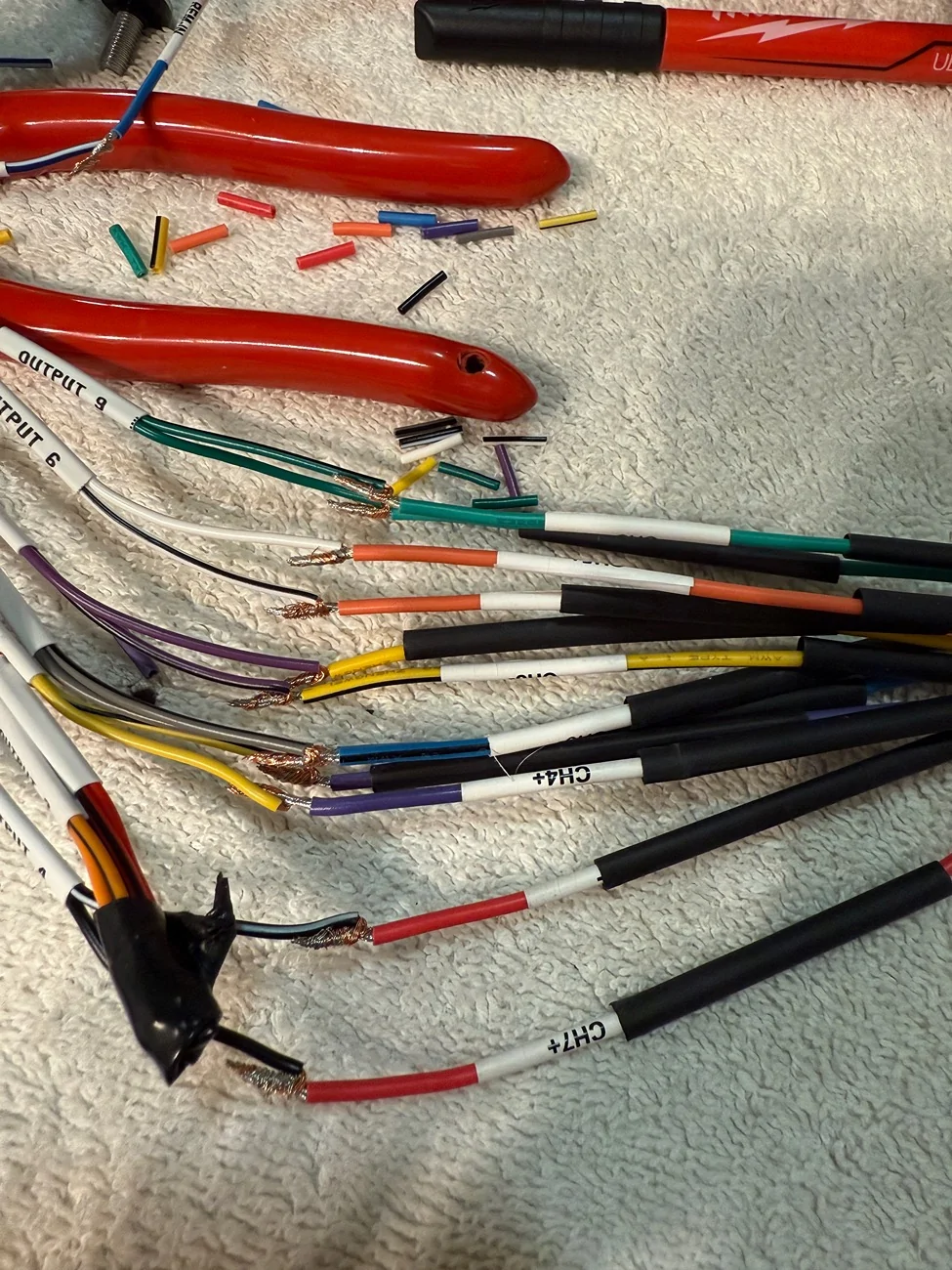

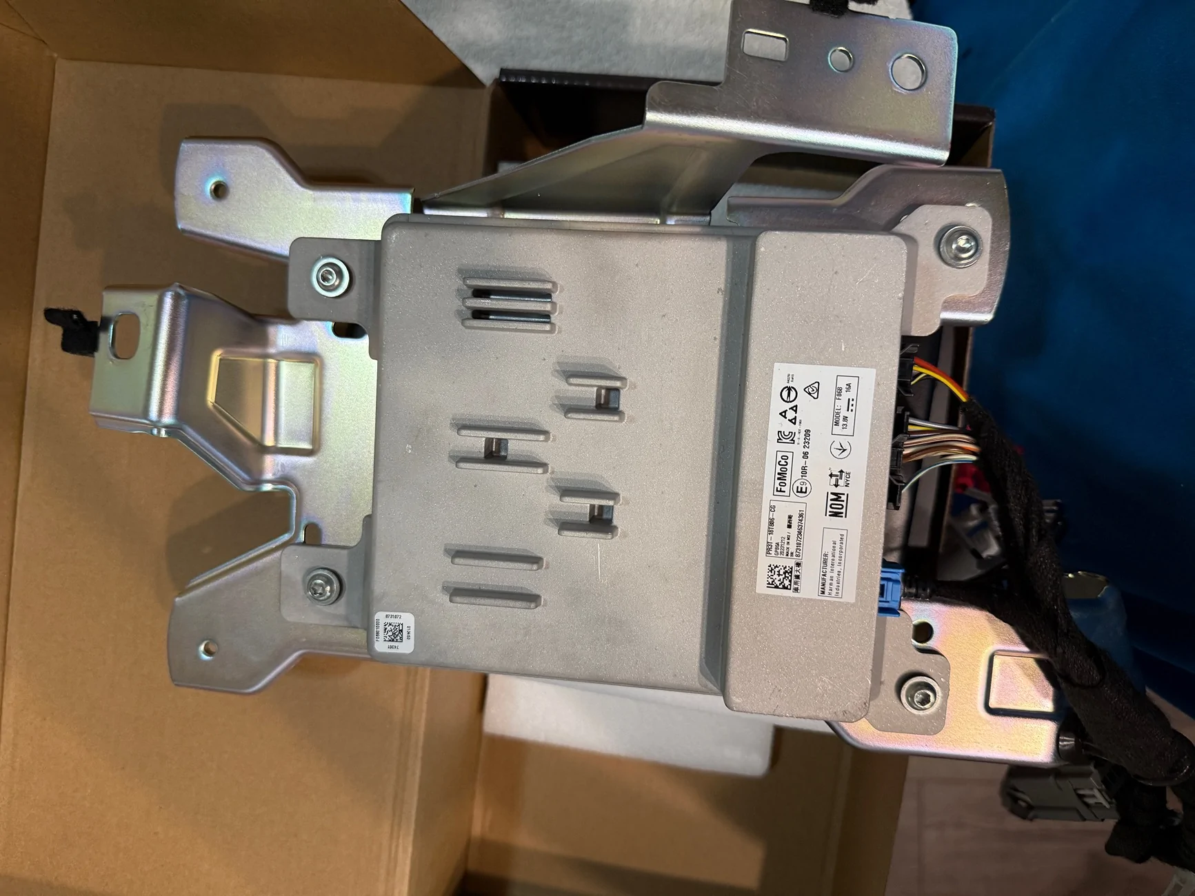

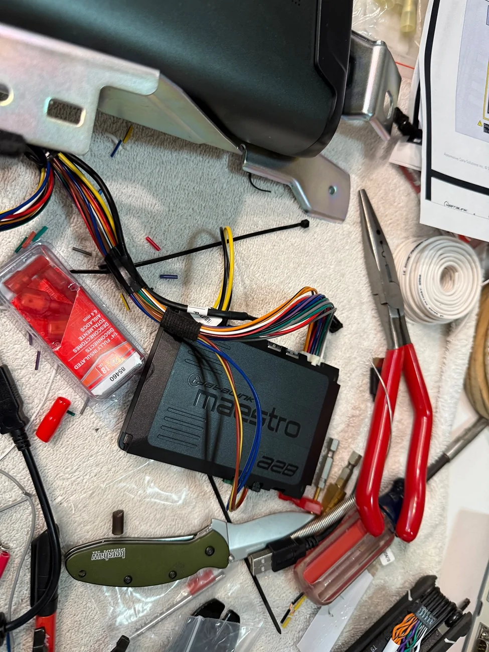

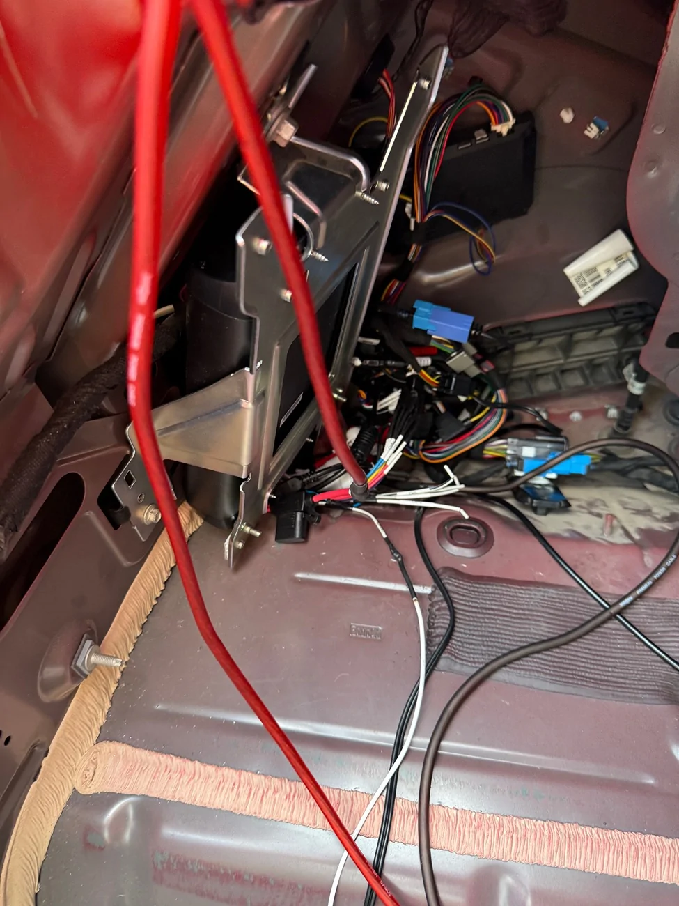

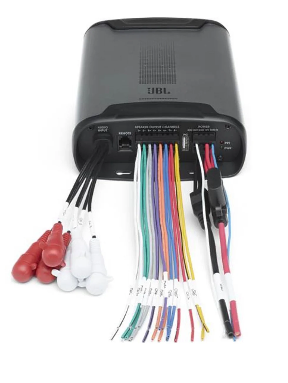

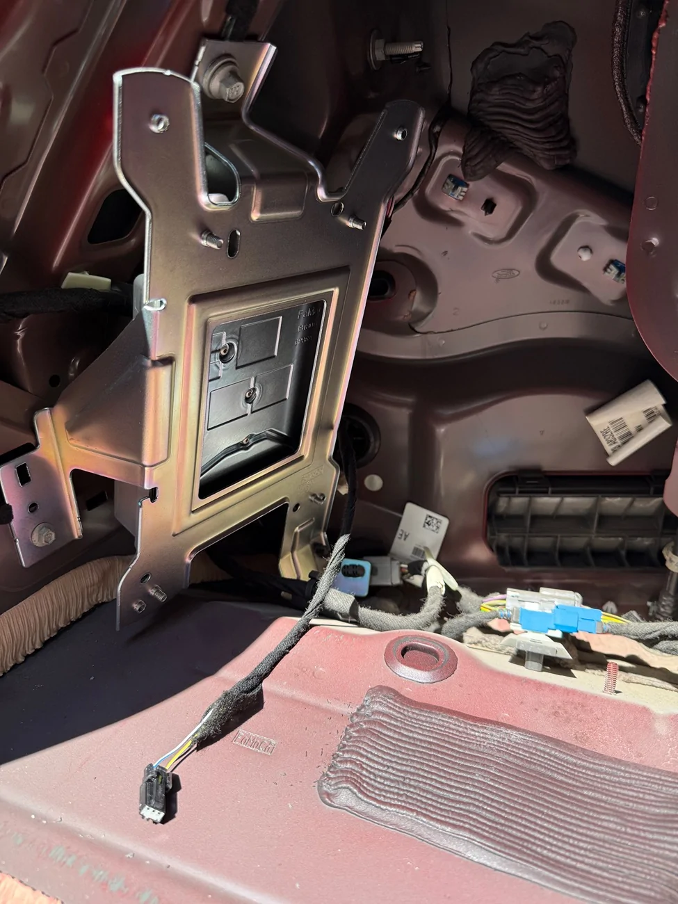

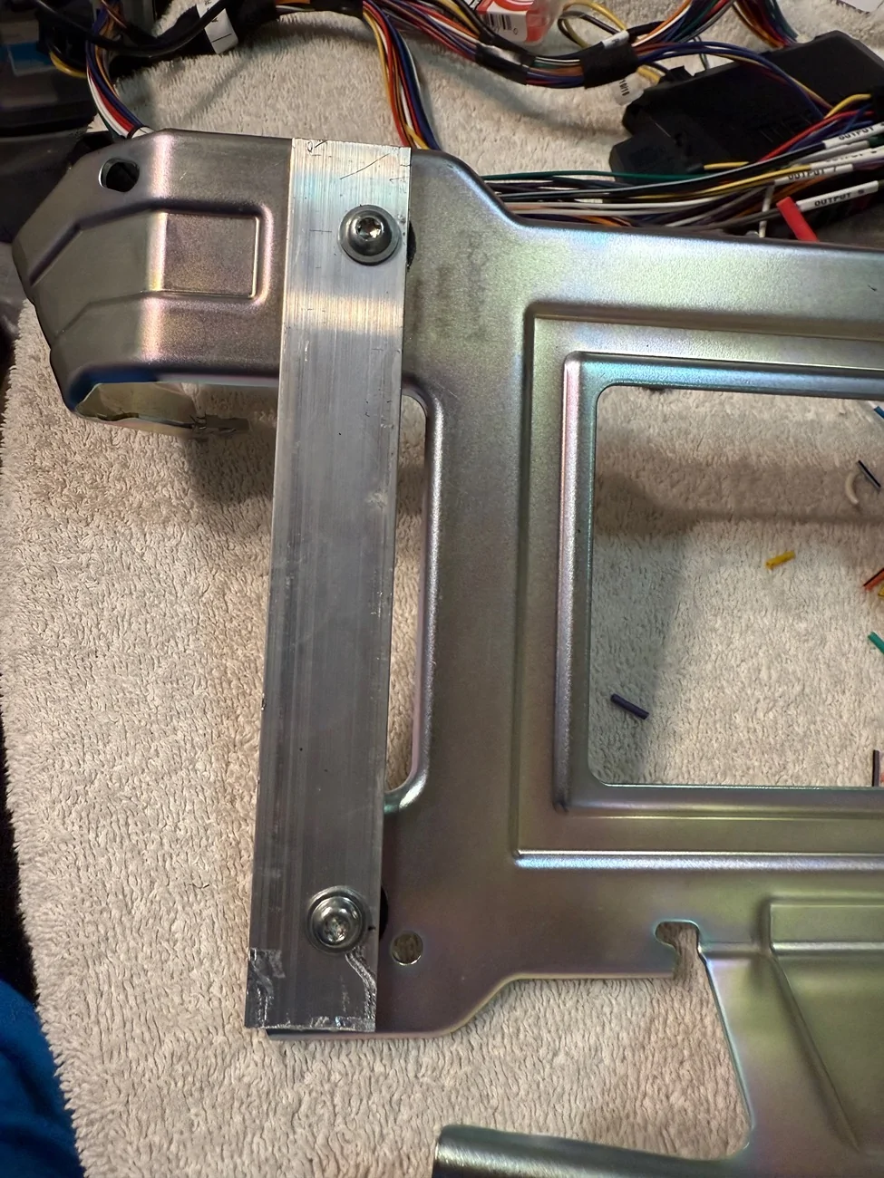

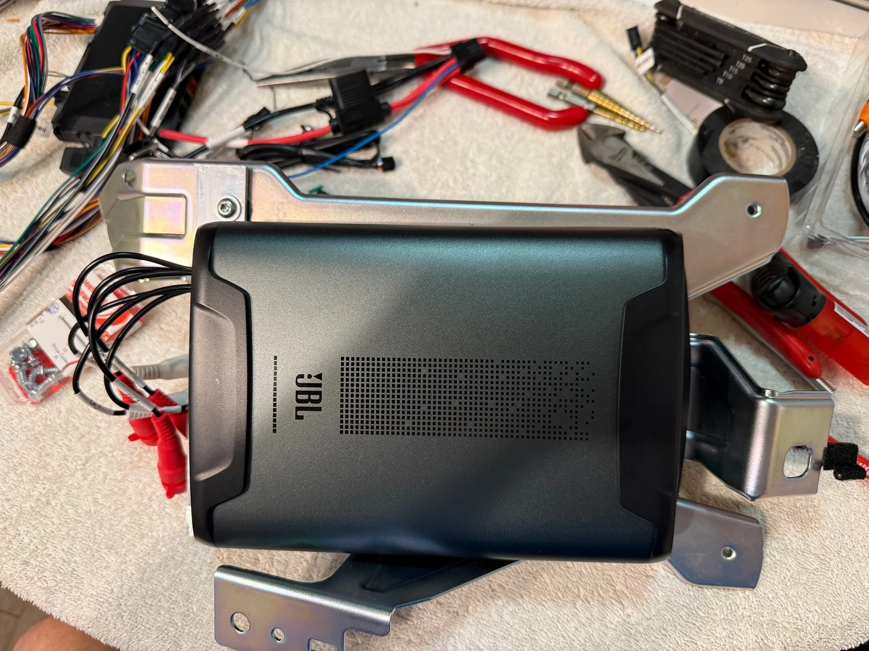

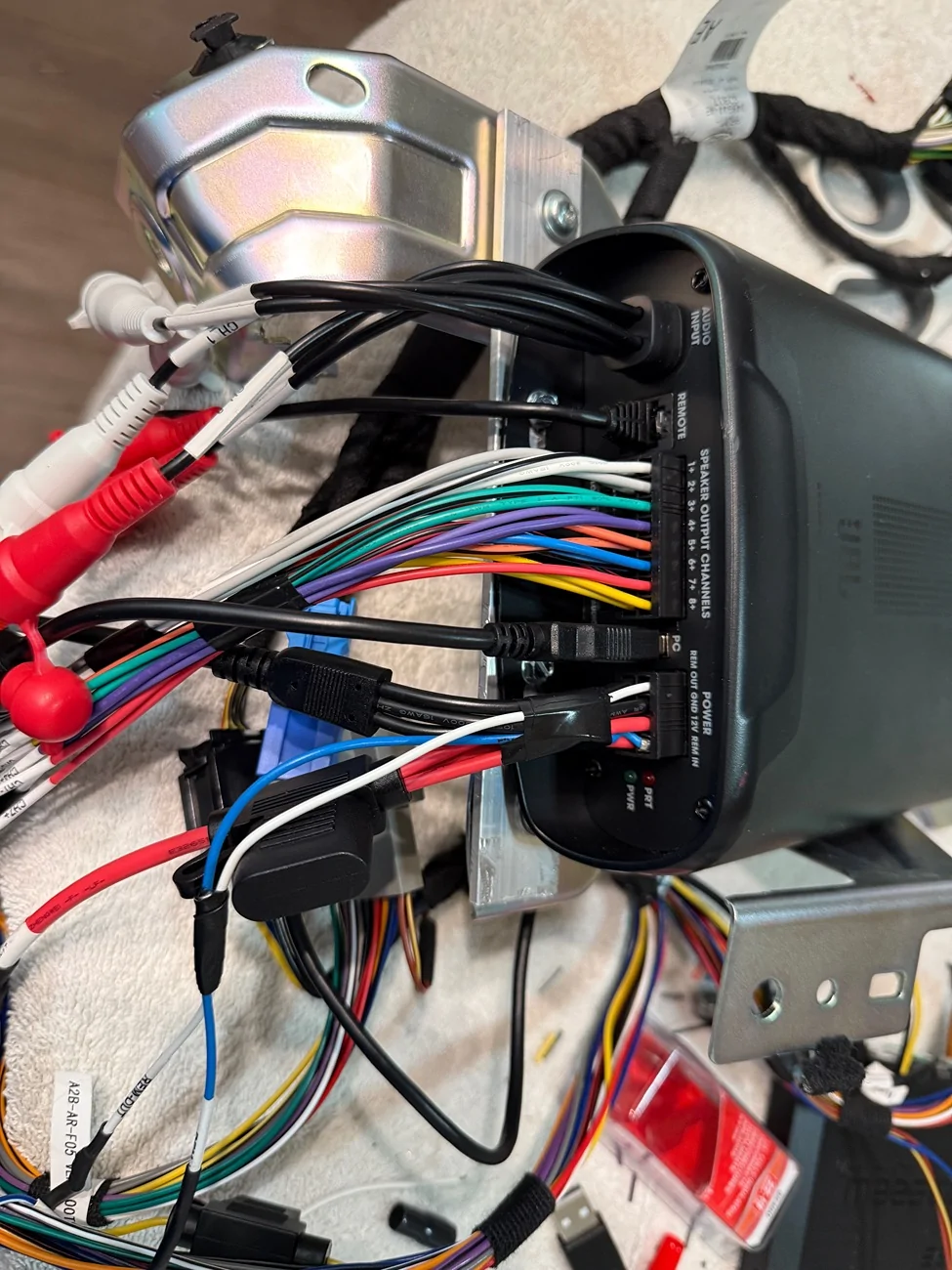

The Amp, harness, and A2B module are the real work, i soldered most everything.
i used the factory amp mount, and just added a 1” wide aluminum strip to make a bracket to hold the amp. I velcrowed the AB2 to the sidewall of the trunk.
Follw my wiring guide above.

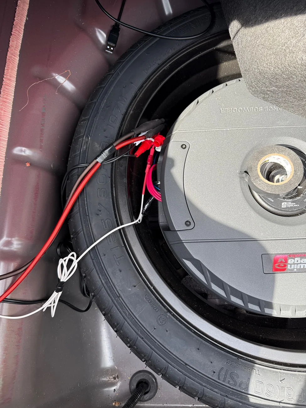

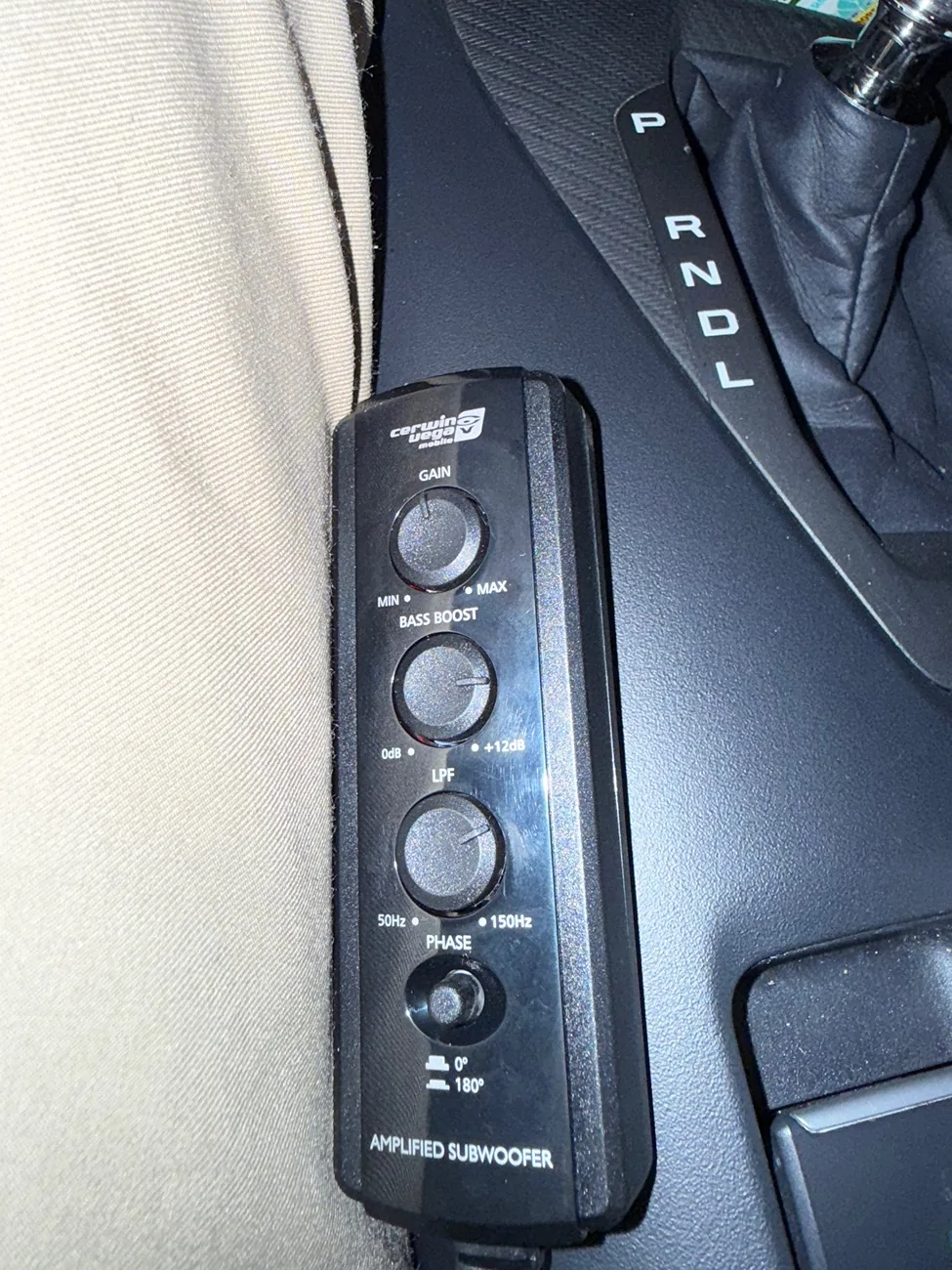

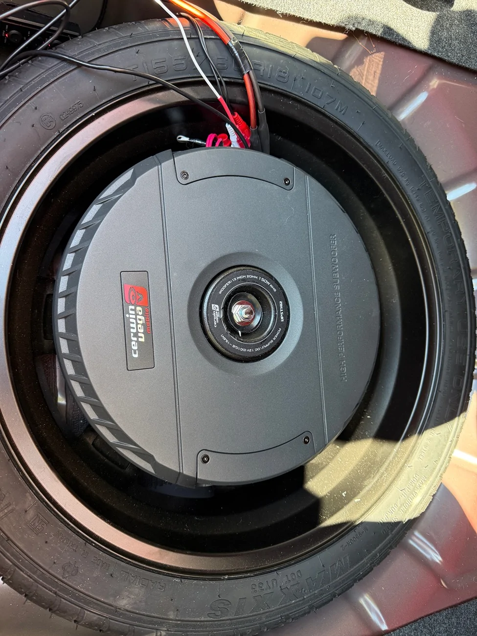

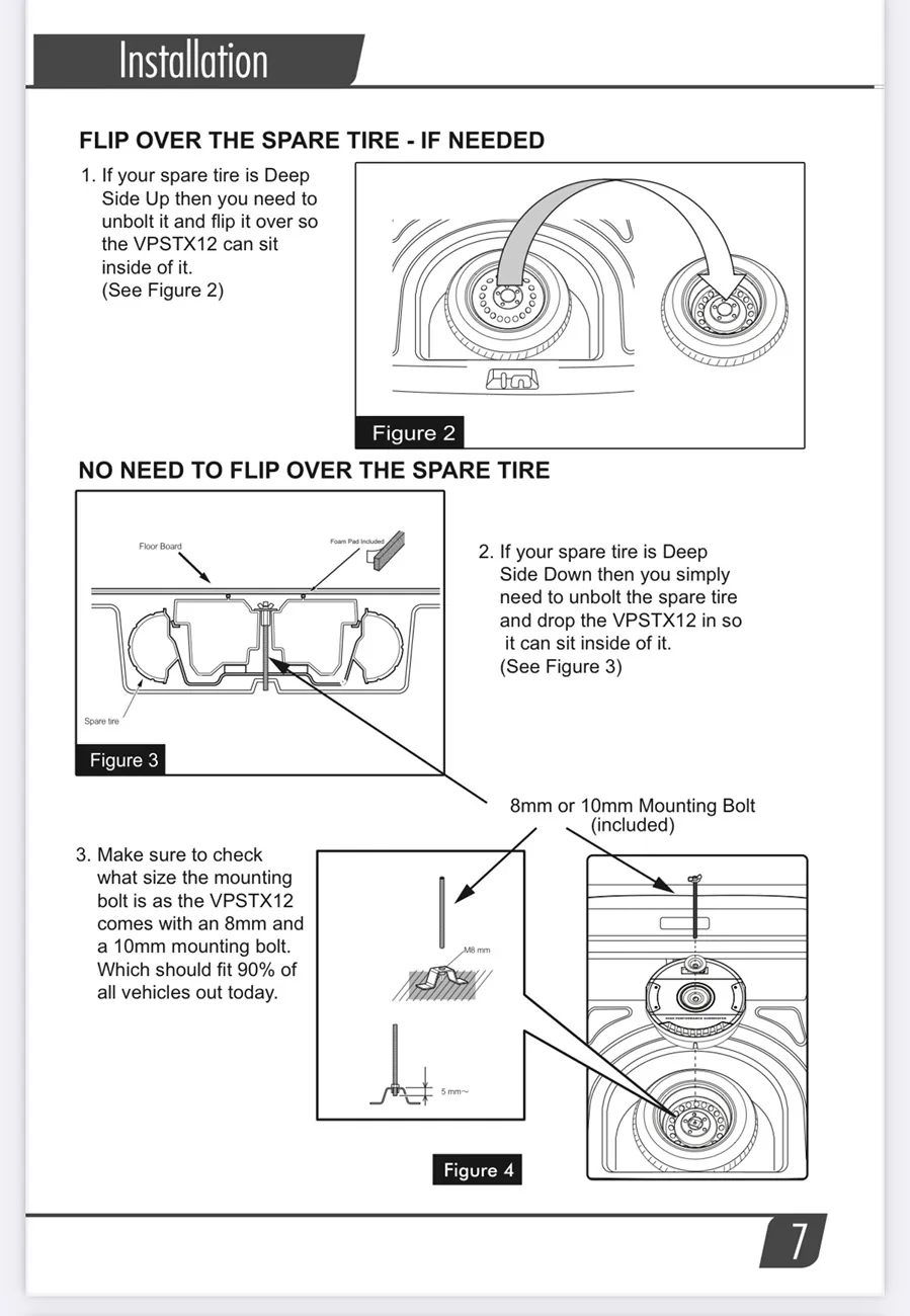

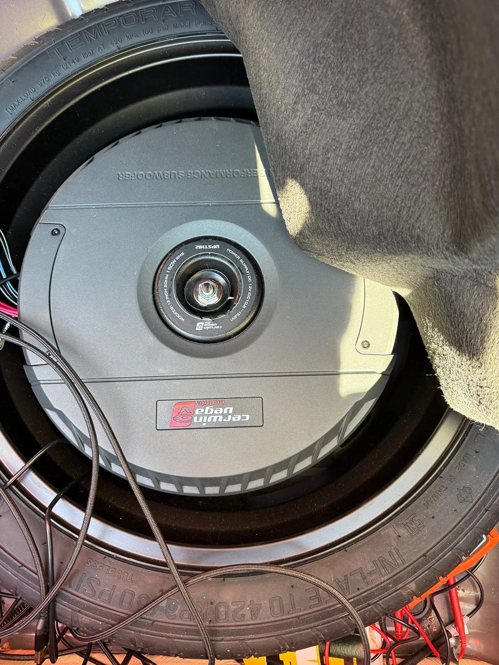

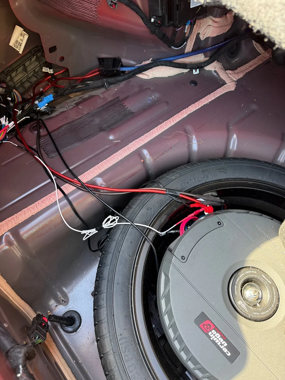

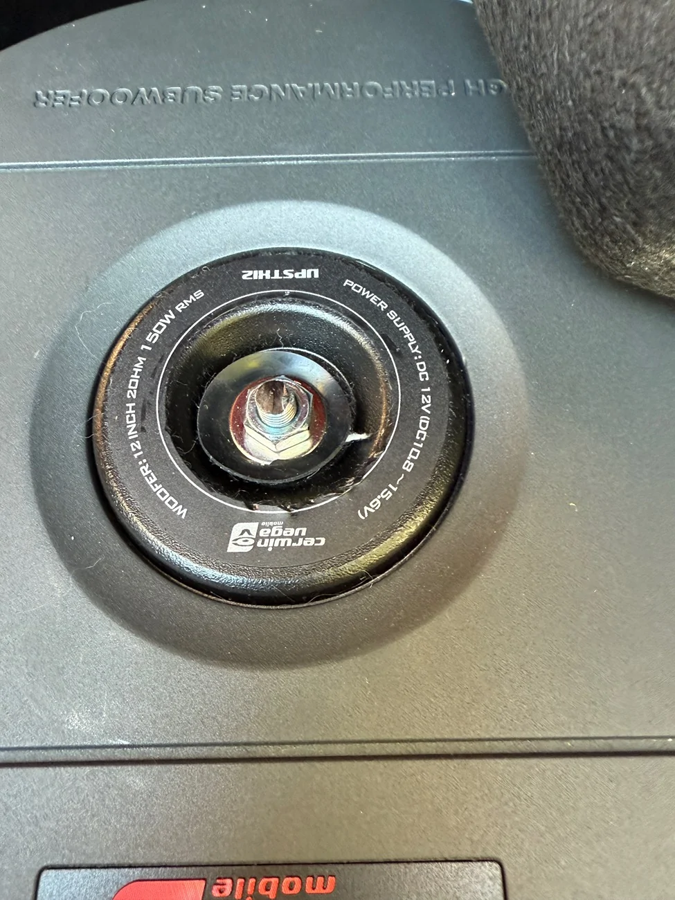

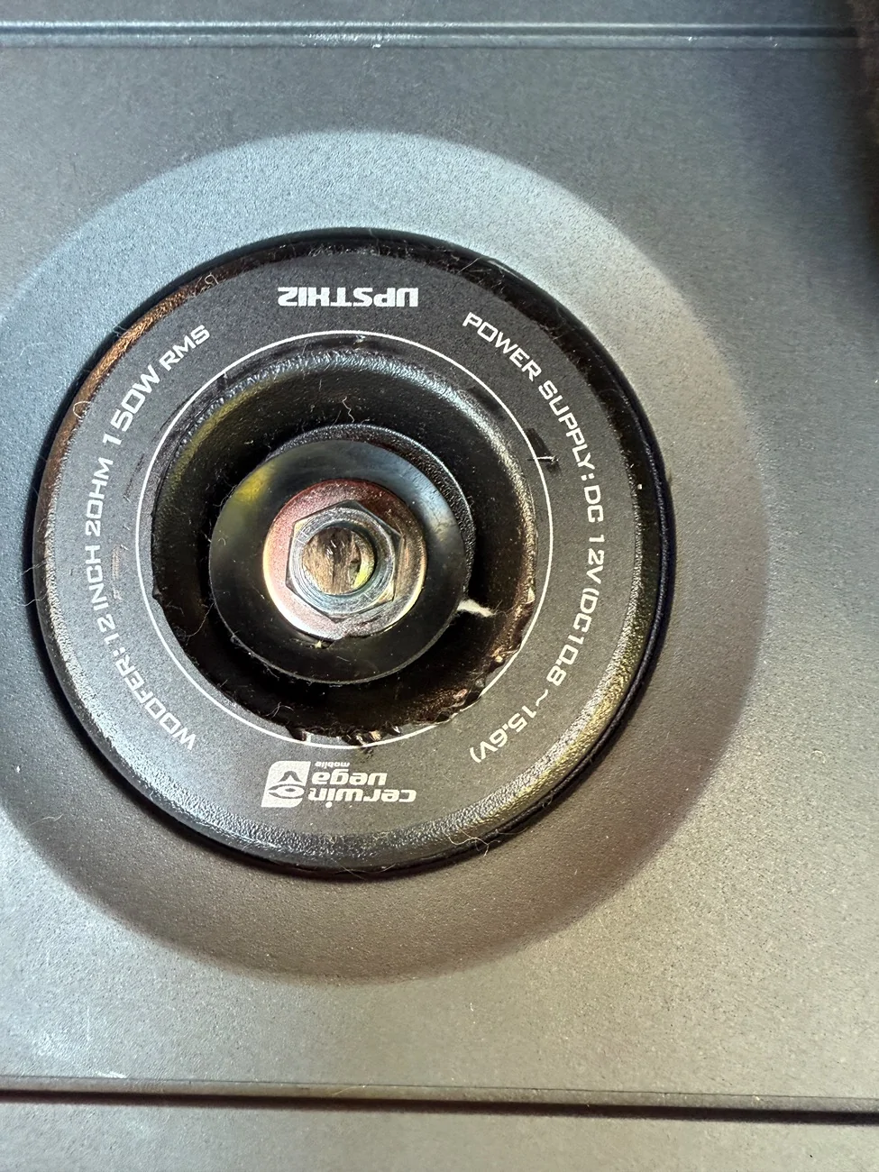

The sub goes in easy. Just flip the spare, use the supplied threaded center shaft. I cut the shaft an inch or so short and used nuts instead of wingnuts, it’s simple.

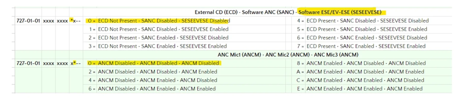

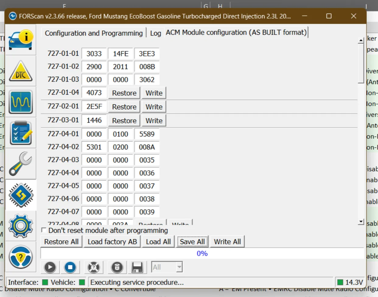

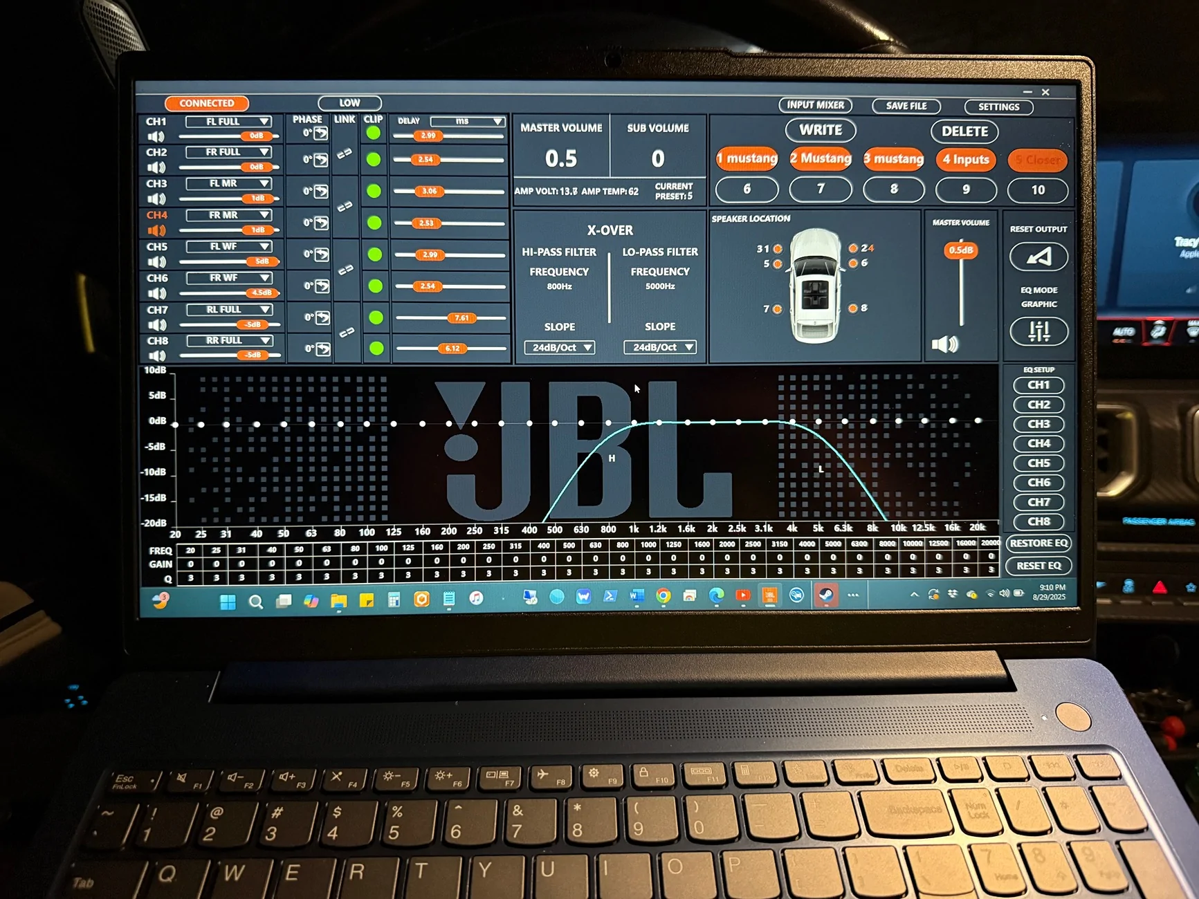

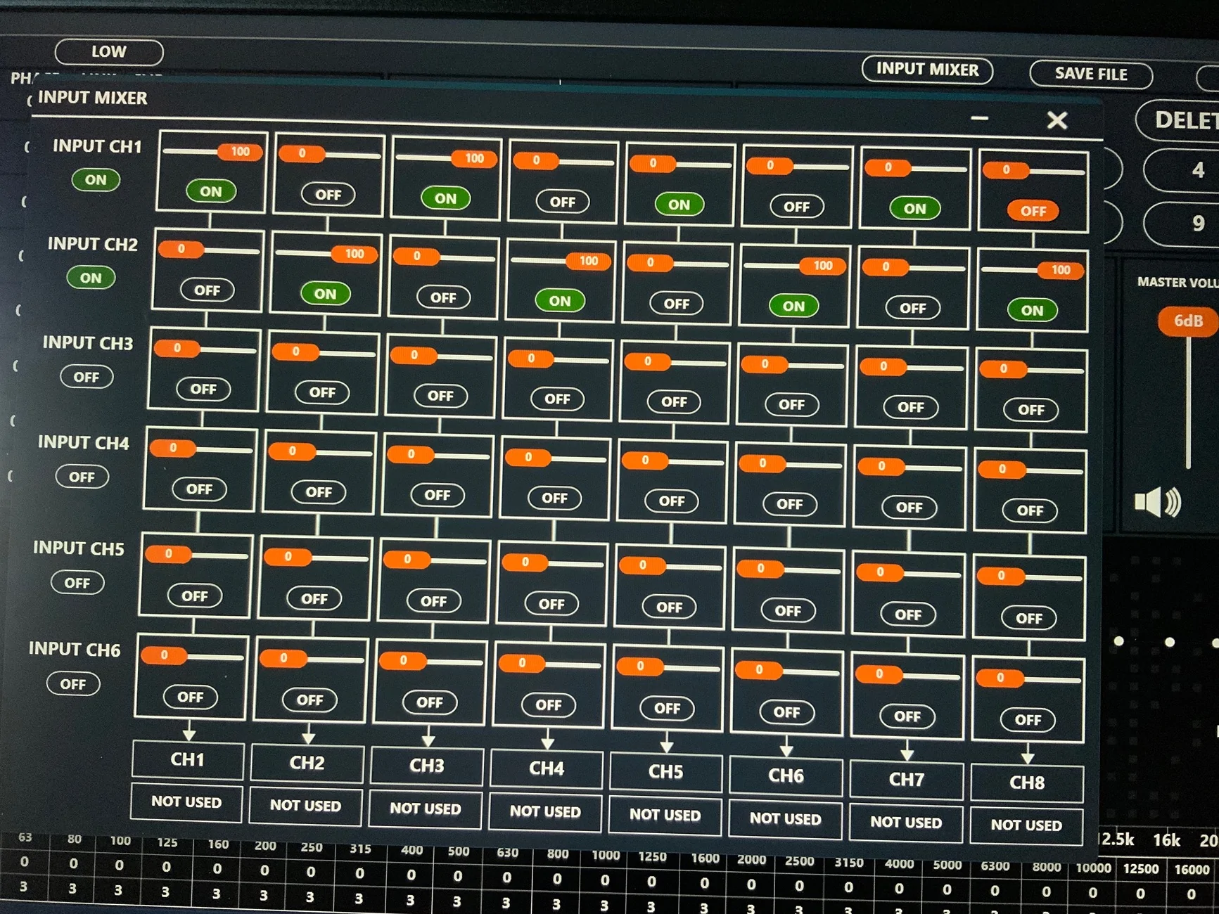

For the tune, you need a laptop.
you will want an ODB2 cable and forscan with a trial license to disable active noise cancellation (727-1-1, set the last three to 0EE3)
Use the USB cable to JBLs software to program the EQ. Be sure to set the input mixer to 2 channels only. The rear rcas are for the sub.
here are my settings.
