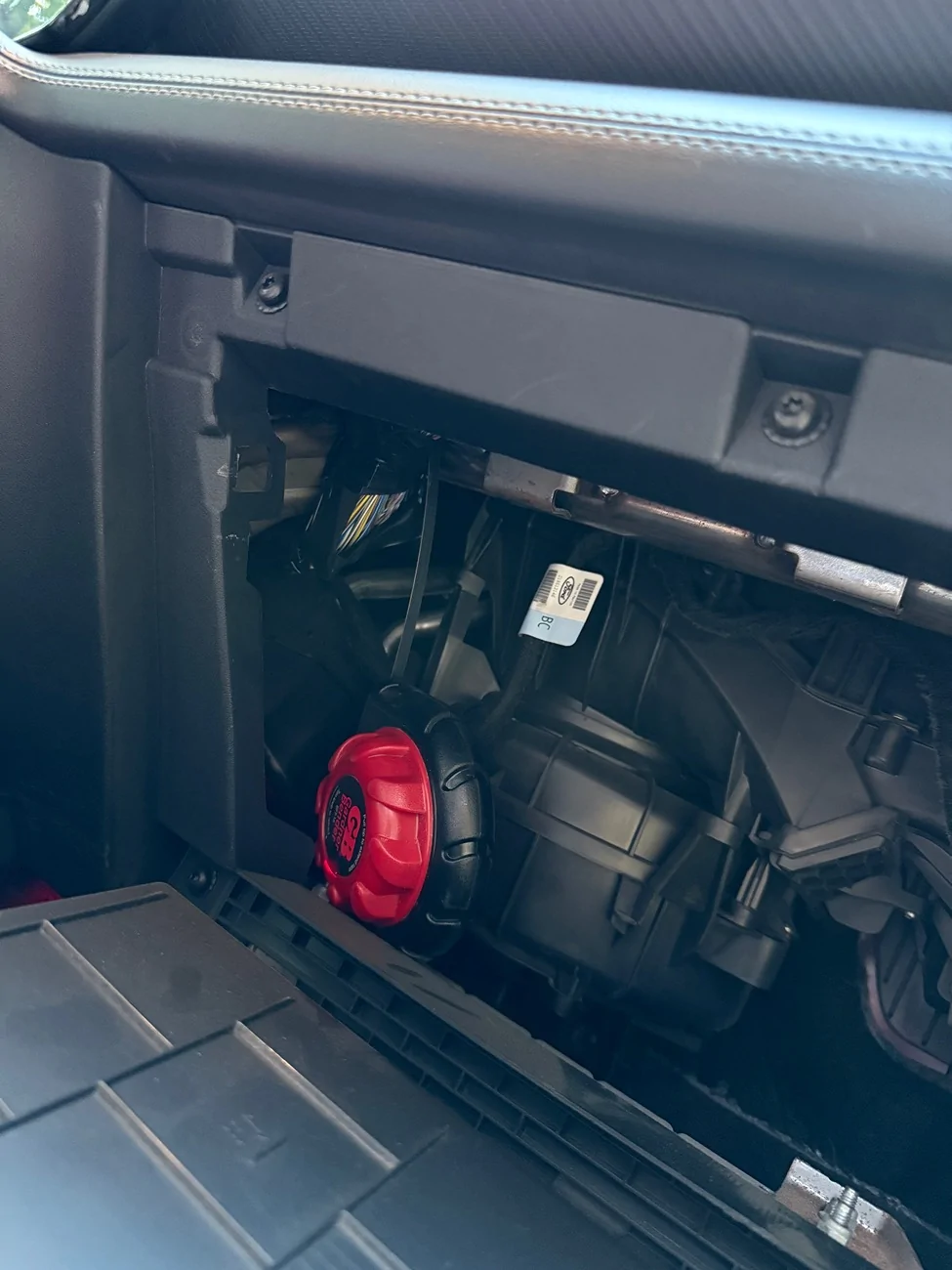

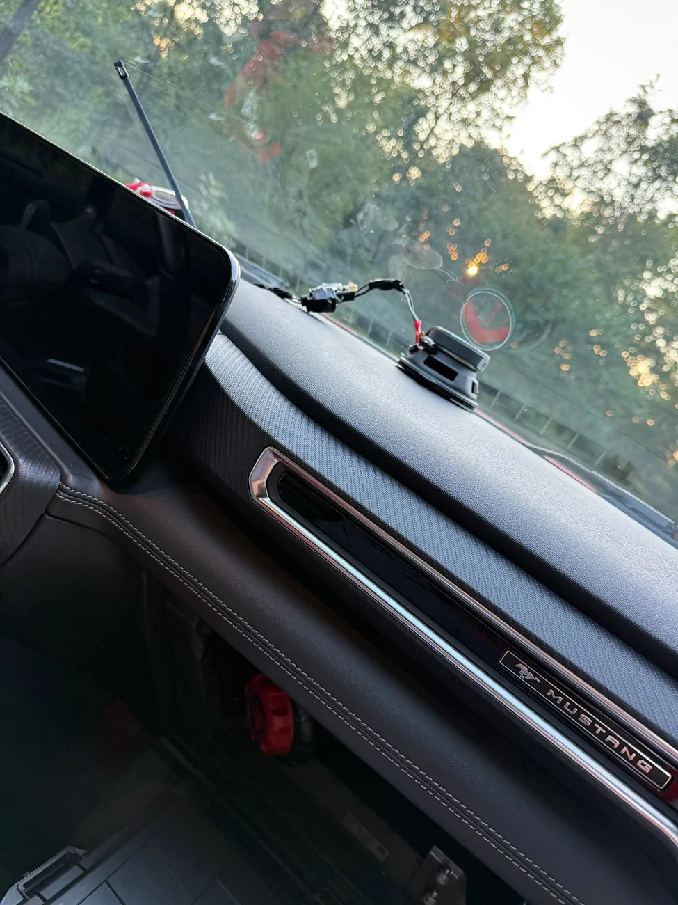

For those wondering, the path to wire the center is easiest from the glovebox.
Also note, that JBL cant handle a summed load and will shut down at higher volumes. So you will want a better/different amp if you intend to run the center.
