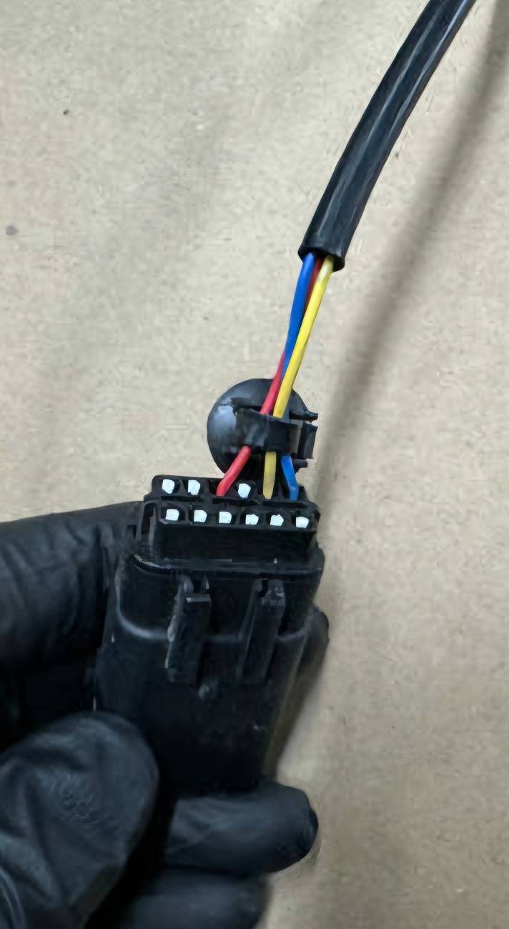

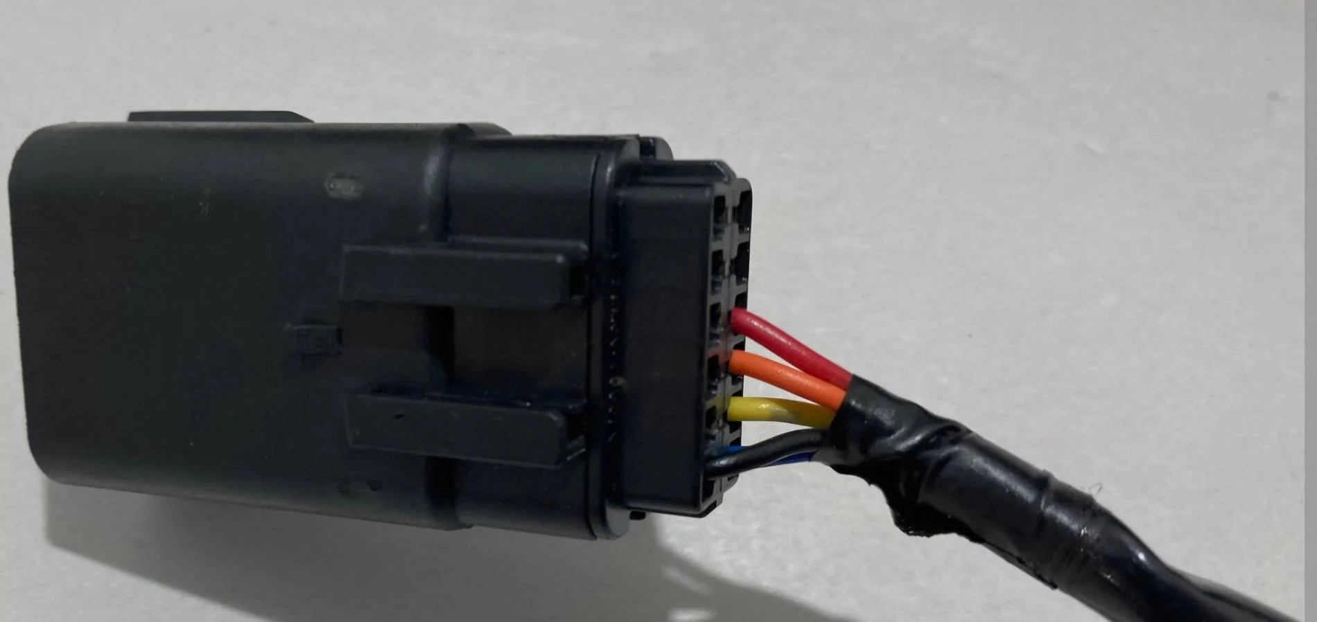

Thanks. Maybe the best thing to do is ask for a picture of the harness from the dealership or something to see if the wire is there.
I just looked up the harness from the S550 just as a reference to understand.
I know that the Premium S550 comes with turning signals and the base without it and I found these 2 connectors.
1 has 3 wires (Base Mustang) and 1 has 5 wires (Premium Mustang)

I have no idea what a mirror plug terminal 3 is.
On most (but not all) connectors, pin 1 ist numbered (very tiny) on the housing.
If you take a picture of your connector, it can be figured out.
Same for the BCM btw.
With this info (both pins there for each door) next step would be to measure electrical continuity between both, to confirm.
Looks like may be same plugs/pins used. Pins 1, 2 & 4 control mirror direction, 3 & 7 are turn signal + & - respectively. Time to pull the door panel and look...
Yeah that's the thing. I can't pull the door panel until I take the car with me to Europe in a couple of months. I'm on a small Island whit no dealerships and no worthy mechanic that knows about these cars.
