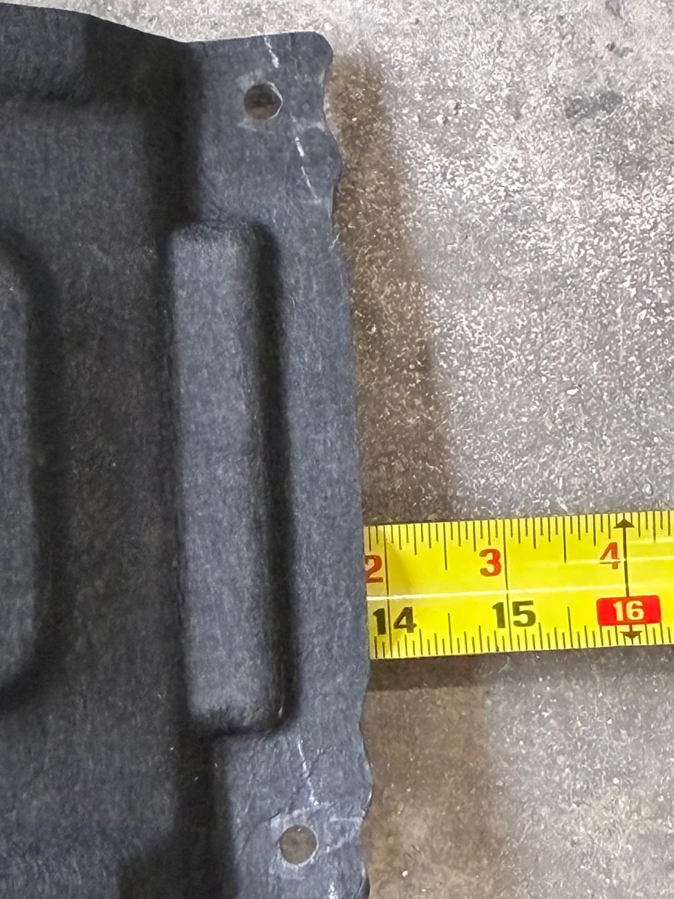

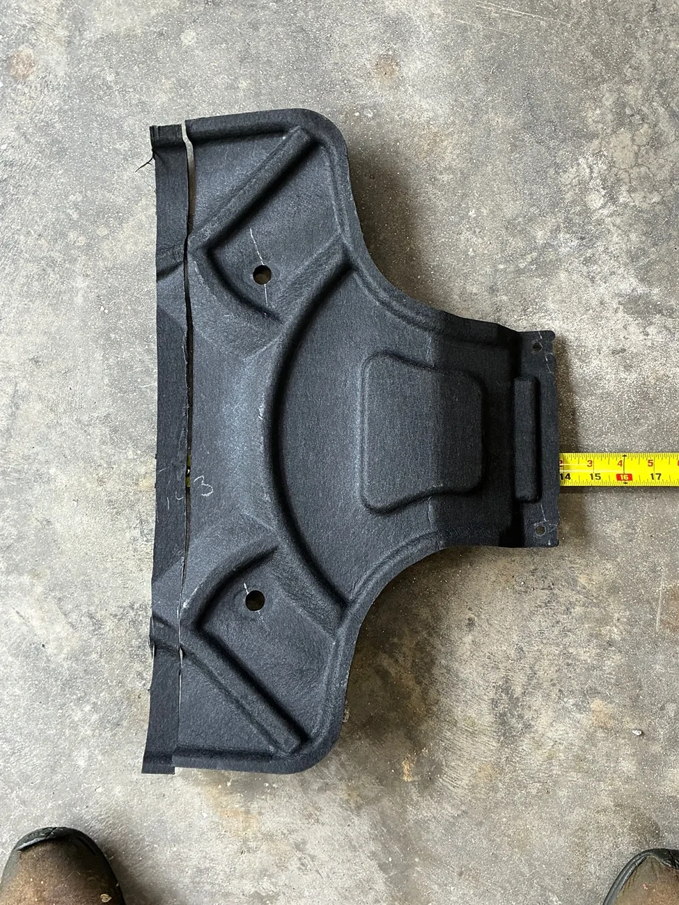

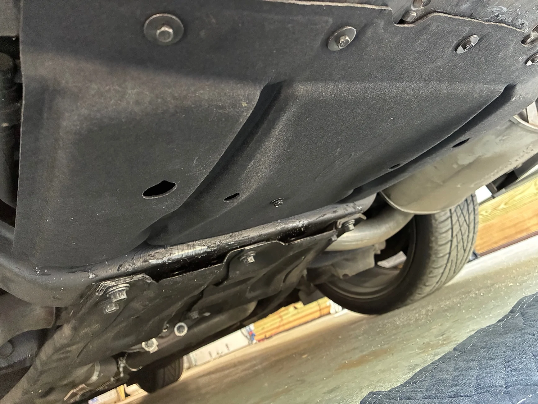

it appears this deflector doesn’t get installed by FOMOCO on convertibles because there are these frame brackets that are only used convertibles
So part # PR3Z6311778A is for coupes but can be cut down to use on a convertibles, see attached picture
any questions feel free to ask
